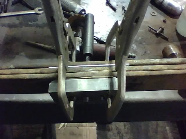

You didn't try to pull the spring pack together with the bolt did you?
Use a C-clamp, or a couple of vice grips to pull it together, and then tighten the bolt. The bolt is WAY to small to be expected to pull the spring pack together.

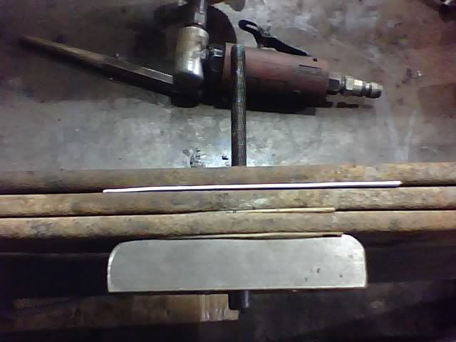

Assembled spring pack.
