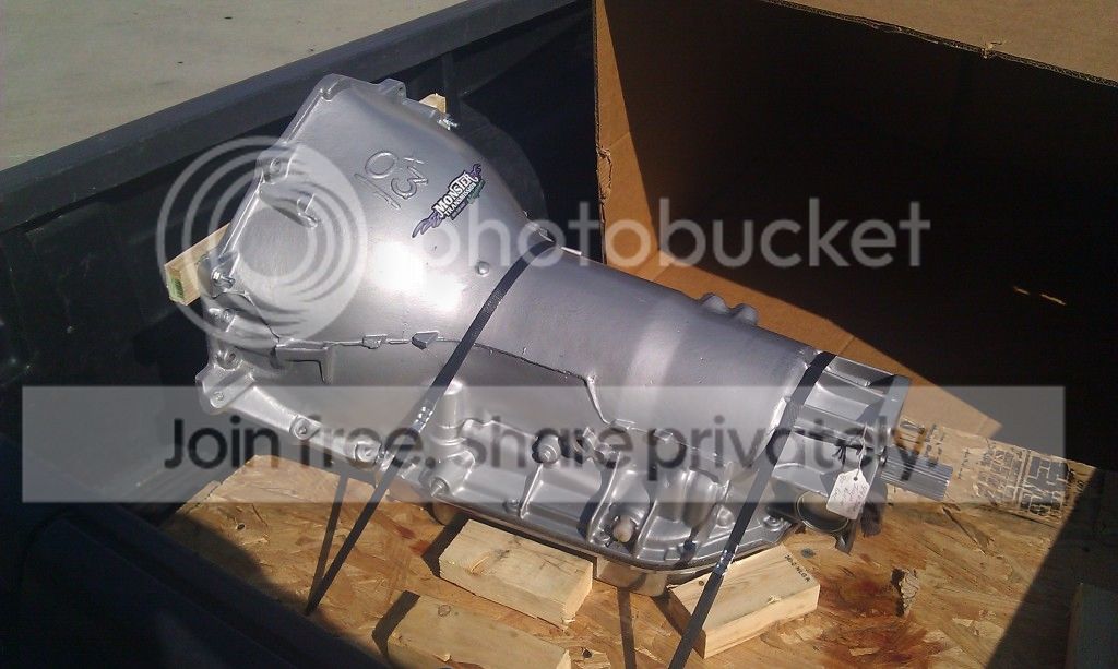

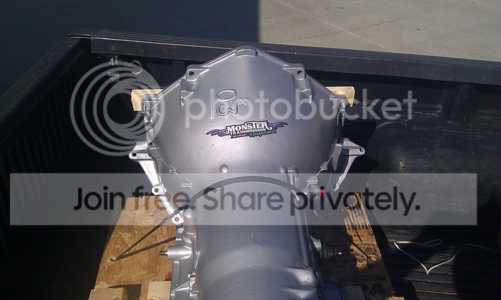

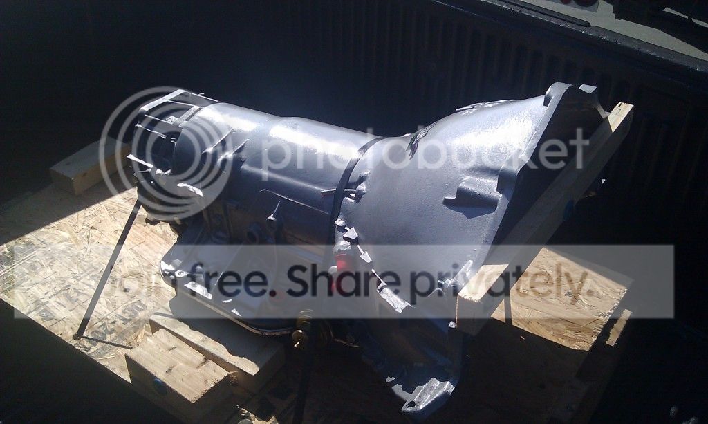

And after the successful road test-
Been awhile since I've been able to update this thread.....after 8 months of sitting with a dead transmission, it's finally alive again...woooohooooo!
We met the delivery truck at Lowes at about noon today. It's 12:30 here now. We were road testing at about 10:00. Went pretty good...and damn does this thing shift firm! :eek1: I love it! Supposed to be good for 500hp. :woot::woot::woot::woot:

What all does that have done to it? 34 element sprag? dual fed directs? rollerized rear bearing? Just curious what they consider good for 500 hp.

Not sure what all they do...Here's a link to the trans on the monster website-
http://www.monstertrans.com/store/products/Turbo-400-TH400-Heavy-Duty-Transmission-4WD-4x4.html

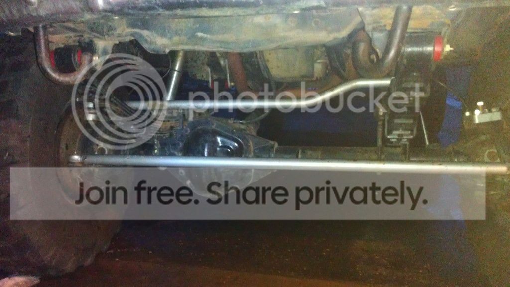

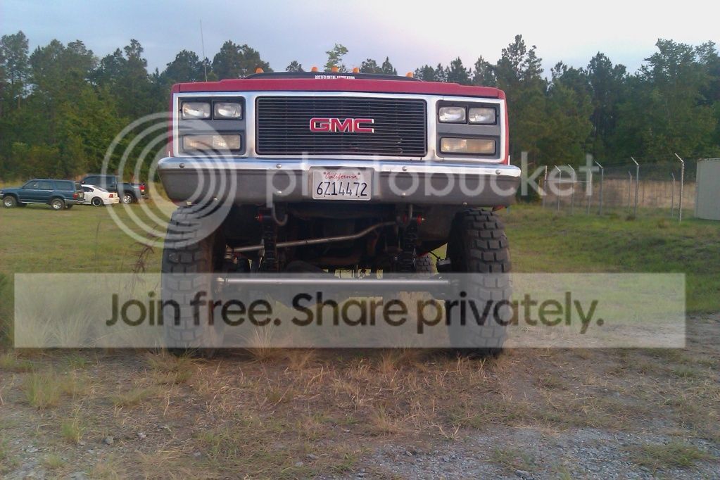

So driving around down at the Hammers was an interesting experience with the bump steer/death wobble I had going on. It was embarrassing actually. My truck gets a lot of attention in the first place, and with the tires wobbling around, it's even worse. The ORD pit tent was right next to the Lucas Oil/Figspeed tent, so I was able to just walk across the way to talk with Stephen about my problems. (By the way, thanks to Stephen and the ORD crew for helping me with my steering issues and helping us out with hub nut sockets and and other advice on the race car) Other than the standard stuff- making sure the wheel bearings and king pins were tight, he said he thought I just had cross over steering going on. IE bump steer and death wobble due to drag link angle being to steep. We talked about a couple different solutions- a block under the passenger side steering arm to get the geometry back where it should be, steering stabilizers, assist steering and possibly a panhard bar.

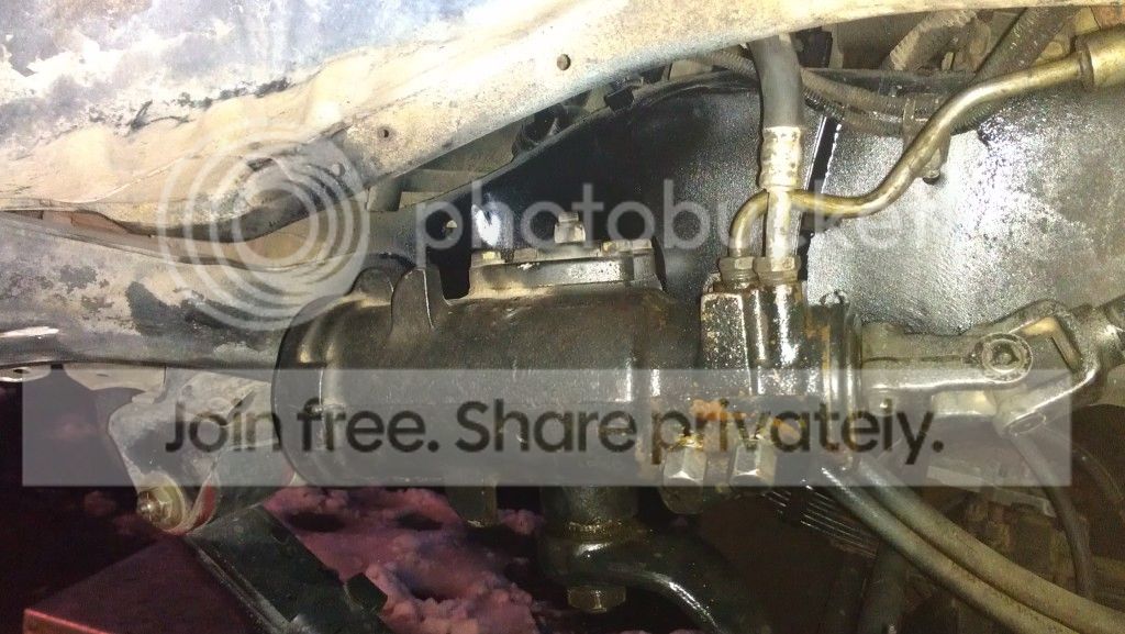

I finally got back home a couple days ago and decided to tackle one of the things I could do without really spending money on parts. I lowered the steering box about 4" on the frame. I was able to utilize the original lower forward mounting hole on the frame, the other three I had to build a mount for. My drag link is now perfectly parallel with the tie rod and the bump steer is about 90% gone. I'm sure the rest of it will be solved by a hydraulic assist ram.
As you can see, this wouldn't have been possible without the XJ steering shaft.
Went from this-
To this-
Much better.
