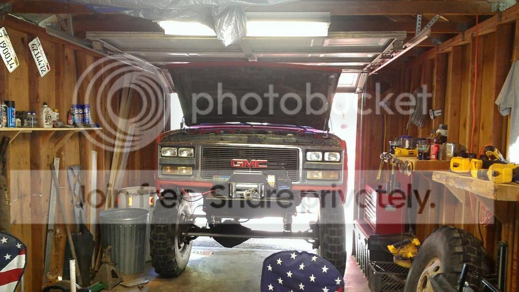

I finally got back home a couple days ago and decided to tackle one of the things I could do without really spending money on parts. I lowered the steering box about 4" on the frame. I was able to utilize the original lower forward mounting hole on the frame, the other three I had to build a mount for. My drag link is now perfectly parallel with the tie rod and the bump steer is about 90% gone. I'm sure the rest of it will be solved by a hydraulic assist ram.
With the box lowered like that, I think you'll need some major reinforcement of the frame around it, if you haven't done that already.
Think ORD:s frame brace x5
I wouldn't say that your drag link is parallell to the tie rod, just the last section of it.
It's the imaginary line from DLE to DLE that counts.
Not that it needs to be perfectly parallell on the other hand, you surely improved it.
Cool truck btw:waytogo:
ding ding ding.:waytogo:
How's the dropped steering box doing for you now that you've got a few miles on it? Any stress cracks, adverse handling, etc?
I'm considering doing the same thing but to clear my engine (I kept the crank centerline at the same point as the 454 that I pulled out). I can make it work with some mods otherwise, but dropping the steering box seems like a logical solution.
No adverse effect at all. No cracks, no worries. If you do it, just make sure you brace everything excessively. :D
