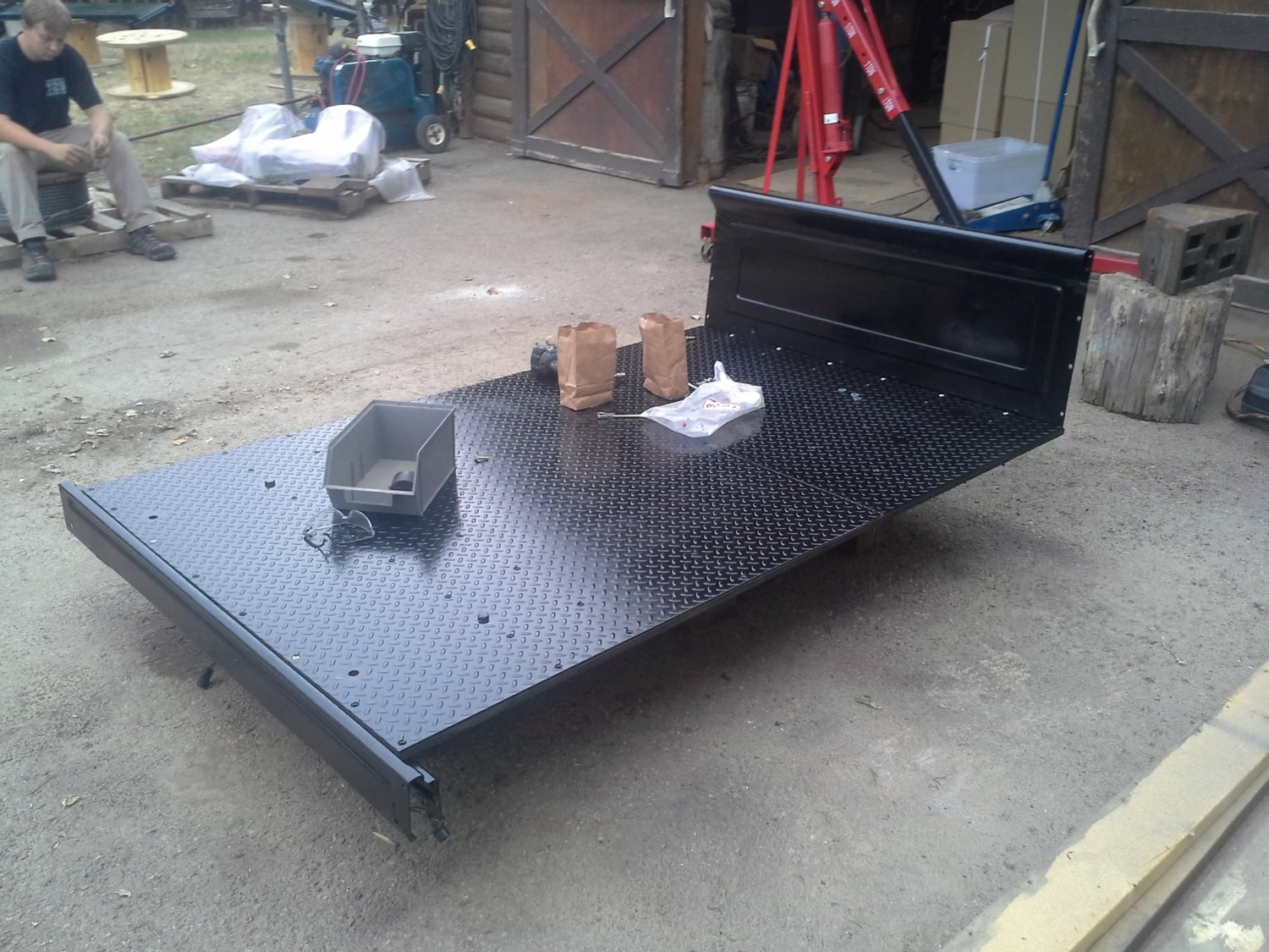

1980 stepside Diamond plate steel floor build
We counter sunk the holes for the floor braces and used 1/4" stainless counter sunk bolts. The floor is modular not welded to the braces
