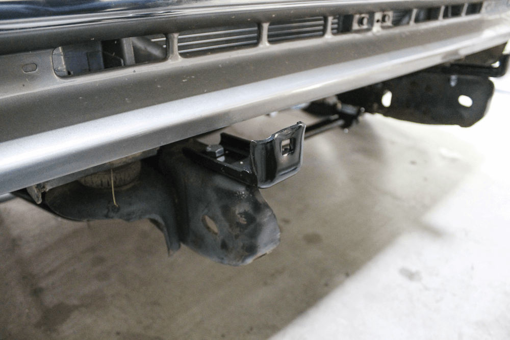

Well if anyone knows of some frame horns for sale, I definitely need some. Previous owner cut these horns and possibly lowered them to accommodate for a snow plow.
So now the bumper sits a good 2-3” too low.
