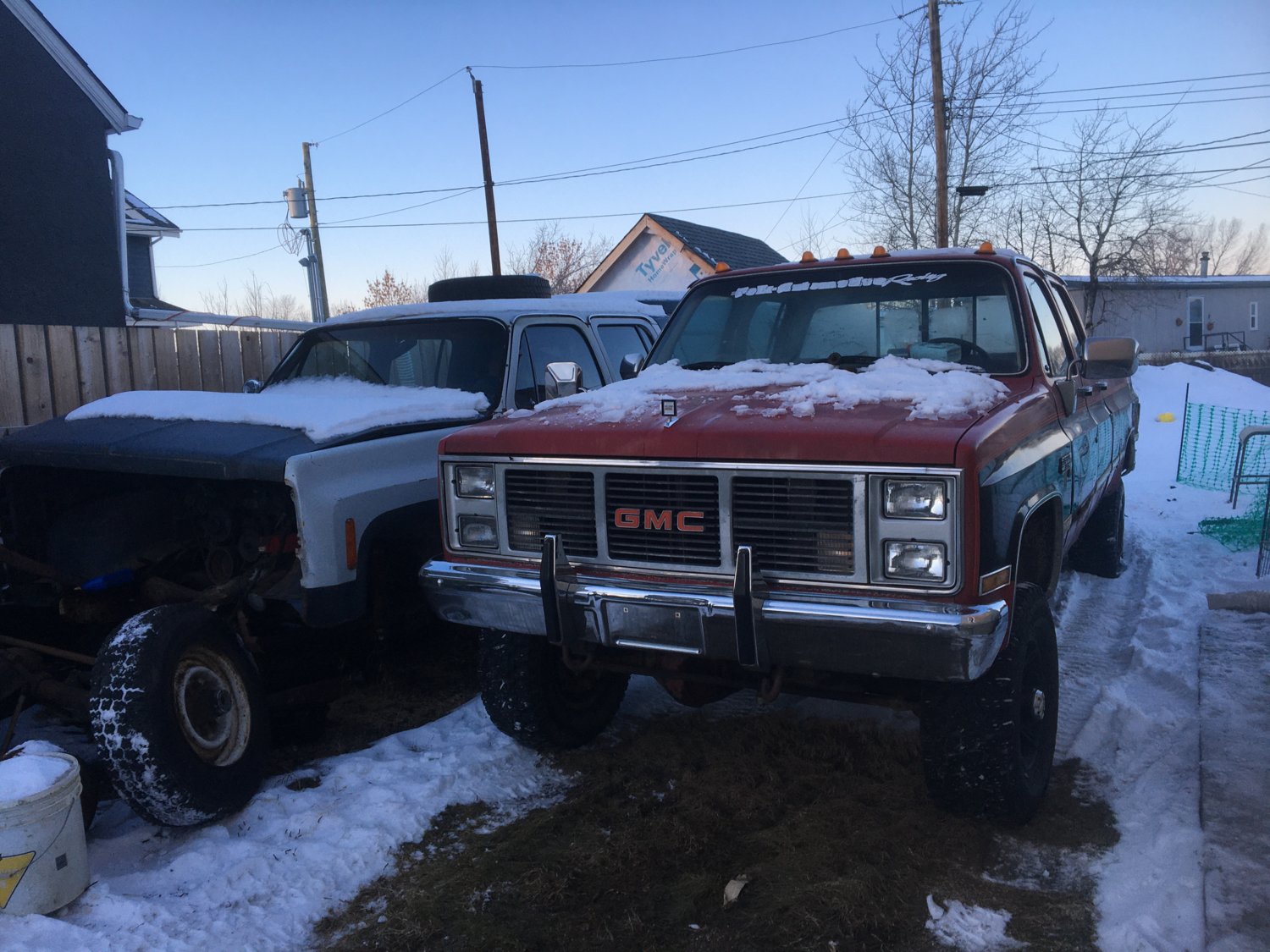

Hi all, I’ve got this build on a few forums but I’ve been reading a lot on here lately and I’d like to share my build and hopefully get some invaluable feedback from some of you guys. I’ve always loved the crew cab squares, but I’ve never daily driven one. I’ve had 1st and 2nd gen Dodges with the Cummins for daily drivers all my life. I put a 12 valve into a crew when I was in high school but I didn’t have the money or experience to do it properly, and it was a death trap. So I scrapped it.
Fast forward several years, I’m fortunate enough to own 2 crew cabs. As well as a handful of Dodges and a Landcruiser. This thread will focus on the transformation of my 1986 Sierra Classic K30, although my 1979 base model Chevy K30 will get some attention as well.

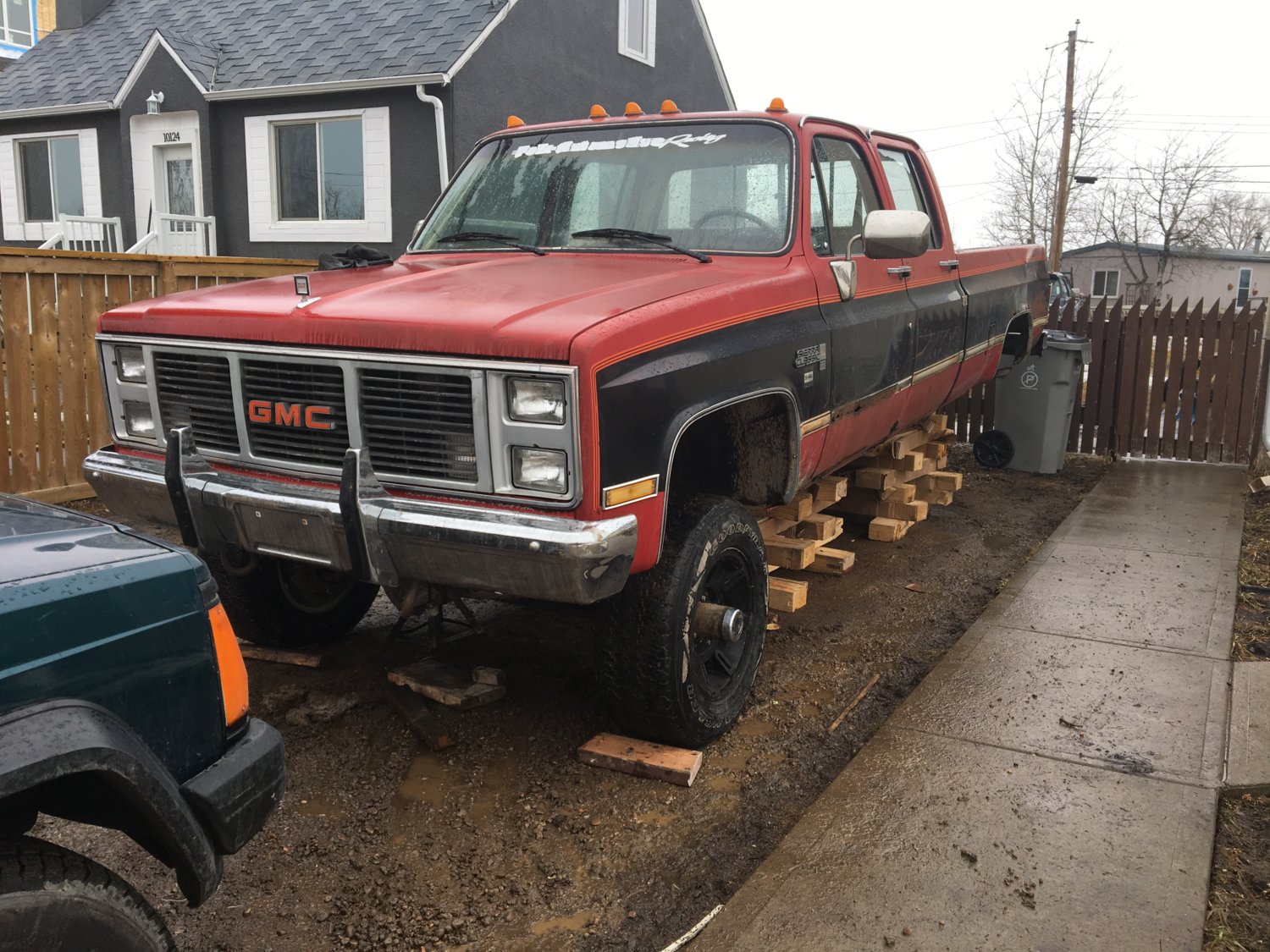

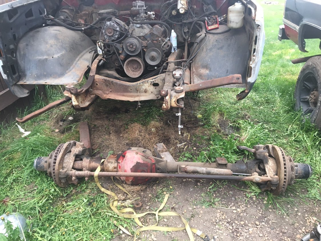

I was looking for a 6.2 Diesel engine several months ago for my ‘79, and someone contacted me that their brother was parting out a truck with one. He sent me a picture. It was a 4x4 Sierra Classic crew cab, factory 6.2 4 speed, body was a little rough but it ran and drove. The guy just wanted the axles and he was going to scrap the rest. I asked if he’d pull the axles in my driveway and leave the rest of the truck, thankfully he agreed. We blocked it up and pulled the axles and I had me a truck! Well, most of it
I easily found a 14 bolt rear and had this thing rolling again. However, I didn't realize that the Dana 60 was all piled up and the knuckles wouldn't turn, so I could only drive straight forward and back. I pulled it out and looked to borrow the GM 60 from my other crew cab
Obviously it worked a lot better and I was able to get the thing mobile. Mechanically it was sound, the truck has 220,xxx km on it and it ran and drove just fine
So I suppose here would be the proper time to outline my goals for this build. As stated earlier, I want to put a 12 valve into this guy. I realize that's pretty boring and well documented, but I understand them inside and out, and I want simplicity and reliability with reasonable power and fuel economy. And nothing meets those criteria like a 12 valve. I want the truck for a daily driver, mild off road and camping, and it will semi frequently pull a car hauler with 6 to 8000 pounds on it. For heavier towing and dirty work I have a First Gen Cummins dually that's tougher than nails.
This truck has the Sierra Classic trim level so it has power doors and windows, AC, cruise and all that fun stuff. And it all works

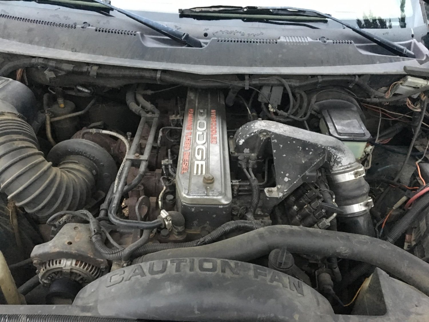

Several months ago I picked up the truck that was to be the donor for this project. It was a steal of a price, at the time I needed cash and was going to make the necessary repairs on it and flip it, but I realized I would never find another 12 valve engine, much less a whole truck, for the price I paid again. The truck has 400,000 ish km on it, but the engine has less than 100,000. Its incredibly clean and healthy. It will get pulled and resealed in the spring, I want to clean it up and paint it with the Cummins Industrial Tan. I really like that color on these engines and it will make diagnosing future leaks a breeze (as it will most definitely leak in the future)

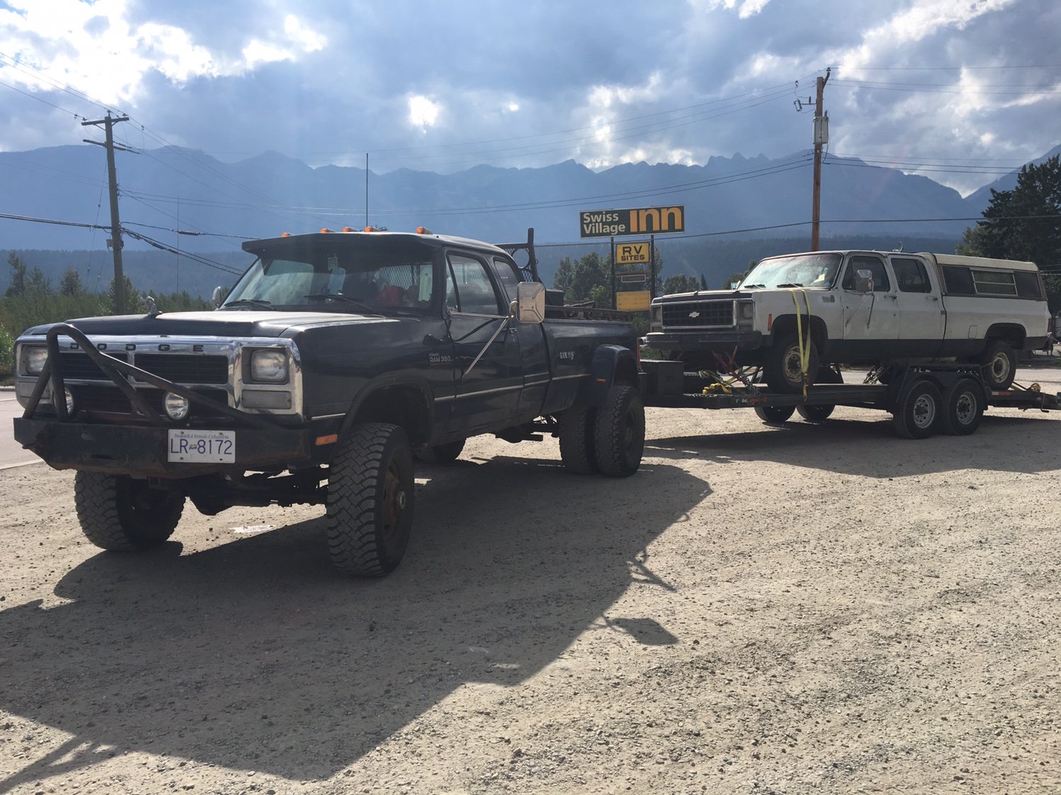

A little side track, I also have a '79 Chevy custom that I bought a few years back that was going to originally be my build project. I was living in Alberta at the time and drove all the way to Langly, BC for it. It's not in great shape but the panels are mostly clean and straight, and I like the round eye look. It has a 305 on propane that doesn't run. This truck has been following me around the last 3 years, getting towed here and there as I moved it around. So the new plan is to give it the 6.2/465 combo from the GMC and then fix it up and make it road worthy. Will likely sell it in the future, but for now it's in my back yard doing a bang up job of storing parts and panels.
Here it is in Golden, BC, hitching a ride through the Rockies on my daily driver of 6 years. The dually has it's own build thread on another forum, it's had quite the journey itself

My work takes me away from home a lot, and I was over in Europe for 4 months most recently. I hired some contractors to build a garage in my backyard, but there were some complications and I was left with a snow covered foundation. This and last week has been so bloody cold up here it's not even worth working outside when you don't have to, so the two crews are sitting side by side in the backyard waiting for attention. I'm off again end of January for another 2 months, so I'll be ordering swap parts from afar and making a stockpile so I can fly at it when I get back
