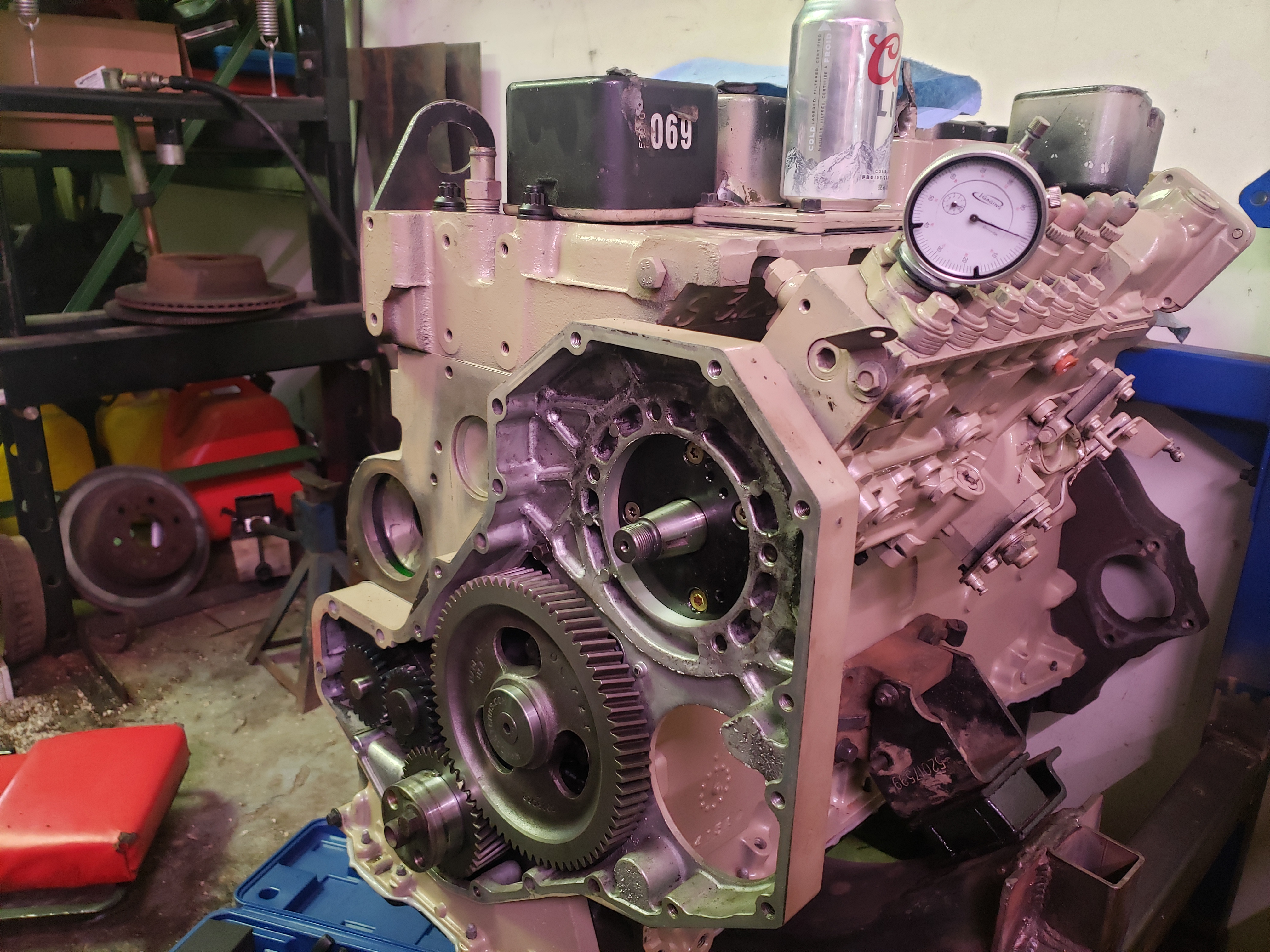

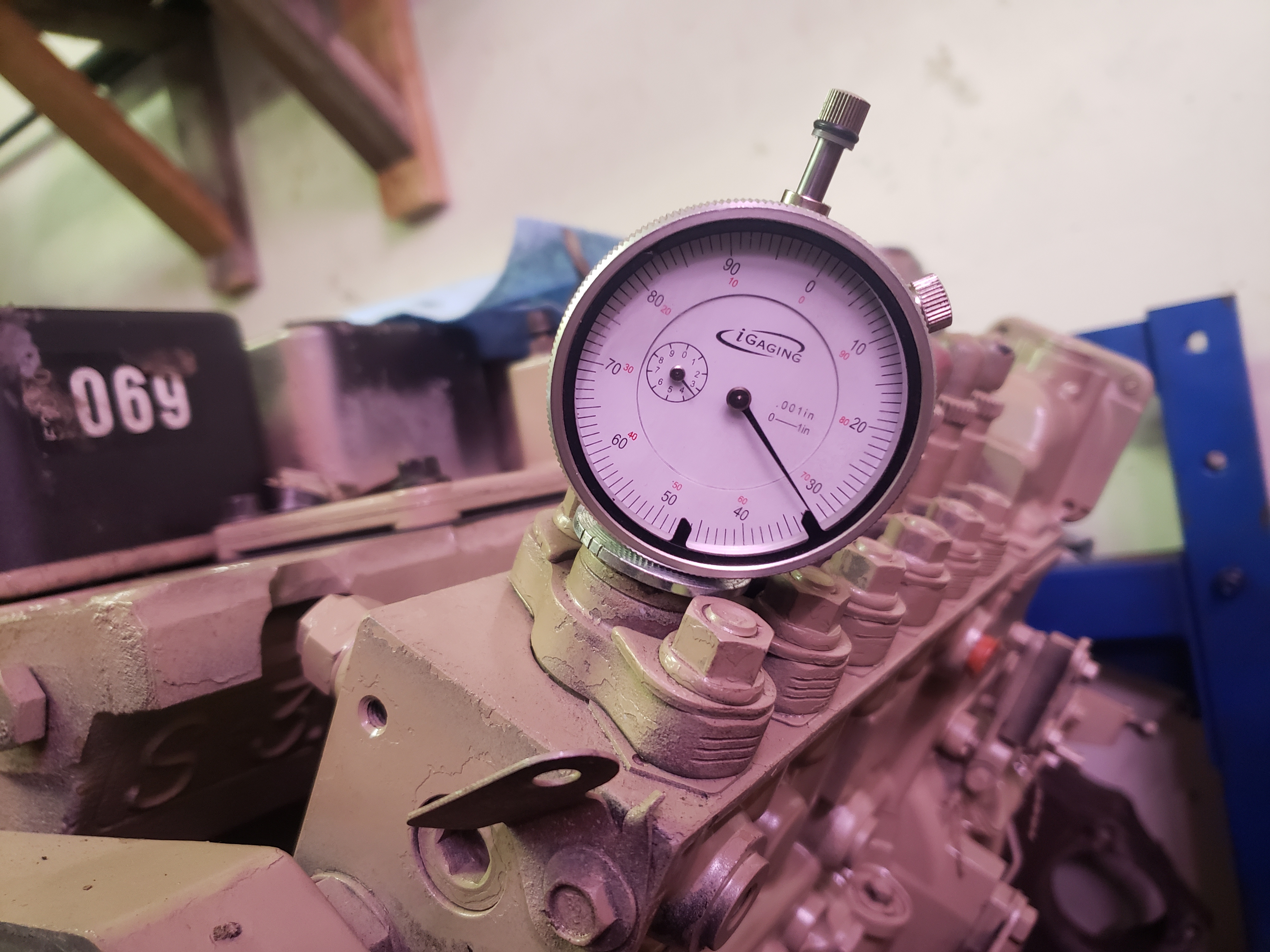

Been putting off the pretty important task of timing the pump lately, so today I jumped in on that. This task is way easier with the engine on a stand. Used the special socket to pull the first 2 delivery valves on the injection pump, and timed it using a homemade dial indicator adaptor. If anyone ever needs to do this, a Cummins oil pan plug is the same thread as the delivery valves. I drilled hole through it wide enough to fit the body of the indicator, and drilled and tapped a small hole for a set screw. Works great, and saves 70 or 80 bucks
Took me a while to find all the specs for base timing for this pump, the engine data plate has info for wrong year and size of injection pump. So I ended up using the Bosch timing chart to set it from no lift. Decided on a conservative 18 degrees of advance, with the lash in the gears it's probably closer to 18.5 or 19. Translated to roughly 232 thousandths of an inch barrel lift

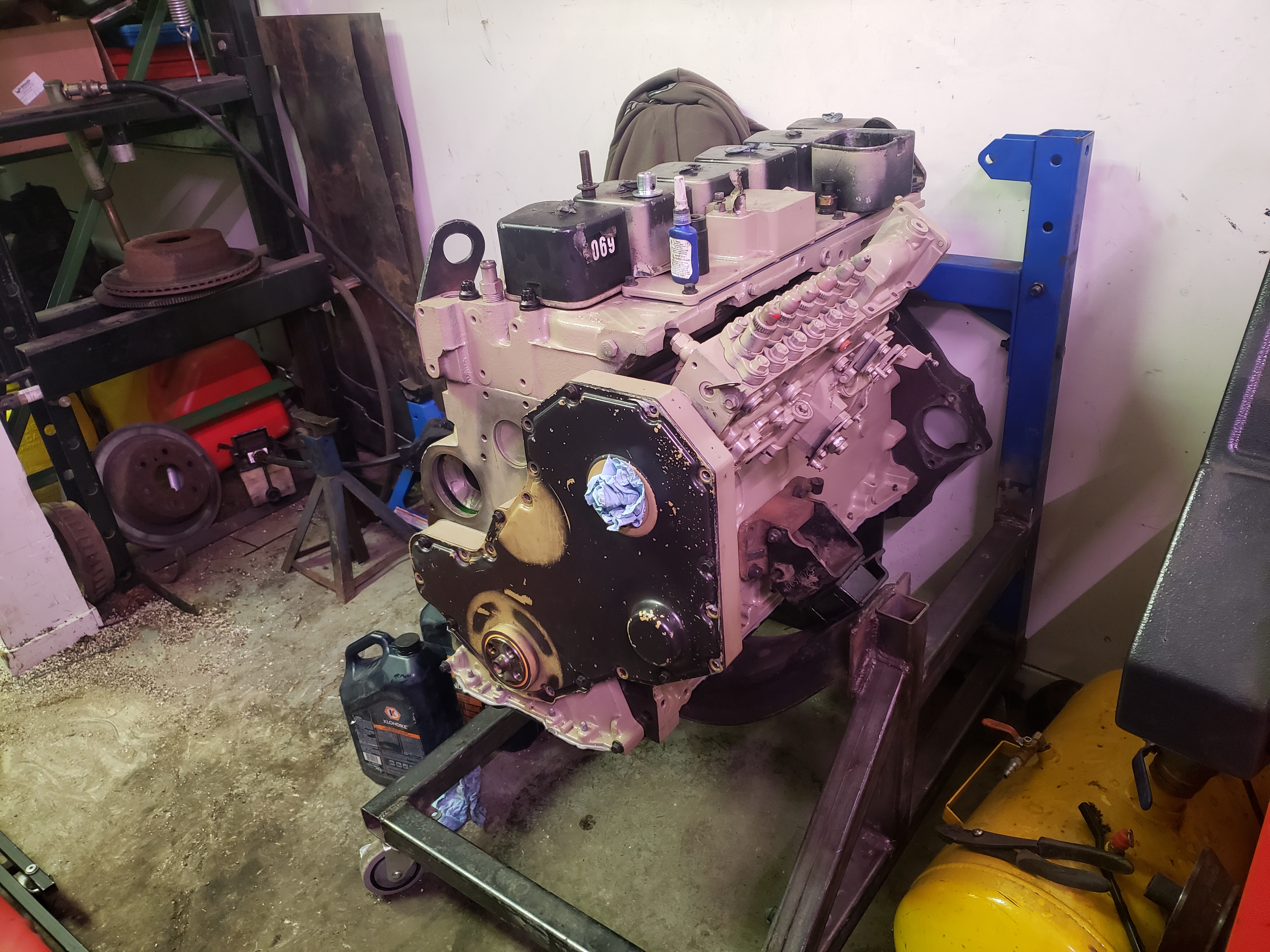

While I had the cover off, I addressed the dowel pin that likes to fall out and grenade the gear train. No need for fancy expensive kits, a few smacks with a hammer and punch and that pin isn't going anywhere

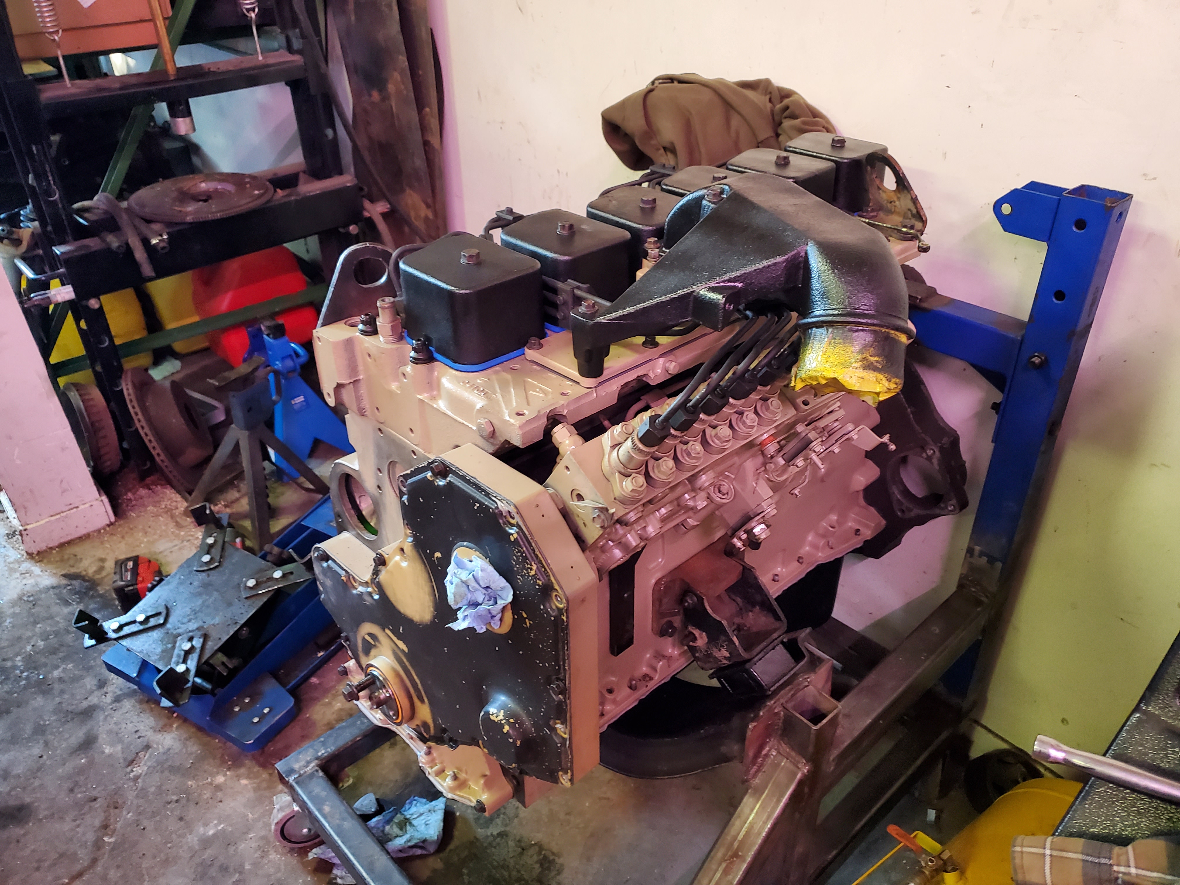

Finally got the front cover cleaned up, front main installed and cover sealed to engine. Had a hell of a time getting the seal in, and It is almost definitely going to leak, but it'll do long enough to do the cam break in, and I can replace it before I drop it into the truck. I want to install a speey sleeve, anyway
Other than that, I finally started throwing some money at this thing. Ordered a set of 5x.014 SAC injectors from DFI, a high mount AC bracket from Adventure Vehicles Northwest, and will likely have a turbo and manifold coming early next week. Decided against the ATS 3 piece manifold, as I read lots about them cracking. Going for a Steed manifold with a T4 flange. Also still working on turbo selection, basically narrowed it down to an S362 or 364, should compliment the injectors nicely to get a decent 450 to 500 horse. That's all for today, hopefully tomorrow I can get the headstuds to their final torque, and clean up and install the valve covers

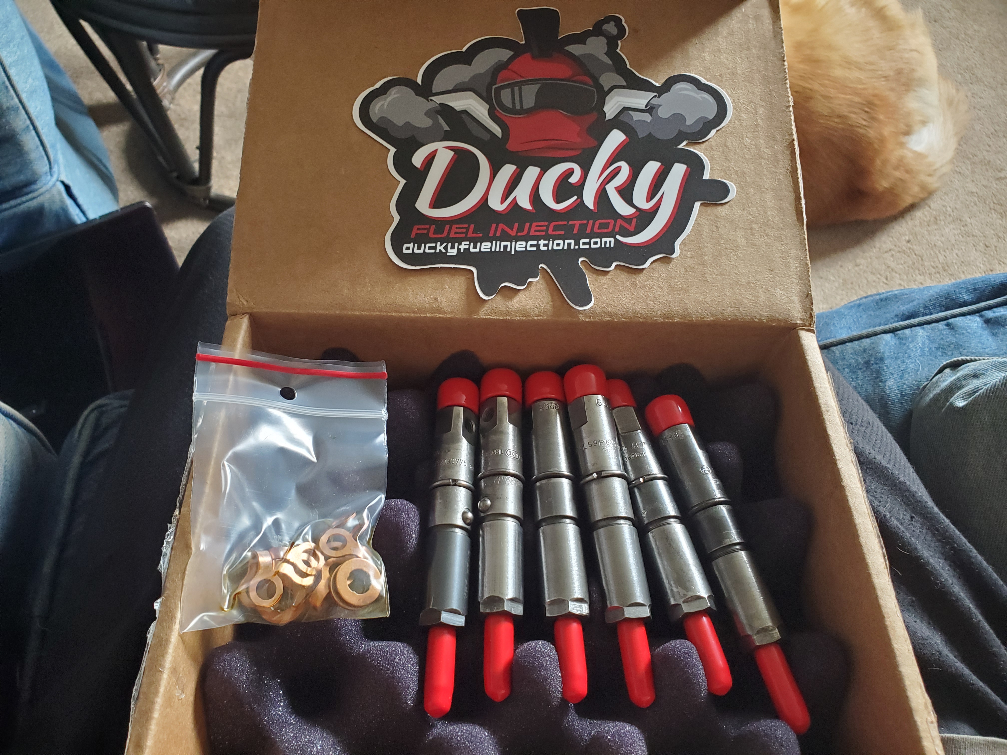

New injectors showed up the other day

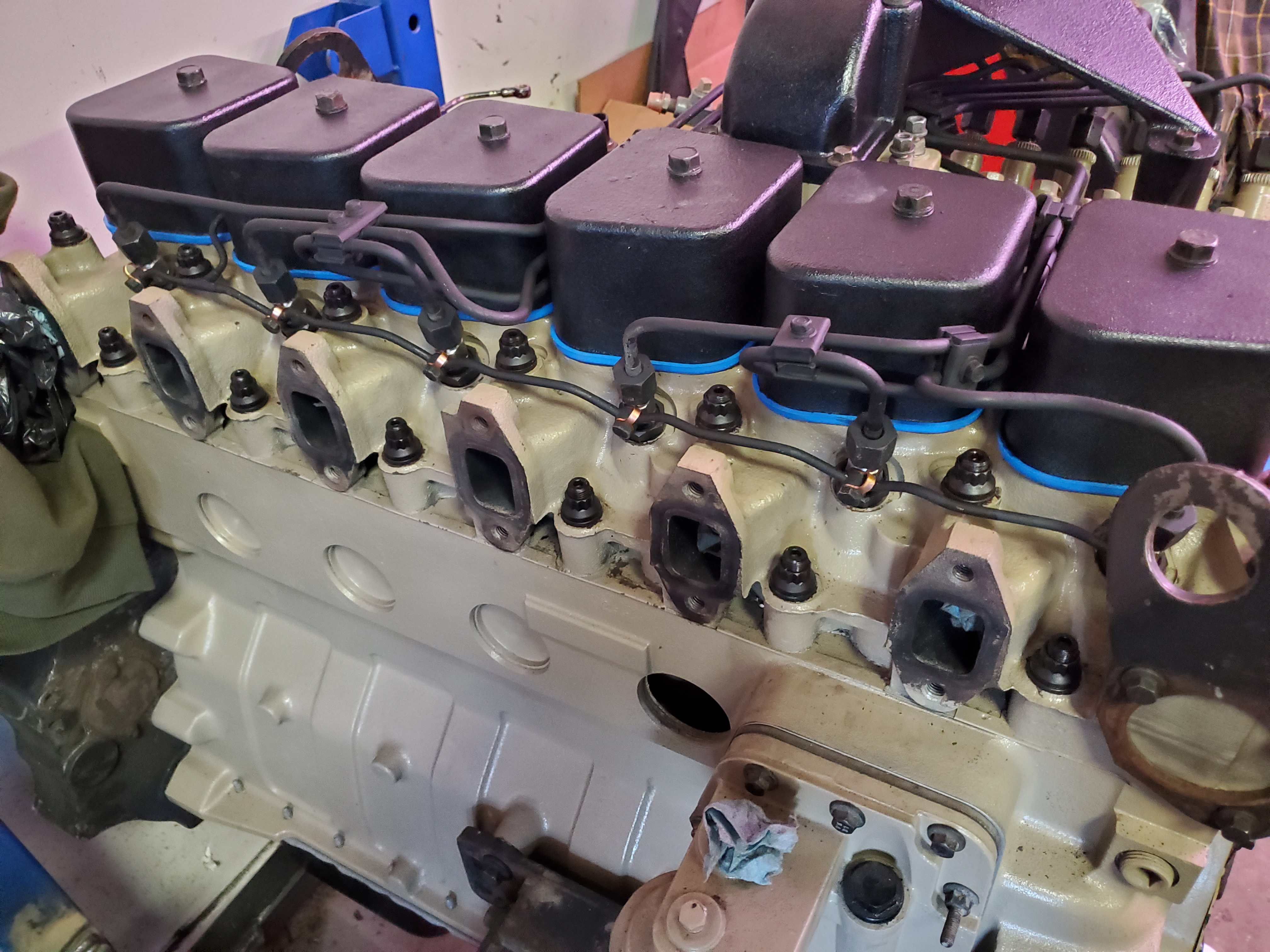

Still hoping to have this thing started before the end of the month, so I got the injectors, feed and return lines installed, and cleaned up and installed the valve covers

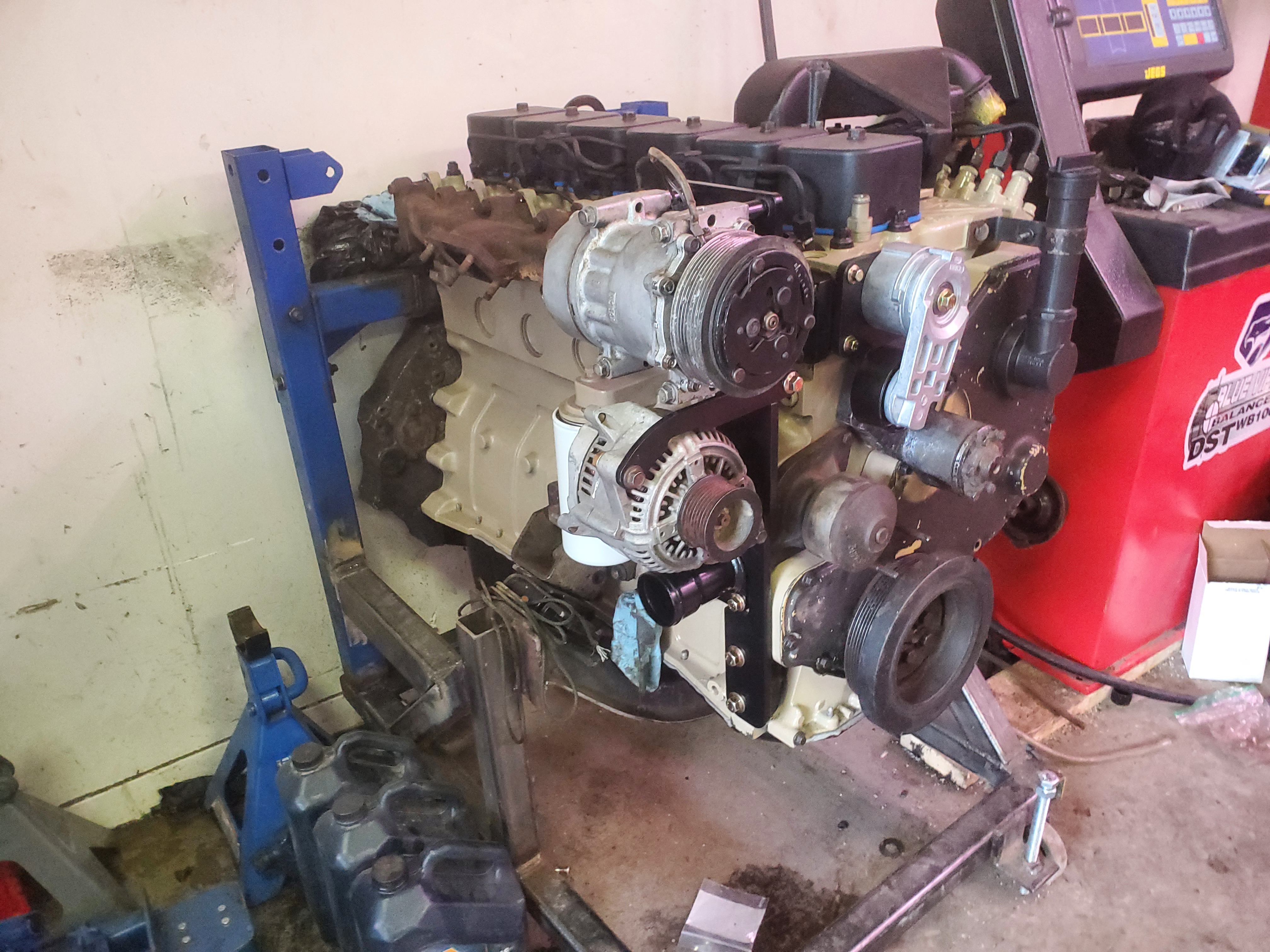

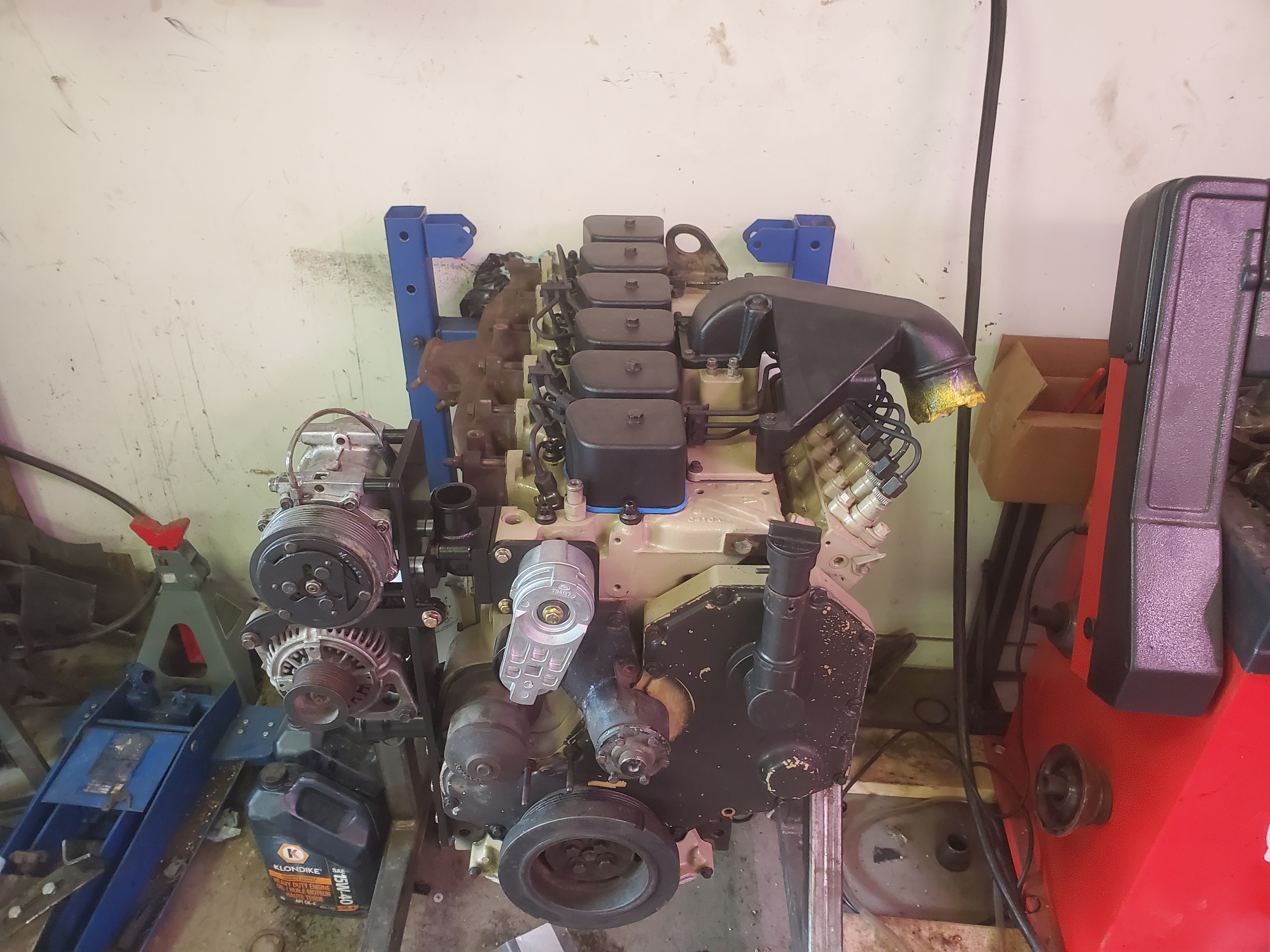

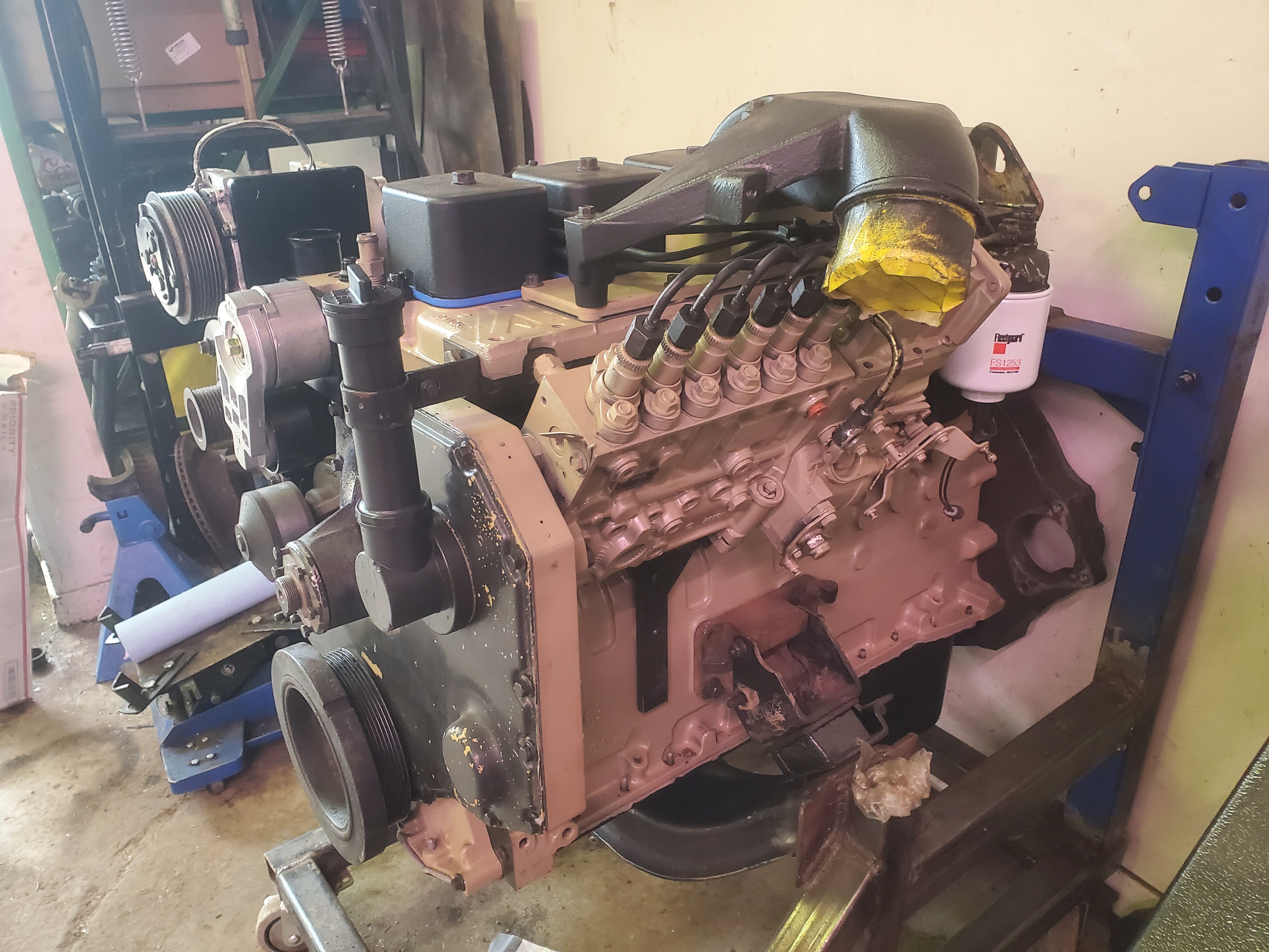

The high mount AC components finally showed up, and I was able to knock that out today and put lots of the accessories back on. The kit came from Adventure Vehicles Northwest, and it seems to be a quality product. Great customer service, too. Installed the old exhaust manifold, just going to use it for a break in, hopefully a new one will be on it before it goes into the truck
Also spun on a new oil filter, and put the fuel filter head on, along with a new filter
Installed the new tensioner on a relocate plate that came with the kit, the harmonic balancer, and the water pump and fan hub. The balancer is also just a place holder, I plan to put on a fluid damper when funds allow.
