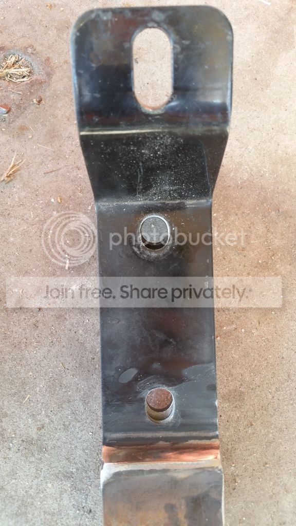

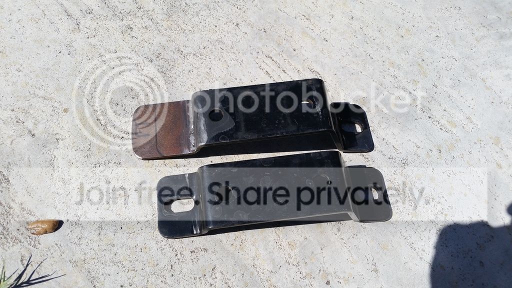

Still fixing the front sway bar. CPP frame mounts don't put the sway bar rearward enough, so I oblong the holes and extended one side. (the original slotted holes didn't do anything as the bolts were both farthest out) Doing these couple things net me about 3/4" more rearward and helped line the links up perfect.

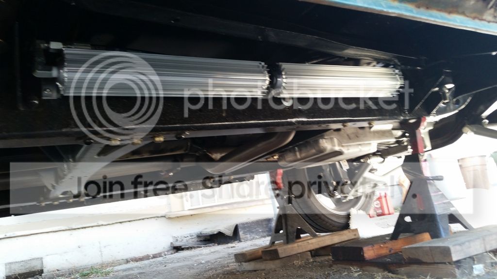

Also pulled the trans cooler lines off the radiator. Managed to mount the most heatsink cooler combo between the cab mounts on the frame. Here's hoping this helps with trans temps. I'm no longer using the radiator. I saw 225* temps during a very hot day recently, just in traffic.
