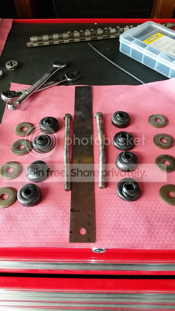

check out the bent link bolts and smashed rubber, all less than 1,000 miles of use. Not to keep harping on CPP, luckily they are ~40 min drive away and I can exchange this stuff, but how much more of these problems will I find? I'm already turning in the front wheel bearings and races.

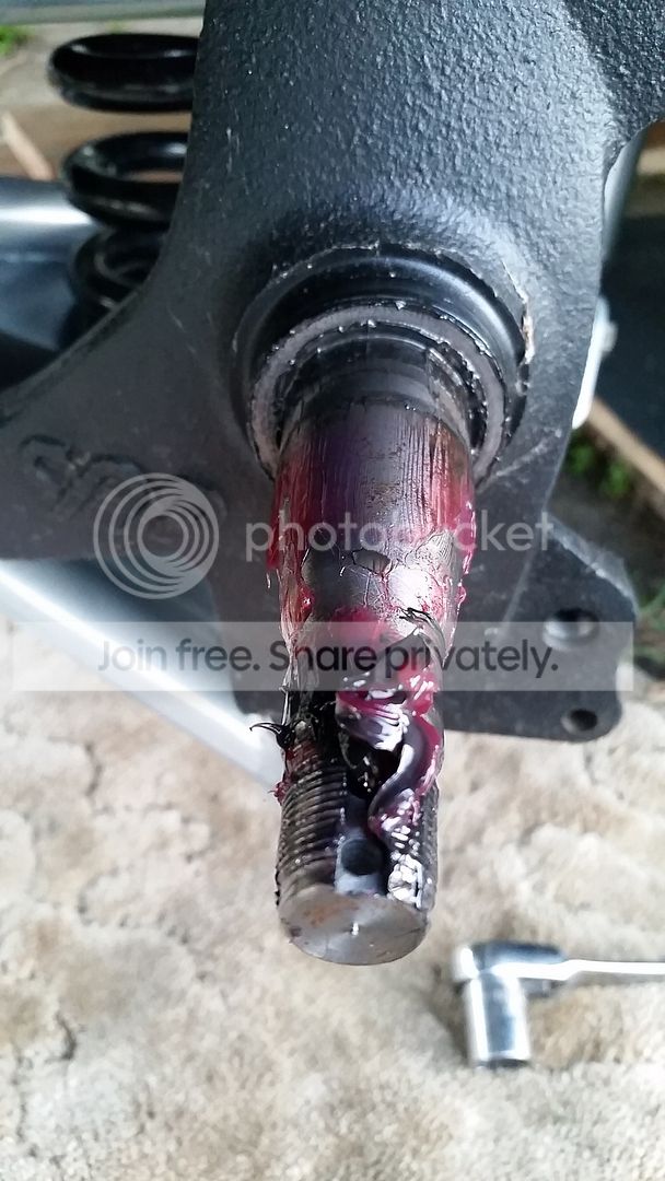

Also, why is my wheel bearing grease black? Inner and outer on both sides. It's only got ~900miles. Cause it's all new parts? Dunno :(

I wouldn't worry too much about the grease unless the spindle looks like it's being ground on or its discolored.

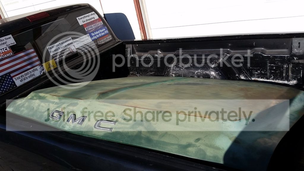

On a good note, I picked up a new hood to replace my damaged one. This new hood is absolutely beautiful. It is dead straight on top (better than my other one). This time I will be filling in the holes for the lettering, good thing this came off a GMC so there's less holes!!! Not bad for $120. For now, I'll pull the letters, sand it down some, and spray some gray paint on it. It wont match the primer of the front end up it's better than green. Or.... should I leave it green? LOL That would make 6 total colors for the truck hahahaha

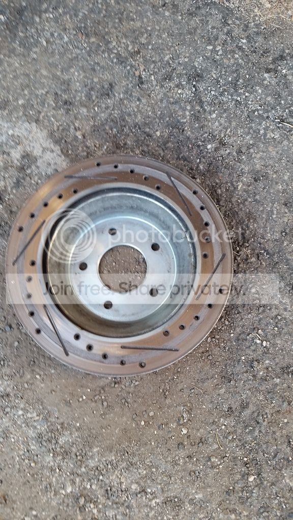

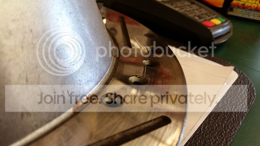

So check these rear rotors out. 930 miles of use. This is the good side, not the wobbly side. :(
bummer man. Just had to replace the warped rotors on my car.
That's a steal for a hood in that kind of shape. Nice find!
