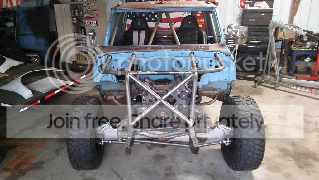

Then onto truck. Got my engine cage as far as I can for now until I get shocks mounted. So motor is going to come out probably next weekend so it can head to the machine shop for a freshing up.
Then today i spent alot of time today fixing something that has been bugging me since i did it. This dead node in my back half. Hate using my time to redo work i have already done, but this had to be done. Much happier with it now.
