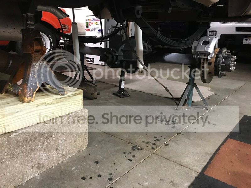

Careful using cinder block under jack stands. I had some disintegrate on me before. :eek1: Luckily I wasn't under the truck when it happened, but it was scary as hell.
Especially in that orientation! Should flip it 90
degrees so the hollow part is vertical. Then put some plywood on top so it's not point loaded on an edge.
I've seen guys fill the block with quickrete and then tap on plywood down to the top for the stands to bite into. When I did it I just cut a couple of 4x4s down and used it as cribbing to build a stand off high enough.
Wow I've never even considered the fact they could give out. Used them many many times and never had a problem. I'll flip it and throw a piece of plywood on top of it. Thanks guys
No worries man. Obviously I did it a bunch too, until it failed. Afterwards I found out it is common. I think the plywood will solve the problem. :waytogo:

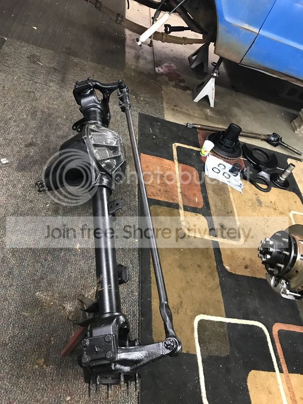

There in the backround you can see the front axle also.
Dana 60 GM kingpin front. 4:10 gears. Came with a Detroit locker that has not been installed yet.

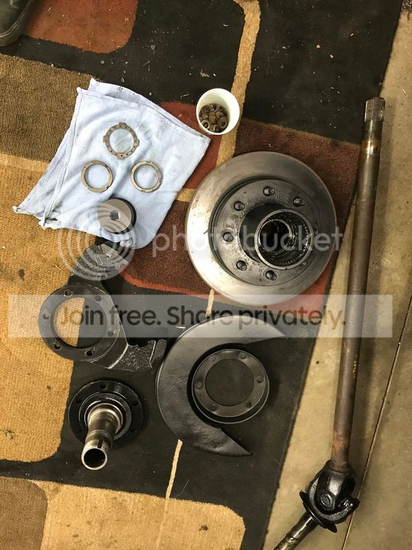

Well been messing with cleaning up the front axle, pulled hubs, blasted brackets and a few parts, finished with some black paint, and finally putting new calipers on. I'll post pictures once it's all together.

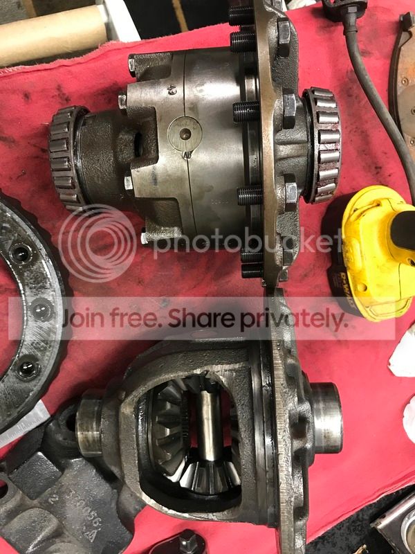

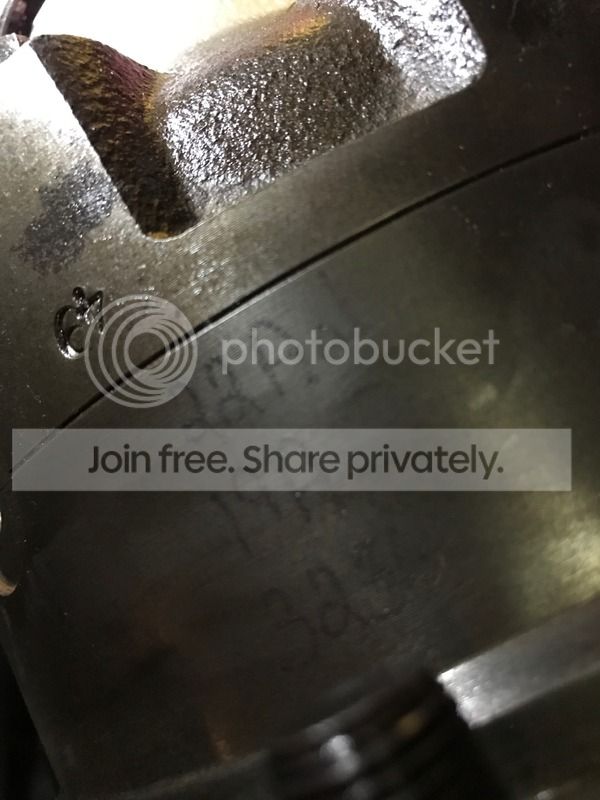

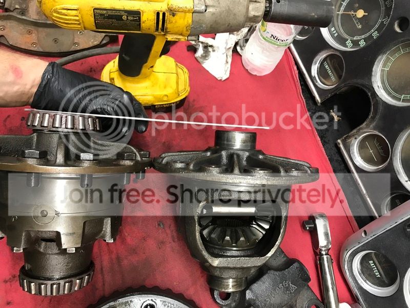

Was working on installing the Detroit in the Dana 60. Swapped the ring gear, bearings, shims and everything to the Detroit. Attempted install and seems like it's not going to fit. I have the wrong Detroit???..... I have 4:10s, part numbers on the locker are engraved 22A which is a part of the 225SL29A. Where as the part number for 4:10 down is 225SL29B. Even looking at them the Detroit looks offset.
Here's a few pictures
Here you can see that the Detroit has more offset maybe? Anybody an expert on these? The locker came with the axles and I guess I really don't know what it is??

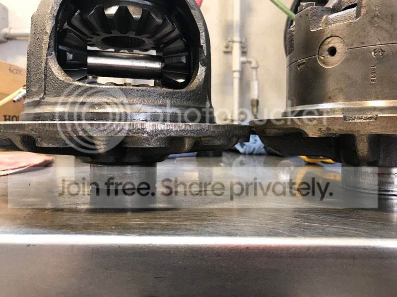

Pull the bearing and stand em up on the table. Run a straight edge across the ring gear surfaces. It should be a large difference if it's the wrong case.
Going to go press the bearings off but I took this picture yesterday. That look pretty far off
Anyone want to buy a 4:56 and up Detroit Dana 60 locker? SOLD
So the front is going back together with the open carrier for now.
