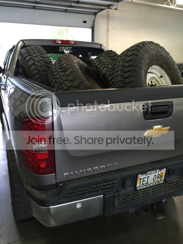

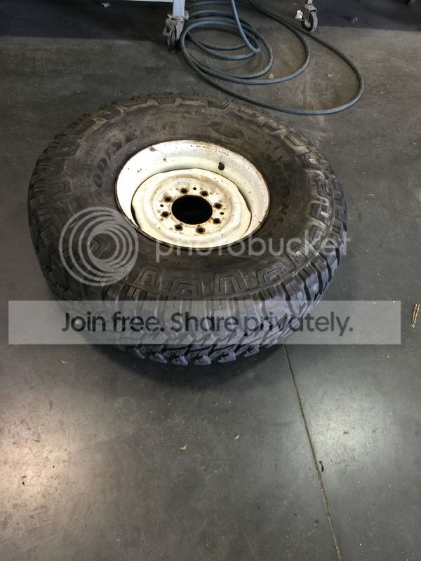

Haven't hung a wheel on it yet. Should have my tires this week. Our friend Paul has them in storage
They will be these 37" Goodyears on steel wheels with factory hubcaps
I think an 1.5" might be to far. It's all just mocked up so won't be hard to move them
Hell yeah! Factory hubcaps and wheels are my favorite. If I can ever find any k-20 caps i will be doing the same.
