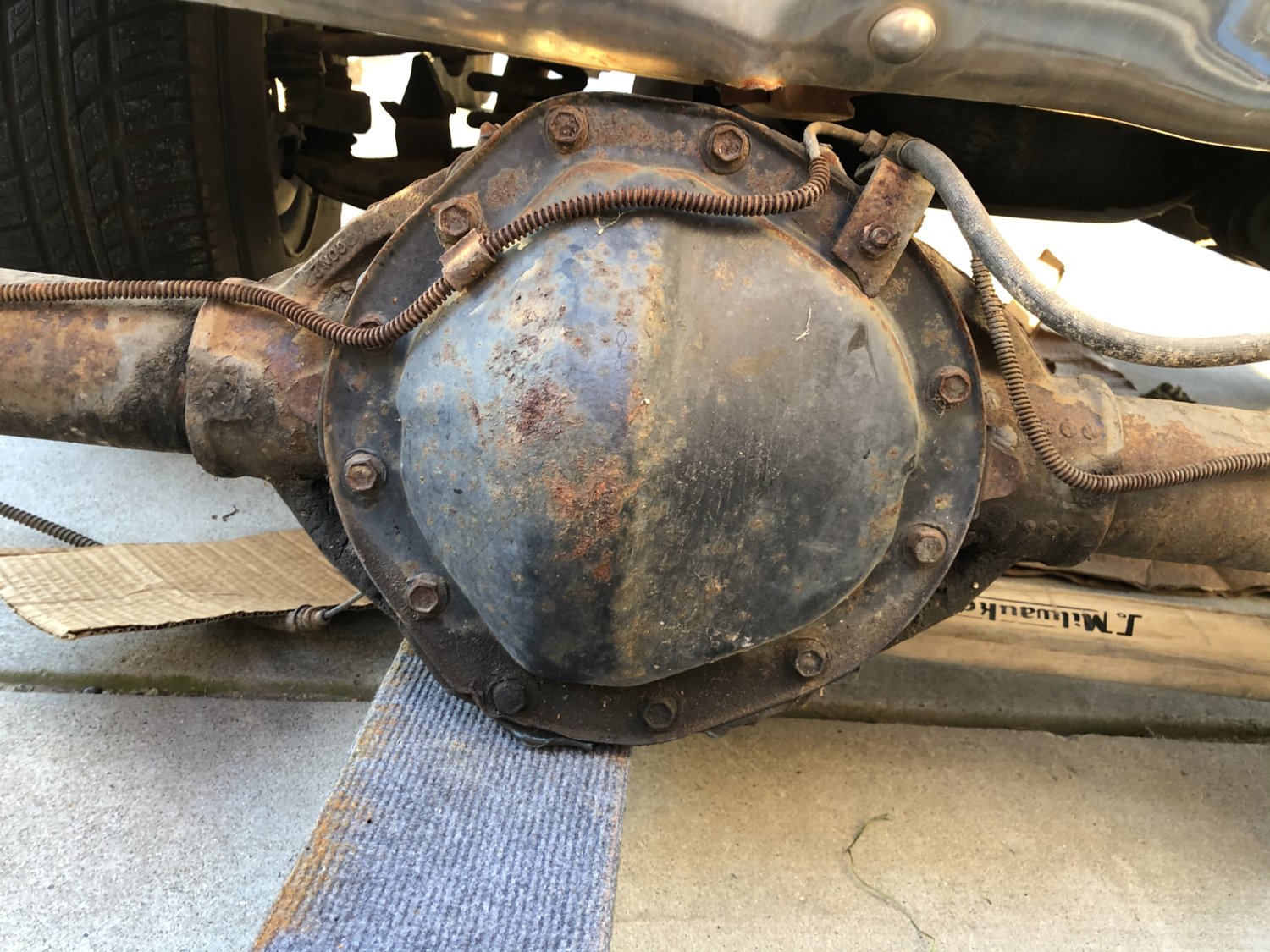

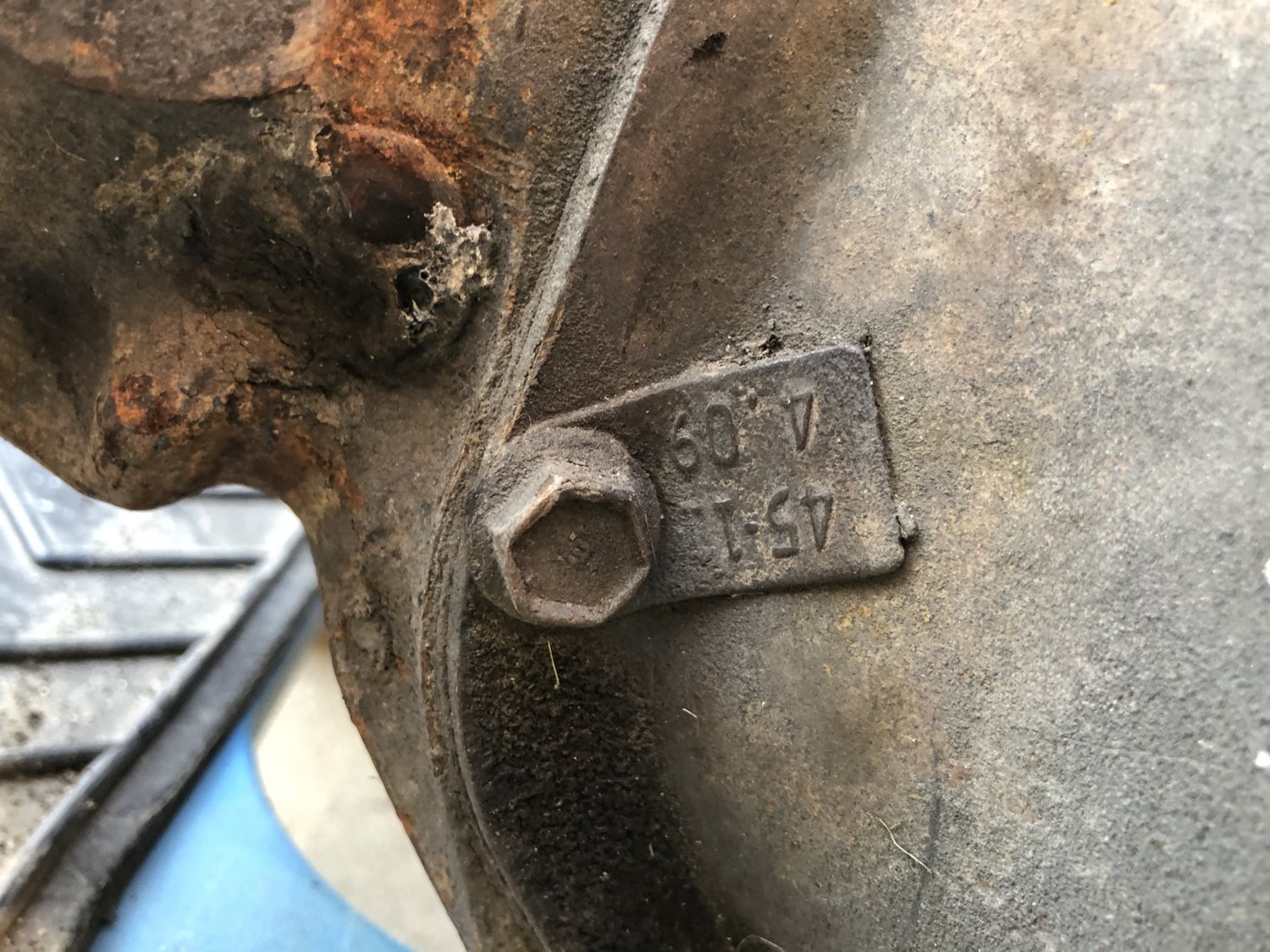

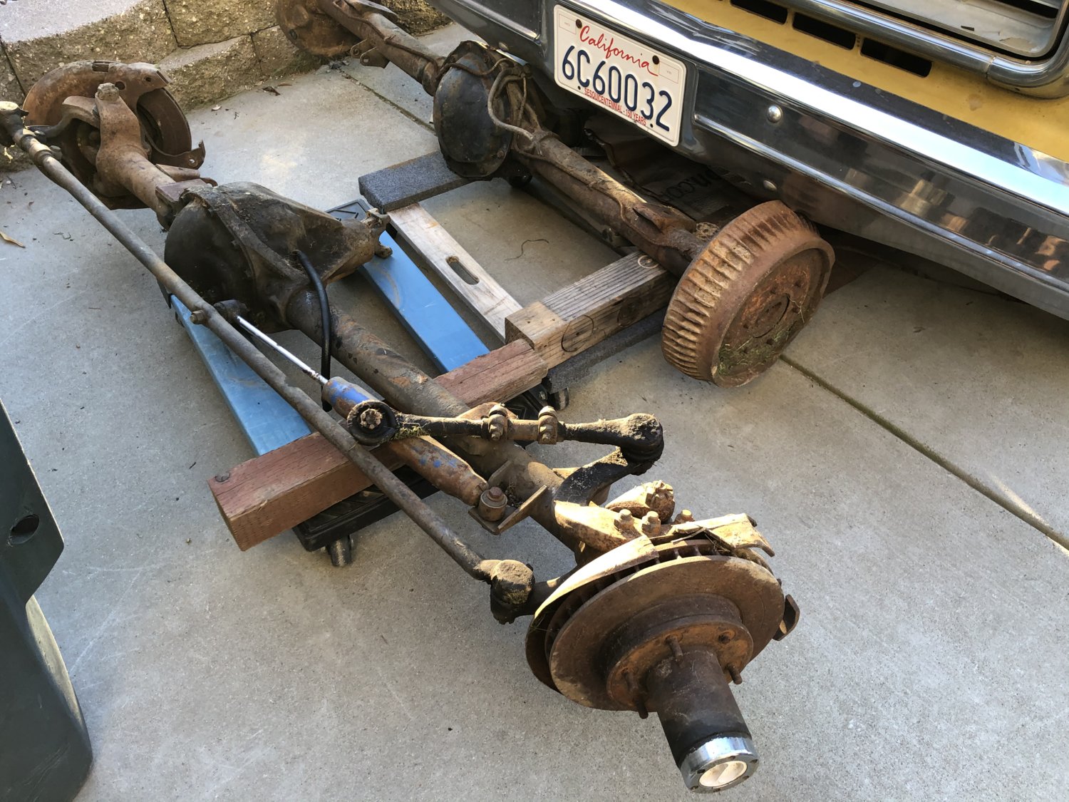

Found a pair of axles on bookface from a early to mid 70's K5. Appears to be a Dana44/12B combo with flat top knuckles, lockouts and 4.10's. I'll need to break these down for an inspection/rebuild and paint. The knuckle will be drilled for crossover (WFO) since I have a 2wd box and a brace/repair kit from ORD ready to go.
axle pics
full
full
full
full

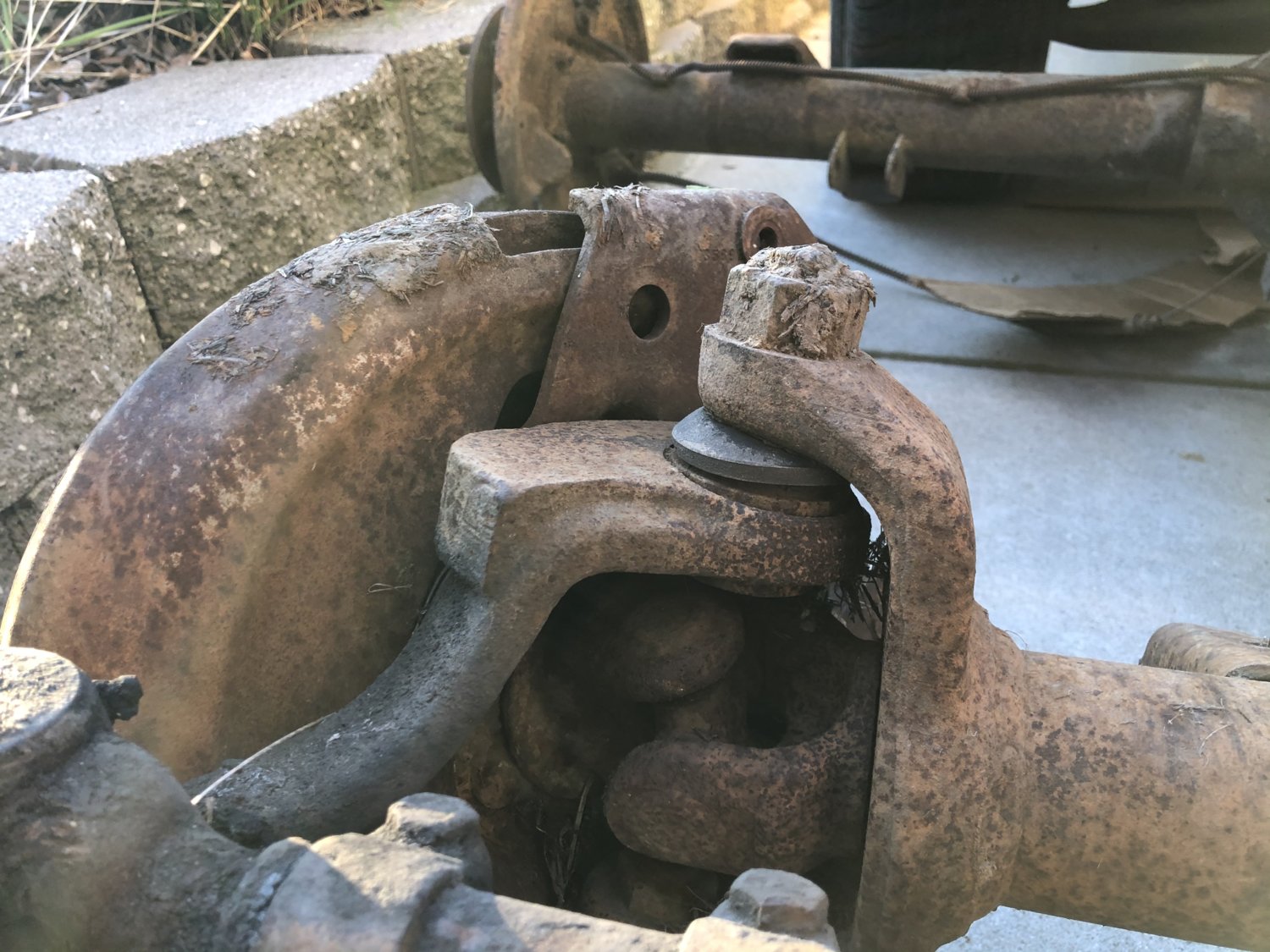

Two sizes
260 joint and a 297
Pretty sure the flat tops got the small bearing spindle which had the smaller shafts and ujoints, unless someone changed them at some point.
But if the truck is not going rock crawling it will be fine
