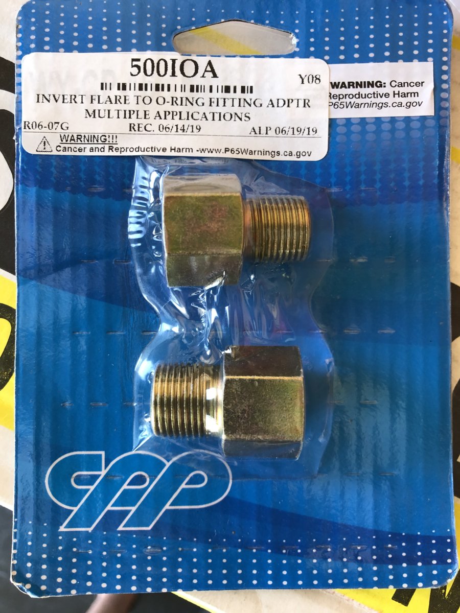

Power Steering- After a little research I was able to determine that I can use the stock L29 pump and pressure line with an adapter at the squarebody PS box (inverted flare to o-ring). I bought the adapter from CPP, new high pressure line and a new pump so should have everything I need for the power steering.

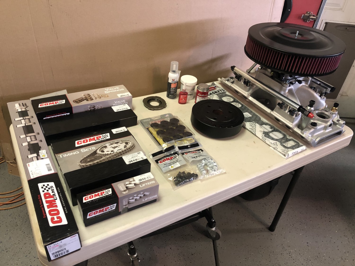

EFI/Ignition- I posted a pic of the ProFlow EFI and I've since acquired a bunch of little parts including MSD coil, coil mount, Taylor wires, AC Delco plugs, water neck, thermostat, Edelbrock fuel pressure regulator, Summit air cleaner etc. All those parts are on hand and ready to be installed after the engine is buttoned up.

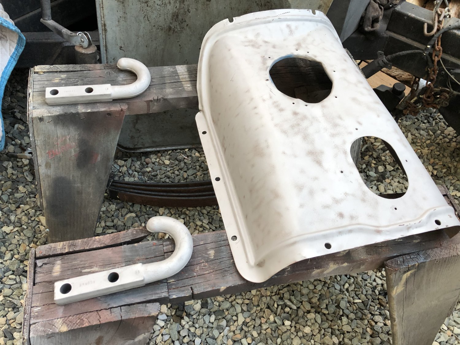

Misc- Other parts arrived including new belt idlers, tensioner and a belt. I also scored a transmission hump (sm465/np205), OE front tow hooks and a 1974 Chevrolet owners manual from @Capt Ron
Cam Package- Took about 5-6 weeks however the Comp Cam package has arrived! This has been holding me up more than anything else so I'm glad to finally receive the parts so I can finish the engine for this build.

floor hump and hooks after media blast

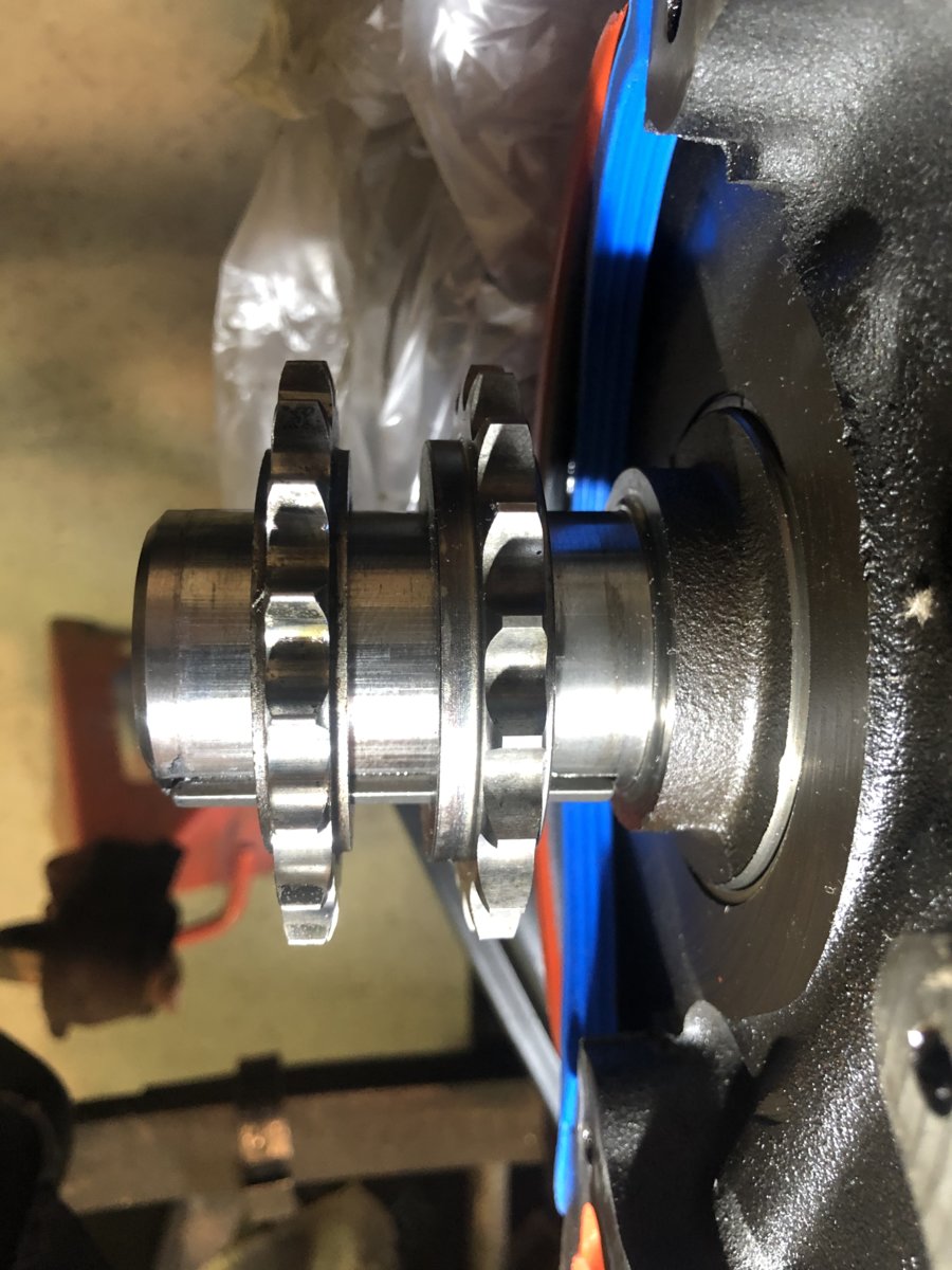

I started tearing down the drivetrain last night.
full

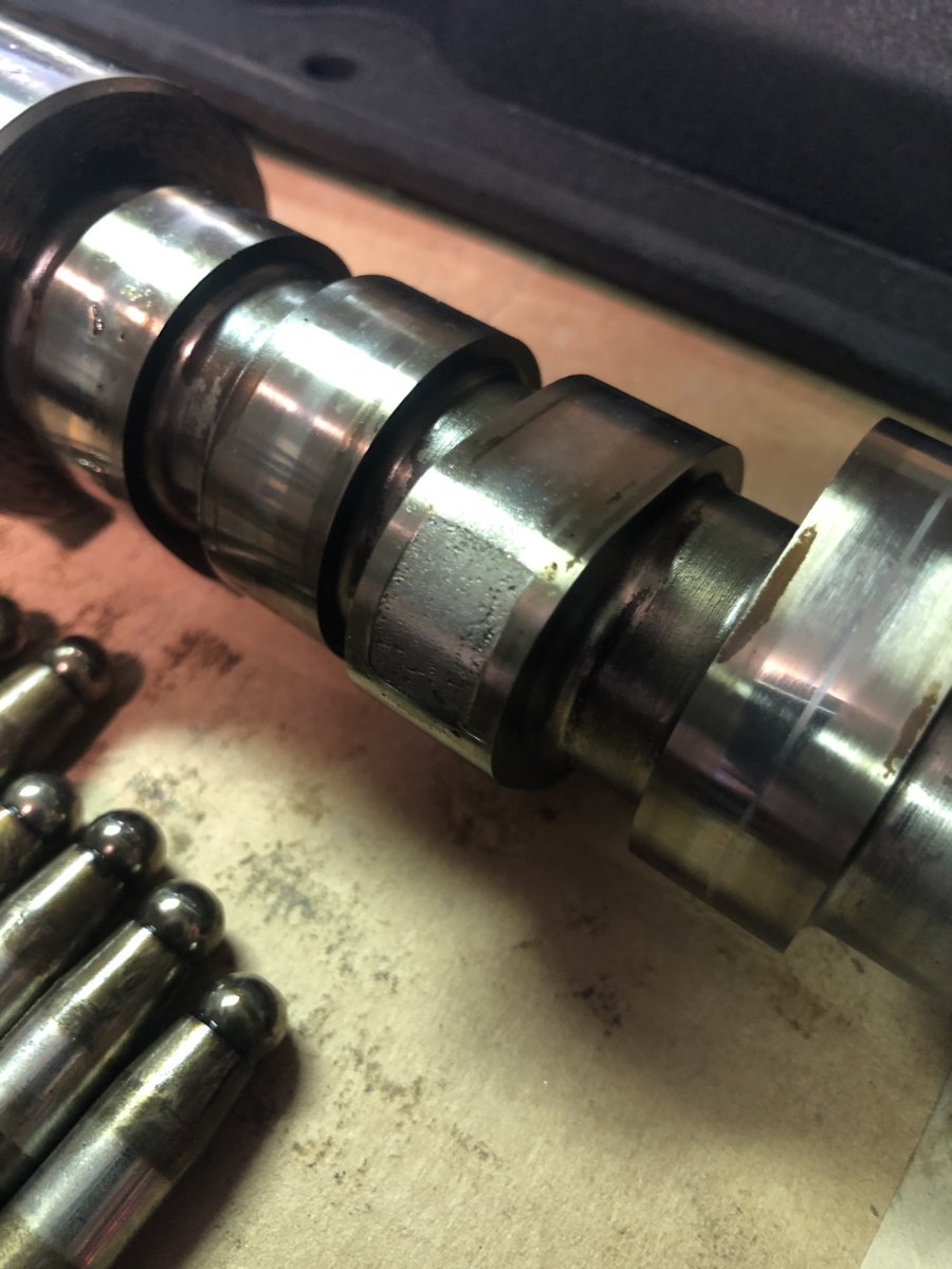

Appears to be good timing with the cam & lifter replacement. Just one lobe was like this btw.

The timing gear on the crank was thicker than the OE version. After some quick measurements I figured out the comp cam gear is suppose to take the place of the stock gear and the reluctor wheel. Good thing I don't need the reluctor wheel anymore.

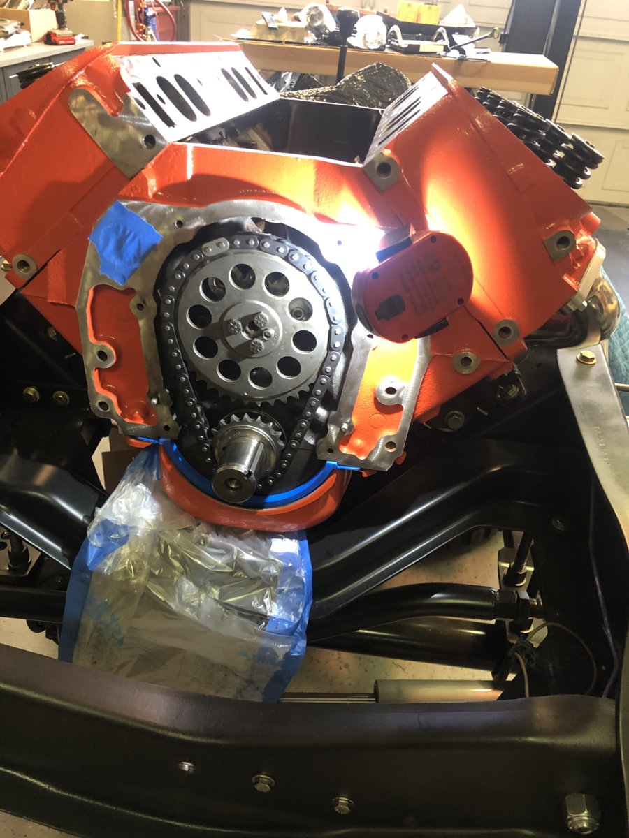

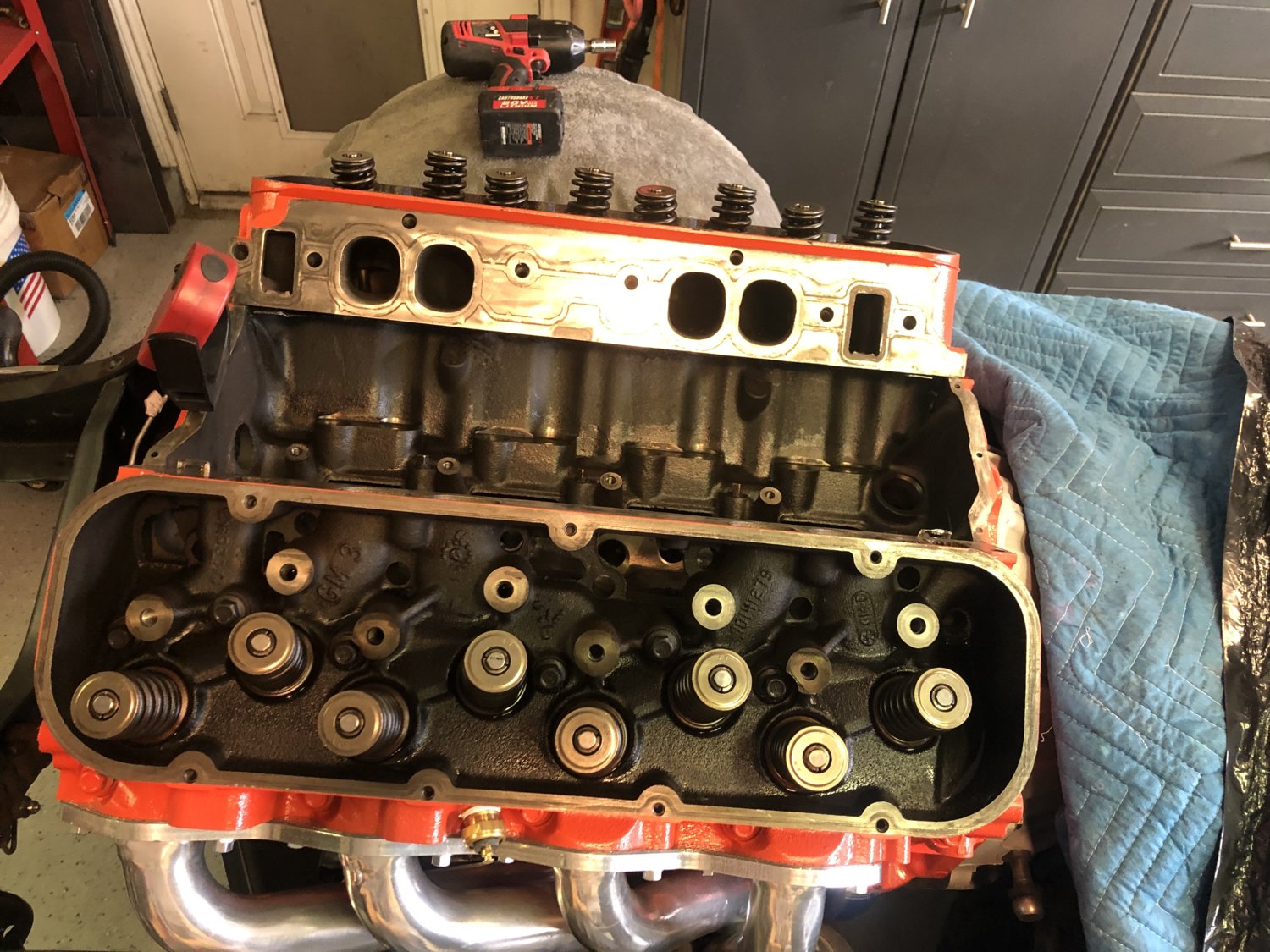

Cam is in with the cam retainer and cam gear torqued with red loctite. Timing is set to zero btw.
full
Tonight or tomorrow AM I'll install the new springs, valve seals, anti-rotators along with the pushrods and rockers.
So it sounds like you're running an external pump? Why do you need the fuel pressure regulator?
I saw you picture of the parts on the plastic folding table and it made me smile because I was just talking to the wife about needing a table like that to lay things out on for the C10 EFI project.
The ProFlow system does not come regulated therefore a regulator needs to be added. I'm running a in-tank pump.
https://www.summitracing.com/parts/edl-17401
That little table is handy and was my temporary office table during the covid shutdown.
I kee 3 or 4 of those in the garage. They’re great for camping (which is why we got them) but they’re even better for temporary parts organization during a project
