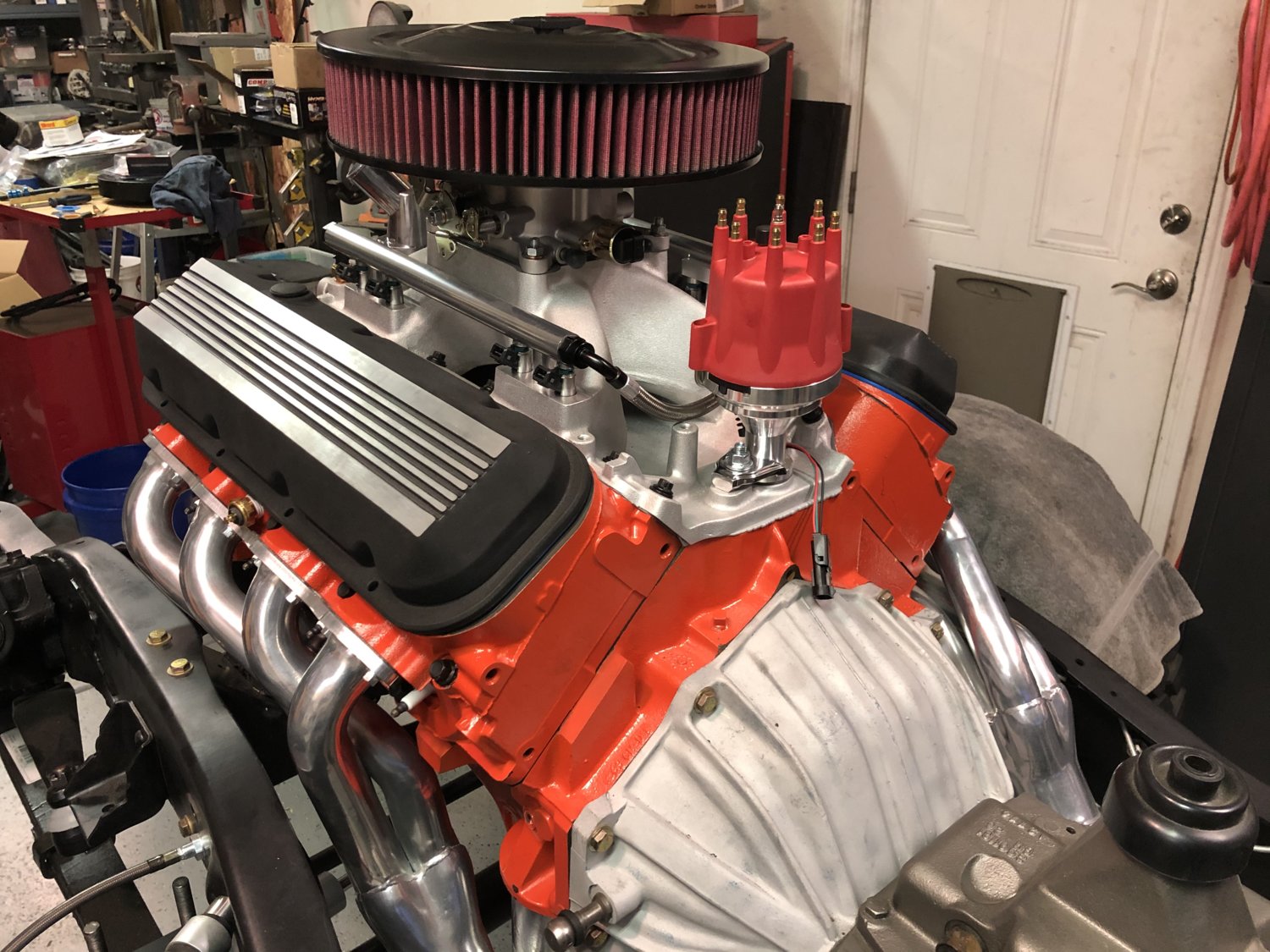

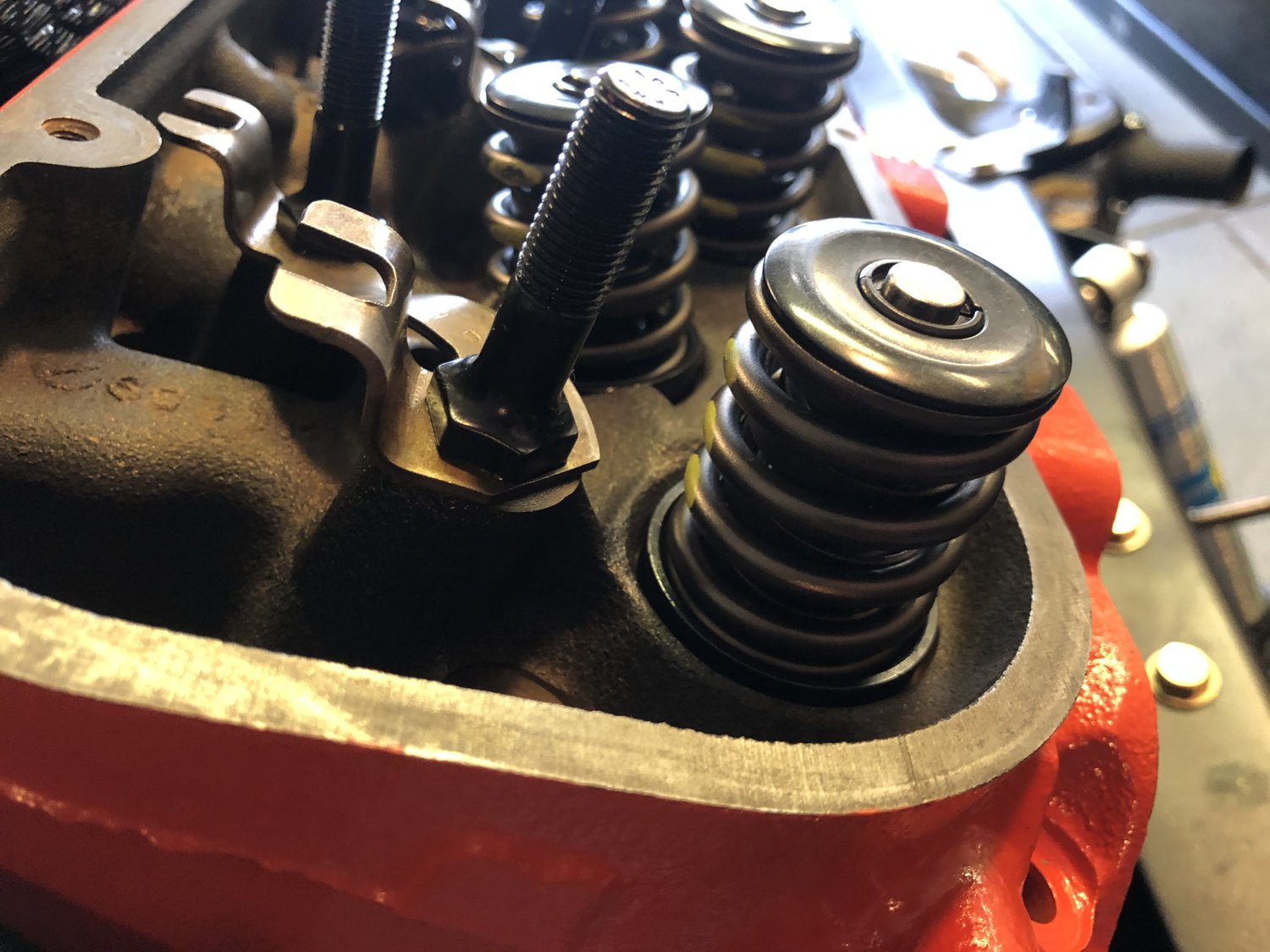

After a wheeling trip and some wrenching on the crawler I'm back on this mall crawler. I ended up having the heads resurfaced and cleaned along with the height on the valve guides trimmed down, then cut for the viton seals.The paint came off the heads so they had to be resprayed too. Shortly after I figured out the spring locators I ordered were designed for a beehive (smaller OD) spring rather than the dual valve springs I'm running. I ordered the correct set and had them next day from Summit (comp cams pn# 4779-8).
full

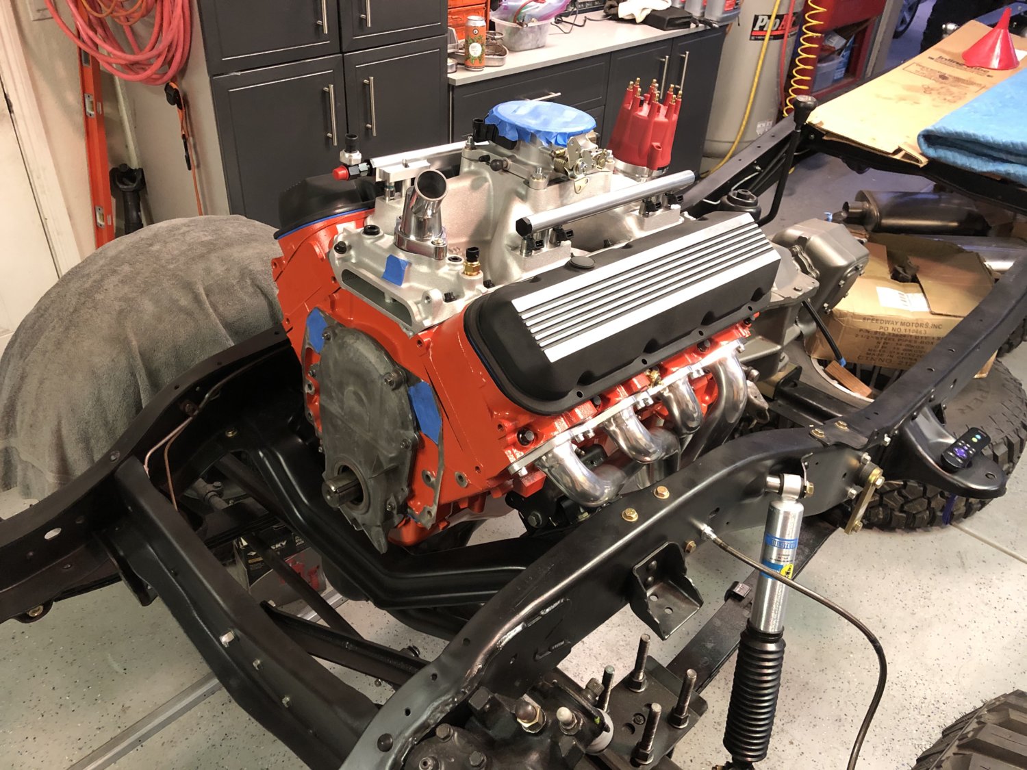

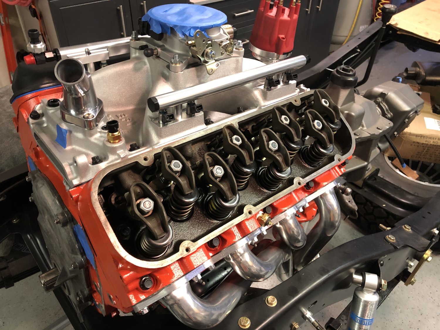

Torqued the heads down, installed the roller lifters, pushrods, rocker arms (need to adjust still), front timing cover, oil pan, starter, headers, bro flow manifold, distributor etc. I had to remove the engine crossmember to drop the pan however that was pretty easy since I removed all the rivets and replaced them with bolts & nuts when I refurbed the frame.

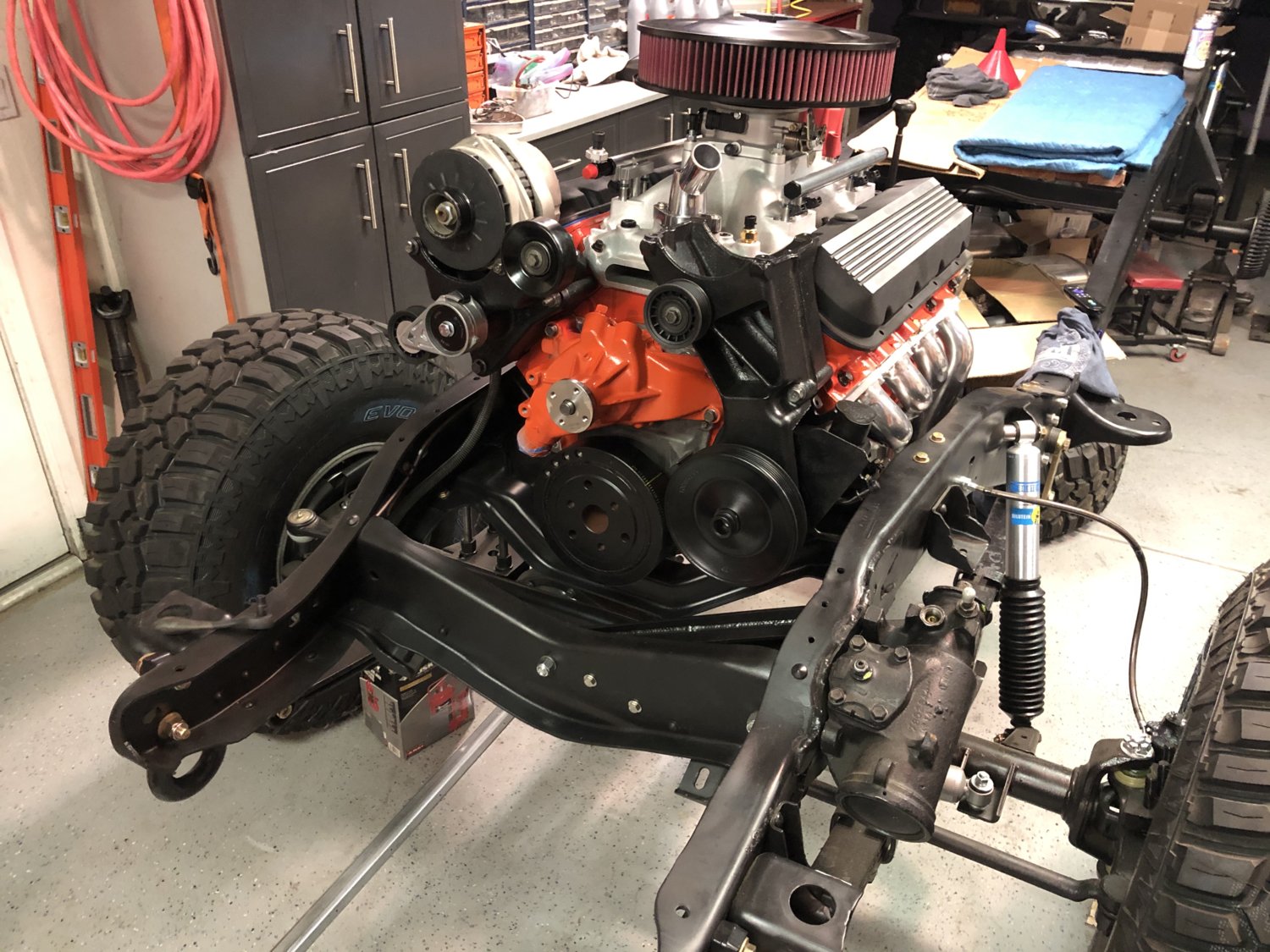

Jumped on the water pump & accessories next.....still need to press the balancer and PS pulley on.

That is the prototype L29 that should be referred to when people are asking about engine swaps LS vs big block. Still looks old school, but roller cam and injection with torque way down low where our trucks need it.
Totally killing it dude. Great work. Should be a monster to drive.

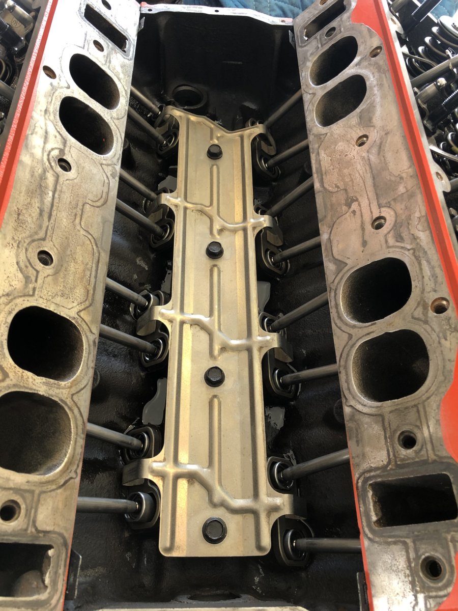

What is the tray at the bottom of the lifter valley for?
It’s the spider tray. Holds the roller lifters in line. They have squared off edges that ride in a dogleg. The factory lifters have a little dog leg bracket that connects the two adjoining lifters with straight sides so they can’t rotate. That try holds downward pressure on them so they can’t wobble and rotate.
