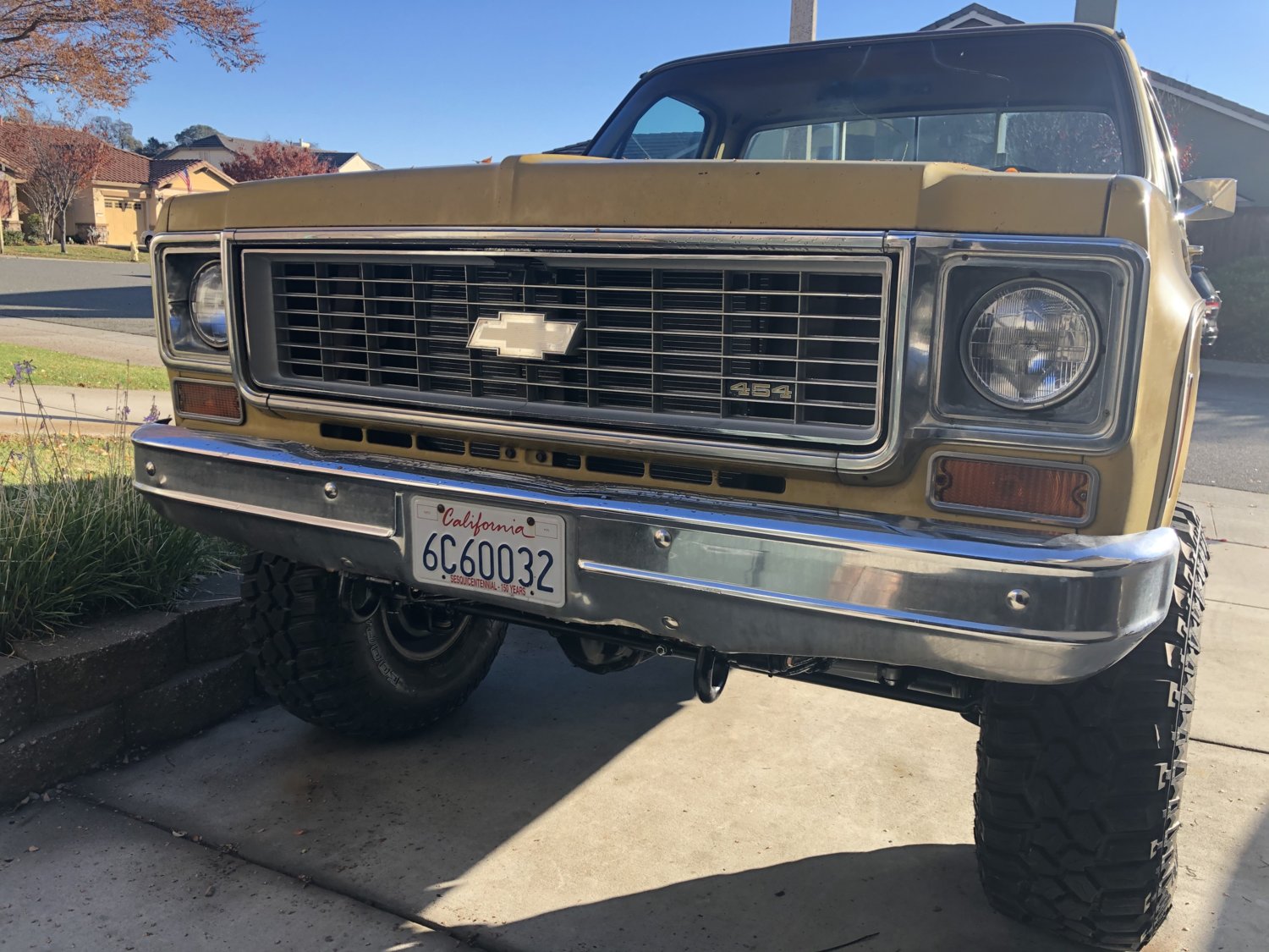

The bumper is back on with all new hardware along with blasted and painted brackets. The bumper is a little banged up but it looks decent enough for this truck.

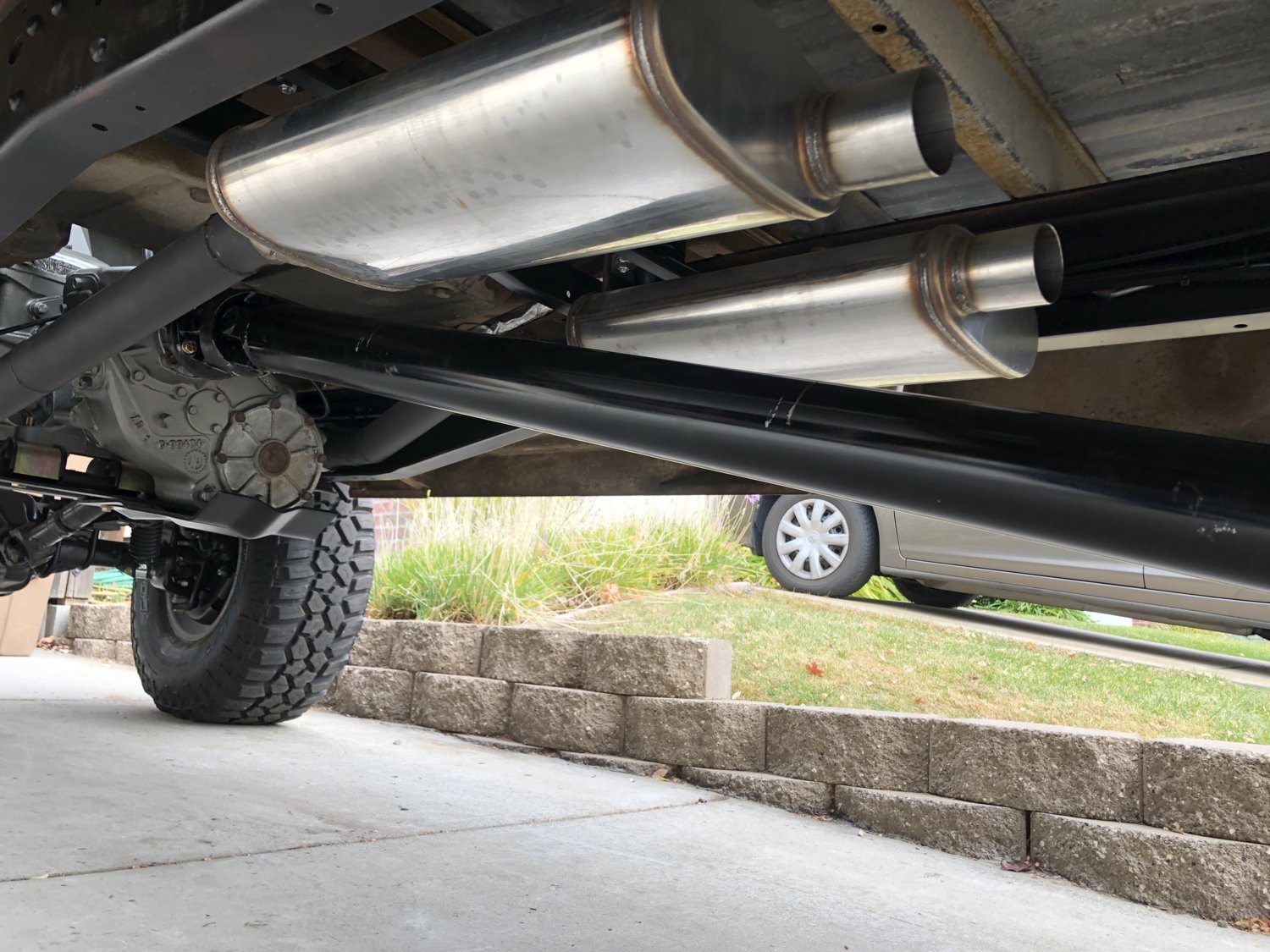

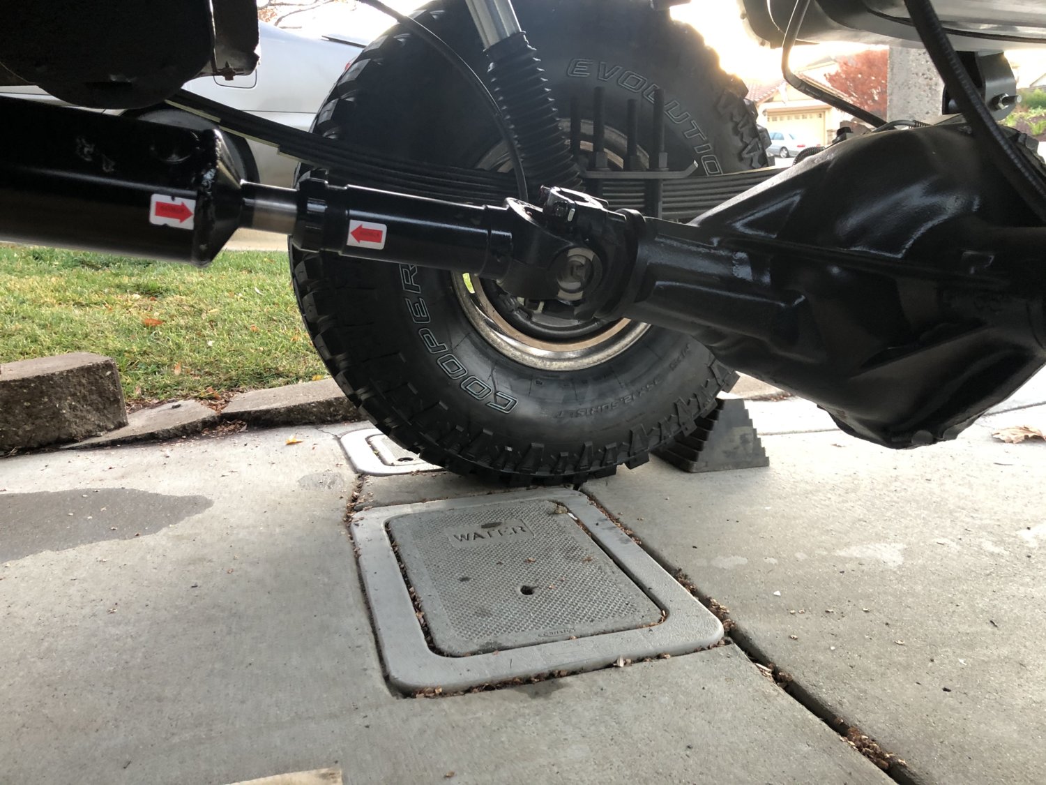

picture of the 1350 CV driveline that I had built.
full
and this leads me into another checklist item, pinion angle. As you can see from the pic below, it's pointing up about 1.65sh degrees from zero so I'm trying to decide between a 2 or 4 degree shim. Leaning toward a 4 because of axle wrap.

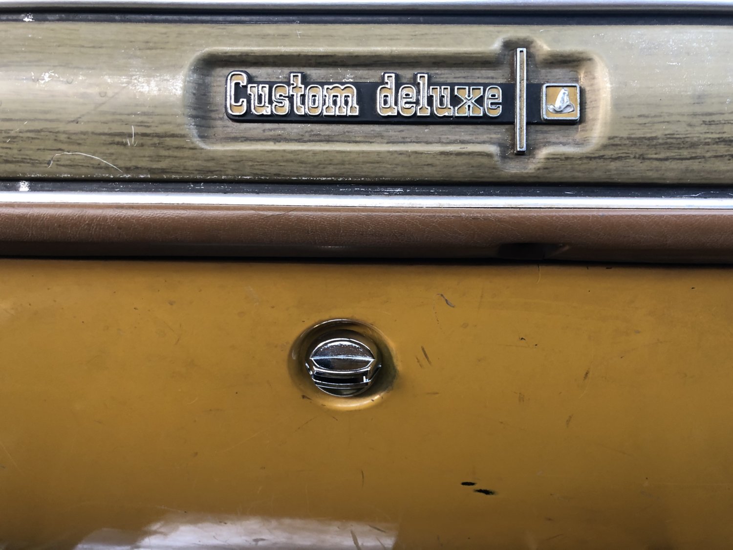

replaced the broken lock on the glove box with a LMC replacement.

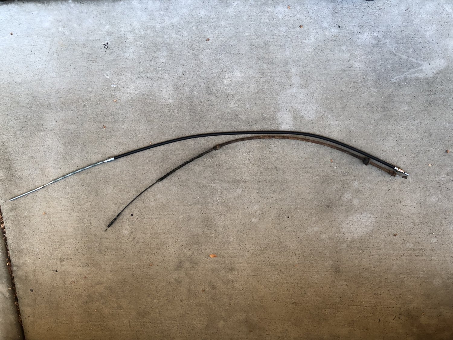

In the package from LMC was the front e-brake cable to replace the rusty cross threaded one I cut off. Turns out the 73-74 C10 has a shorter cable per LMC and the one I ordered is the longer version for other K5's, trucks and burbs :doah:Really bugs me that LMC doesn't list any specs like lengths for cables so you know wtf your buying. I ended up ordering the right cable last night (50.98" overall length) along with some door bumpers and rear bumper brackets from Ecklers. Once I receive this cable I should be able to assemble the rest of the E-Brake system so it's functioning properly.

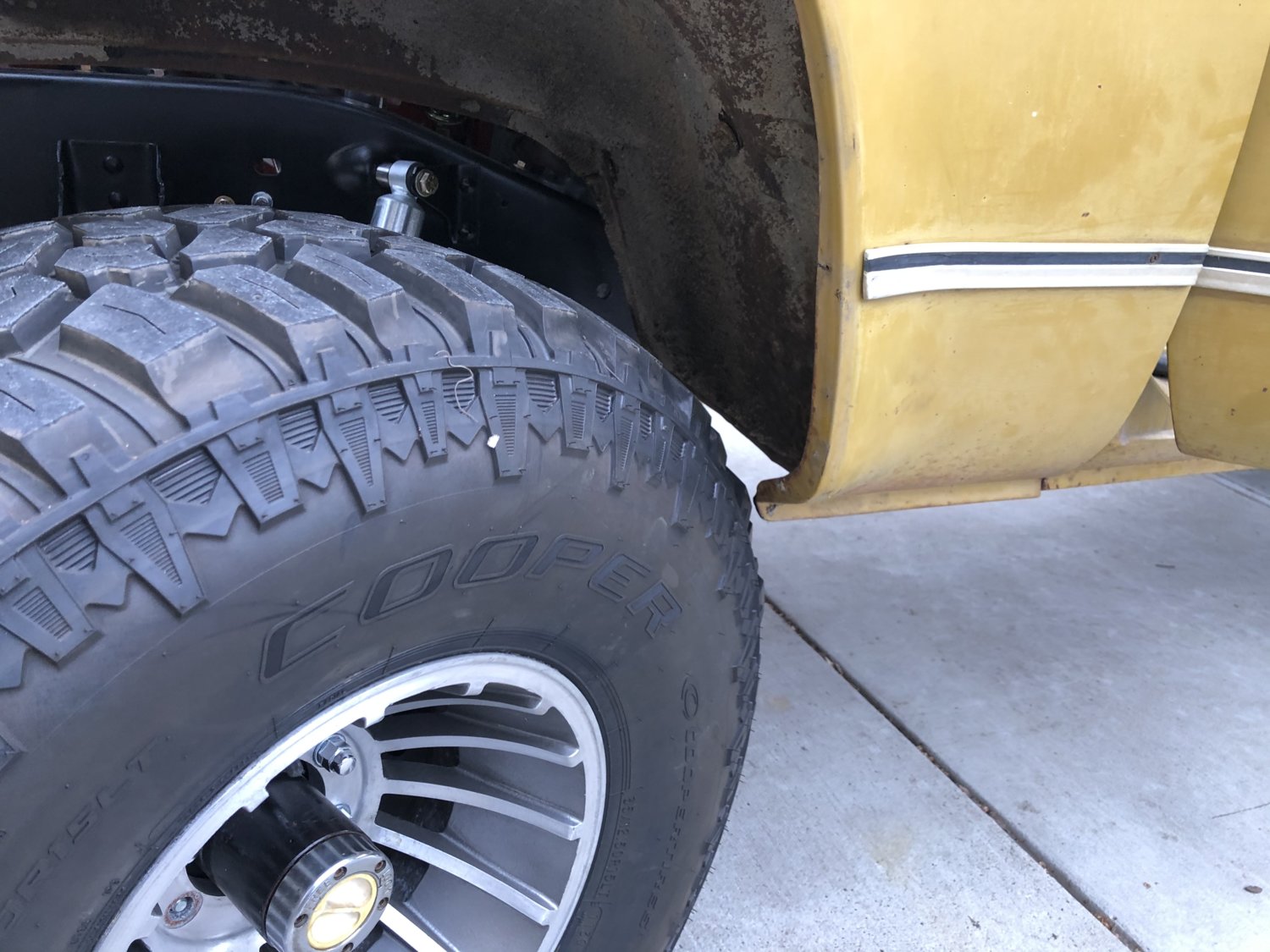

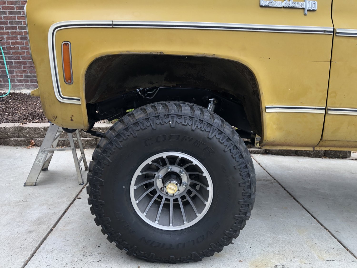

When I first backed this truck out of the driveway I heard some rubbing and realized the front drivers tire tore the trim off the fender. Keep in mind these are fresh 4" tuff country HD springs. I removed the trim for the meantime but I still need to deal with the clearance issue. The truck sits slightly raked right now so I'm leaning toward a EZ Inch over a 1" body lift however I won't be surprised if the rear springs (new 52's with a 4" flip) also settle some. I really don't want to cut the fenders on this truck so I'm trying to find a fix this without the use of a cut off wheel. Phat block problems.......

On the picture of the glovebox latch looking at the emblem on the dash trim, what is that little graphic supposed to be in the square on the right? A cowboy hat?

it looks like it could be a cowboy hat, or a smashed cone.
Zero rates. I’m not a fan of how the bumpers look after the body lift.
yeah I don’t like the gaps either. I have two pair of ez-inch’s on the shelf so I’ll probably try that.
I ran up to WFO and picked up a pair of 4 degree shims. Looks much better now.

Haha, Angle looks bueno
Hopefully the O rate works out?
I guess if it was mine and the 0 didn’t work I would trim. Don’t think it would look bad, you do nice work. Sure wouldn’t want to cut up the tires out camping. Cause you know you will go more extreme than the mall!

Thank you and I'm going to try the zero rates later today. The truck is definitely getting used camping and I thought the wife would drive it. Now she wants to drive the crawler and told me to drive Sancho.....that should be interesting.
I was noticing the Cheyenne Super in the C10 has a longhorn steer head. Was thinking the cowboy/ranch theme is interesting. I guess I'm using your thread for random thoughts.
Honestly, I never really paid any attention to that emblem. Interesting tid bit.
