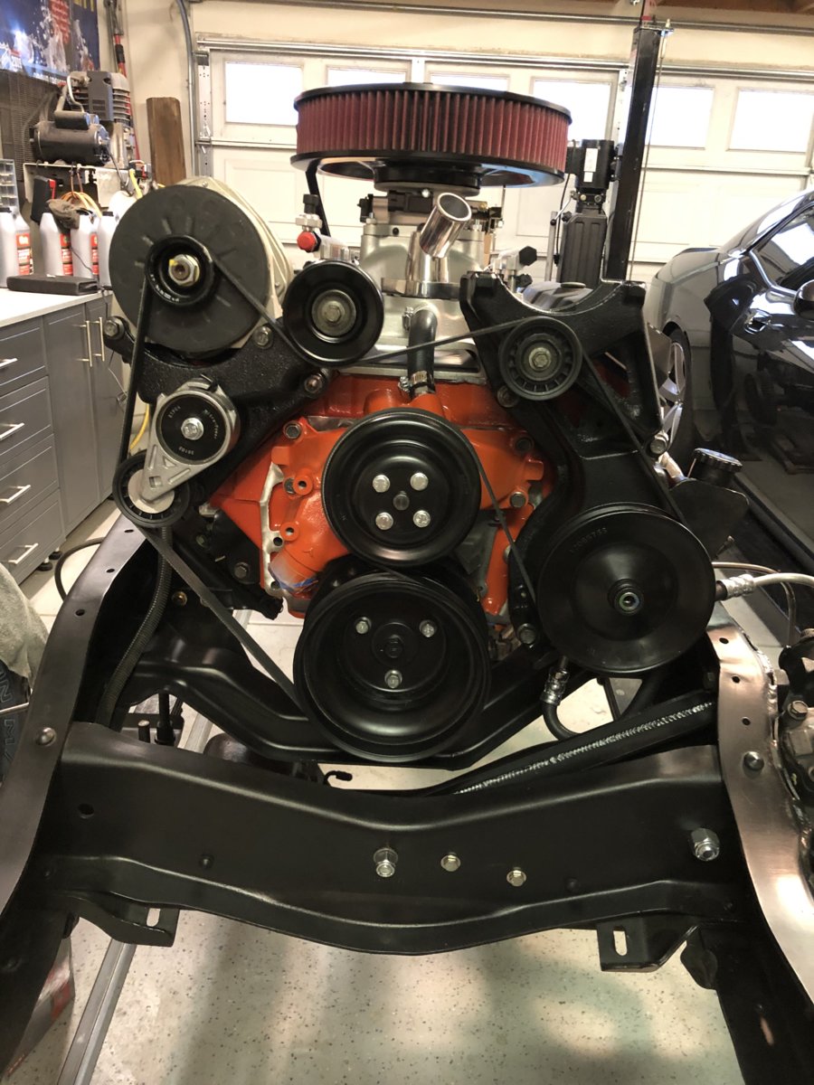

The new alternator is installed and the belt whine is louder than before. With the truck running I can release pressure on the tensioner and it quiets. I can also remove the belt completely and it's quiet. Using a piece of hose to my ear I'm unable to pinpoint the exact location of the noise. The two idlers and tensioner are new and I swapped in the old ones with no change. The PS pump, water pump and alternator are new. Previously (couple months back), when it started making noise I replaced the belt with a gates and it fixed the problem until recently.

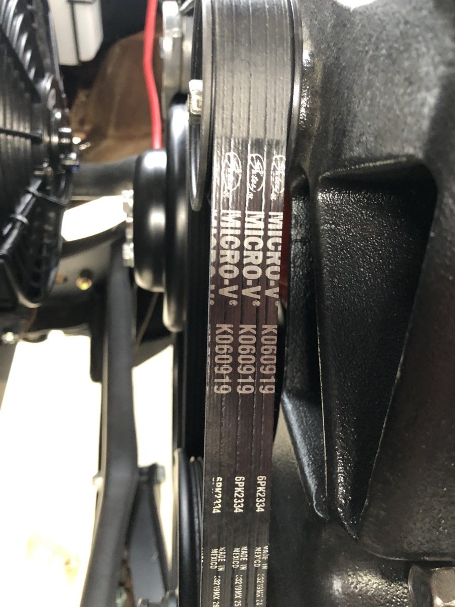

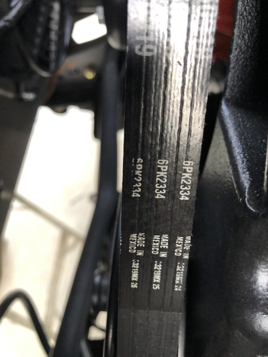

Looking at the belt last night I noticed the smooth side of the belt had linear wear or maybe stretch marks? Not sure if that's normal or not however I can't remember seeing that before.

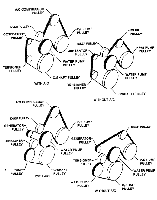

Because I'm questioning everything I've done, here's the belt configuration diagram (top right w/o air pump and AC).

The only other idea I've pondered is paint on the crank & power steering pulleys.
Any other suggestions or ideas are welcomed.
Free and somewhat easy to scotch brite the pulleys. I’d start there
Also not a fan of the belt. But cannot think why that would look like that
I hit the pump pulleys with a wire brush last night but it could probably use a little more love. The belt wear has me a little baffled too. The first belt started making noise almost immediately, well before I got a chance to drive it but it was a shitty no-name belt so I assumed that was the problem.
Looking at the available belts through rockauto, I don't see any major differences either.
