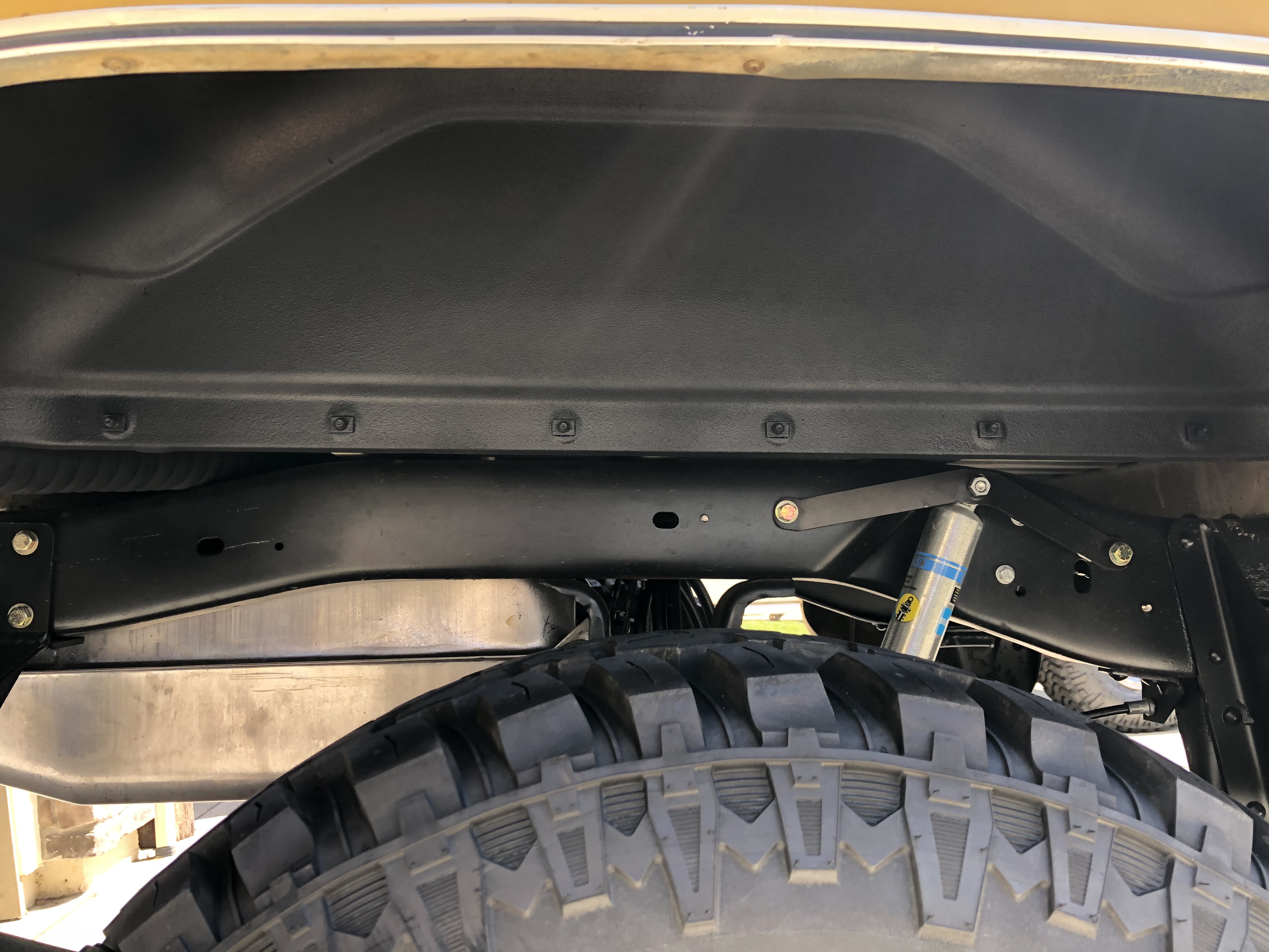

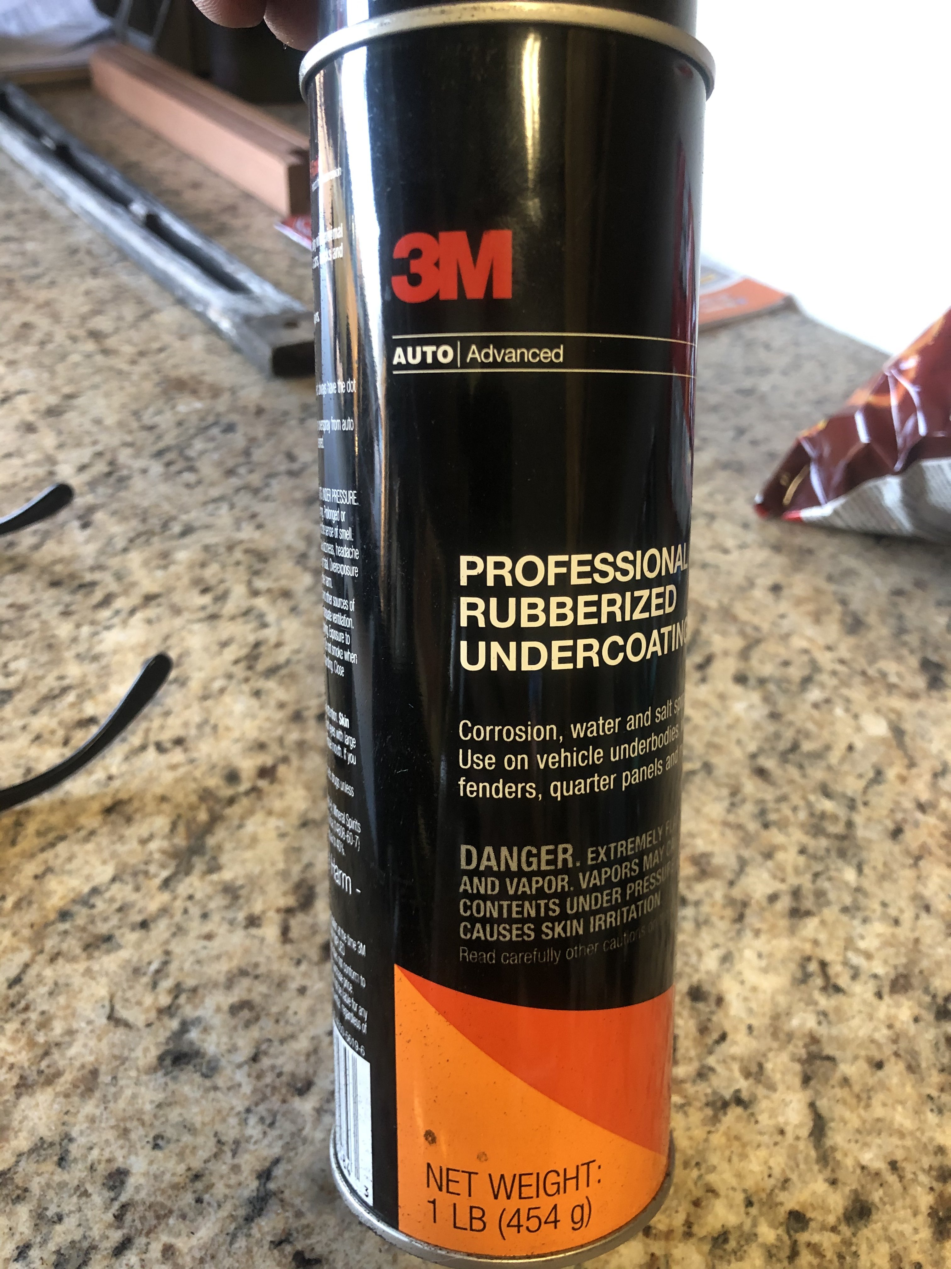

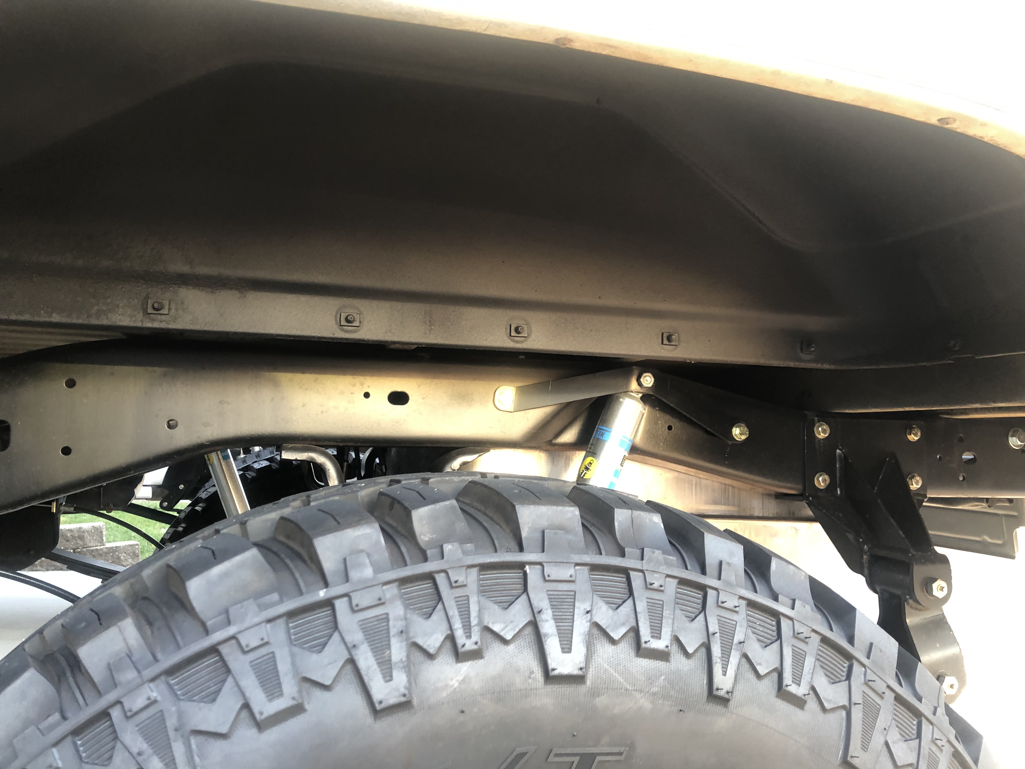

Some of you may have noticed the brown paint inside the wheel wells from the other long bed fenders and floor I swapped in. The brown paint stood out too much so I picked up some 3M undercoating from autozone, taped off the frame, wheels and shot a couple coats. Came out pretty damn good.
