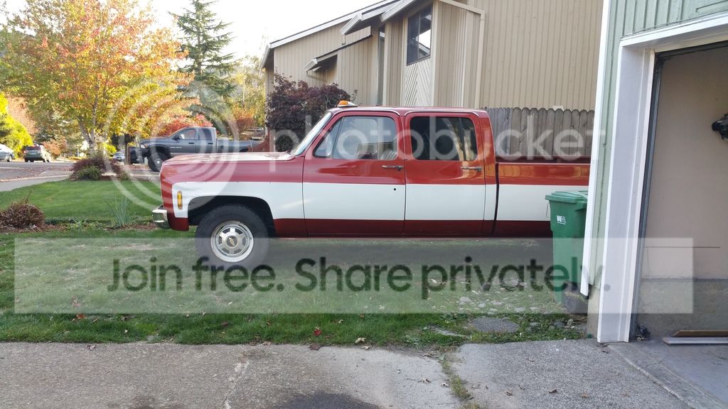

Crew is enough together that I used it to move the quads around. So fine! First time it's moved under its own power since I pulled it in the garage three months ago
Looks great, you gotta get all the trim back on before too much stuff find it's way into the body panels via the holes!

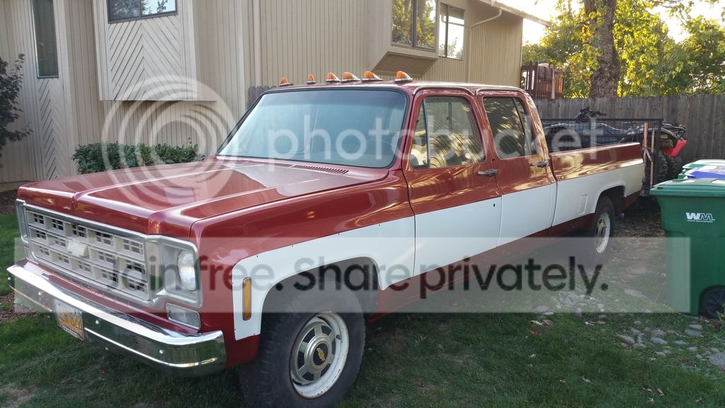

Man, that looks great! I haven't been in here in a while and it was a surprise when I saw it. Welcome to the "stock restoration" club...you have preserved a very nice example...and I noticed for the first time that your hood is indeed original. (no mustache). How do you feel about it now? Will you just throw stuff in it and use it or will you baby it and keep it looking good?
The metalflake looks good too. My only regret with my paint is that I wish I had gone a little less glossy. If I had thought about it, I would have asked them to try to match the original laquer sheen.
Now get the razor blade and sideways scrape that paint off the rear window seal :eek:
Lol let's of little stuff like that tool do! I painted nearly the entire passenger side wing window some how! No, I have no intentions of babying this truck. Certainly going to avoid scratches and such, but like I said, this thing will see hundreds of miles of gravel roads yard debris and normal truck stuff. I'm sure I will set many a beer on the hood. It will just be a normal "well cared for but used" truck.
