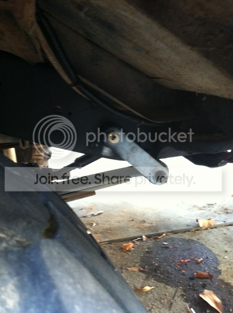

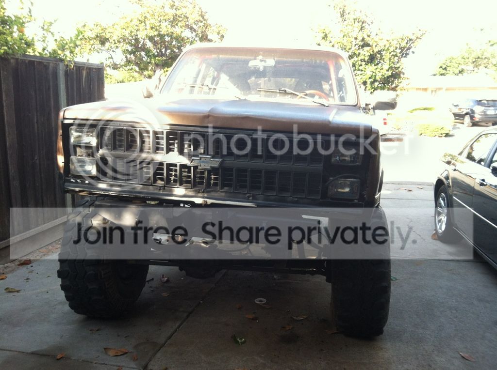

Stock 56" on driver. Lifted 52" on pass. Gonna finish ye 56s tomoro and hope my shaft is long enough to get it done. Got my steering link and shock hooked back up on the left. You can see my steering box is already peeing itself in anticipation
So. Made a new problem.
Got the new springs on. Too low. Too long.
Lowest the truck has been since I've had it. I like the low stance looks tough with the 38s. But as you can see the shackle angle kills it. Shackle is actually resting on the frame rail. If I'd have known going in I was using 56s I could've moved the front hangar far enough forward. But it was positioned to use 52s so I'm hosered again
or try and find a set of dodge dakota rear spring iirc are 54" long
id like to throw a set of 52s on it and be done with it. but dont feel like going to buy some for $100 from pick n pull.
going to try switching the 3/4 ton tall leaf pack from the rear with the 1/2 ton pack that i put up front. difference of 3 leaves + Overload compared with 6 leaves + overload.
i'm hoping the swap will get me a lower ass, along with raising the front enough to give me kinda compression travel, i think if i can net an up travel of 2-3", i'll bump stop it there, and leave the rest as droop. i could dig that cuz i'm really digging this super low on 38.5s" look right now.
Welp. Did that. Bupkis. Did help to lower the ass a few inches so that's nice. But the front was only a moderate change. Now at static height there is about a 1/4" between the leaf eye and the frame rails.
Back to the same point. Need to either sack up. Chop the body mounts and move the swing hangar back 2-3". Or wait til I get paid at some point and go find me some 52s. Not gonna make it wheeling this weekend. But looks like I'm gonna ride down with a buddy and just hang out
Stock 56" on left. Lifted 52" on right. Gonna finish ye 56s tomoro and hope my shaft is long enough to get it done. Got my steering link and shock hooked back up on the left. You can see my steering box is already peeing itself in anticipation
Looks like the truck is hiking a leg....maybe the steering box was jealous..:dunno::D

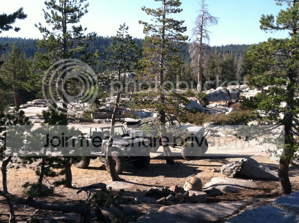

last weekend went camping in the sierras in a buddys scout.
camped 2 days. pooped on some logs. all in all a great weekend to get away from life for a bit

Looks like the slick rock or strawberry pass. Both are way fun trails.
Slick rock it.
From bay area it's a perfect weekend trip. Took about 3.5 hours towing to get there. Only about 2 hours to run the trail end to end.
So I figure leave town early Saturday. Run trail. Camp fish. Wake up wheel trail and head home and be back home by lunch.
