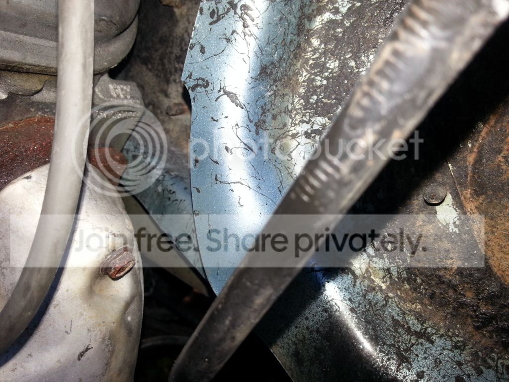

So close it looks like it's touching. But it's not.
Babaganoosh you've got plenty of room. It's not like you're going to have to worry about an HEI distributor sticking out the back of the engine. You need to make sure you'll have plenty of room in the front for the radiator and whatever fan setup you're going to run (I'm assuming an electric fan).

I want to use a electric fan. I might push the engine back a inch or so. I don't want it to close but not much. I just need to drill 4 new holes isn't that big of a deal.
No time to take a break while bb14 is on the line.:pimp:
Id leave it where it sits front to back.. Do you realize how much easier that makes removing/installing the tranny?
That is a good point, it was pretty easy to get to the bolts.
I'll leave it for now and see how the new motor mounts do when they are in my hands.
Yeah don't bolt it down until you find out where everything else is going to end up. That's what I was trying to say.
Only thing that was drilled was the frame plates for the motor mounts. 4 holes, will be easy to fix that.
