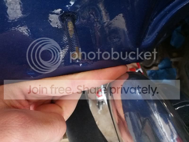

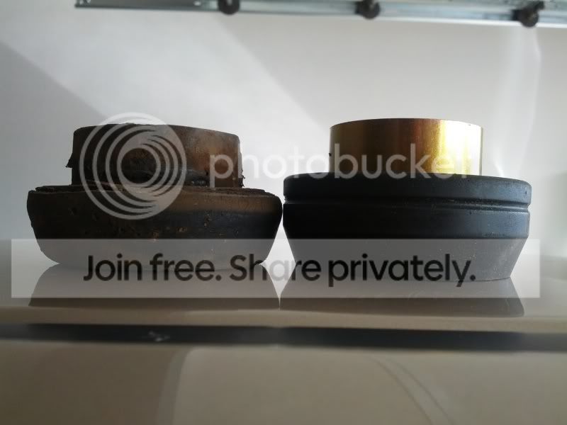

Got new cab mounts on today, it's now 3/4 a inch higher off the ground. :eek1: For the passed 22 years my Dad thought the passenger rear nut was spinning inside the cab, turns out the bolt was stripped but the nut was fine? If you put a socket on the bolt, it would just spin and not go anywhere. I jacked the cab up and it spun right out no problem, why is that?

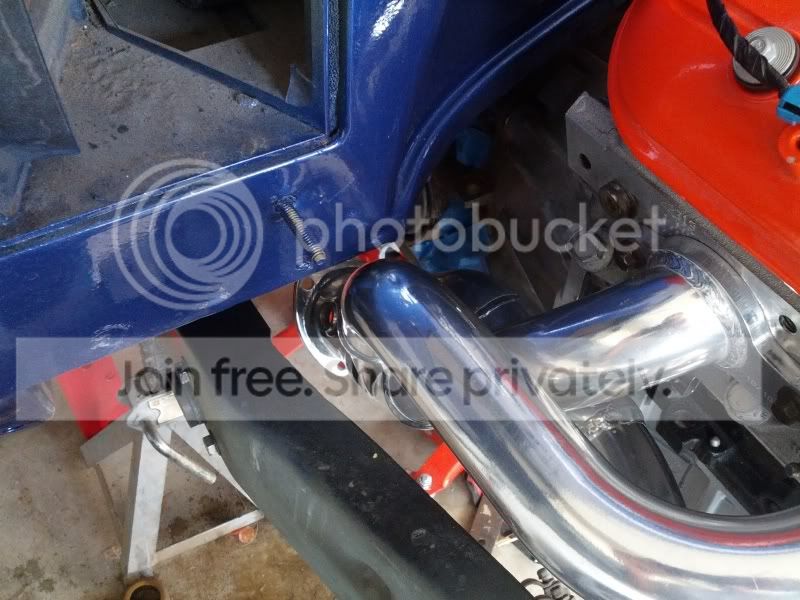

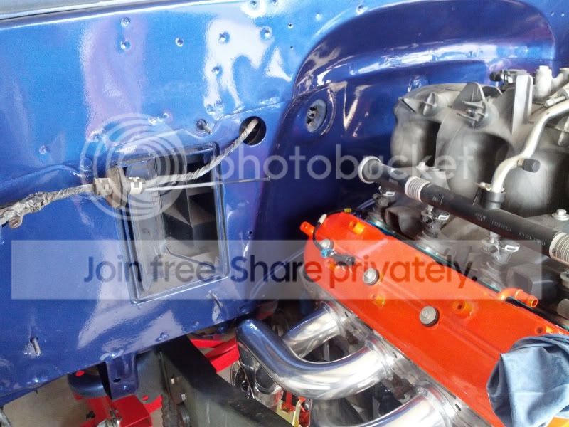

Also, just for Wade I cleaned up the firewall and check out some clearance, I think the engine fits perfect now.
What do you guys think, the engine is at 6 degree rake with the trans perfectly flat.
I don't know man. The engine moves a good little bit on the mounts. Looks nice and clean though. I think a 1" body lift is in order.
Unless for some reason the cab mounts sink or the engine comes flying up off the mounts it won't hit the cab.
Frame clearance is about a 1/4 of a inch from hitting the rails.
I hope not. Keep in mind that the body/frame flexes a good bit on these trucks, especially off road. Of course with all the frame bracing you've done and the new body mounts, you should have nothing to worry about.
Aren't you basing your engine bay on Teck's more or less?
1" body lift is your friend
I think it's quit close Baba. Even with my half cage, new mounts and such, I still see front bumper deflection. So from front to rear, it's twisting. Is 1/4" enough. Dunno, but while working the engine AND trans it might become closer. :dunno:
