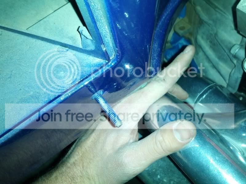

I messed with the truck some, I now have 5/8 to 3/4 of clearance to the firewall pinch weld, will this be ok? I think I should be fine but want to hear everyone's voice.
Also in the process, I chipped the paint a little. :doah: Maybe I can sand it a little and feather in some of the left over paint I had mixed in a can. Do you think this is the best bet Wade?
Get a brush, dab just enough to cover the exsposed area. Let that dry. Do the same with the clear. Make a list of tuch ups that need to be done, do a bunch at once. Less waisted paint material to be thrown away.
That will work, I still have the materials, they are in my closet... Just hope they are ok still. Do you think I have enough clearance now or should I go for more?
I wouldn't be shocked to see it get kissed on a hard landing or something. But I would also bet that you will never get it to land that hard. I think you are good to go.
And if I do that's why I have air bumps. :thumb: Next time the engine is out I want to do a little hammering to smooth out the curve a little and maybe get a little more.
