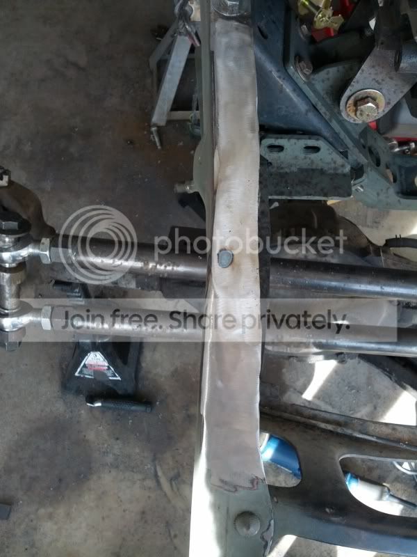

Here is the area.

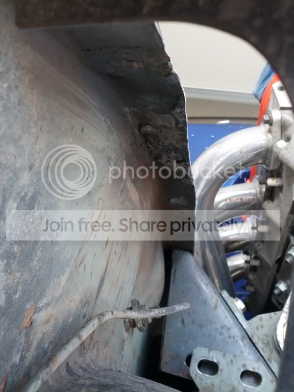

underside.

So what's the problem? Grind the bottom side of the frame and clean it up some.
Looks great! But your getting spatter all over your tie rod and drag link! And maybe on your little helper? :giggity :
It looked a lot worse before I started but I may grind a little more on the bottom it's hard to see it.
I know little disappointed in that but oh well at least it will clean up easy. And, :doah::haha:
