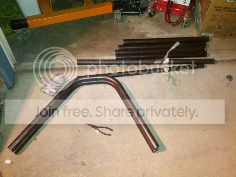

Chris, would that longer tube be the pitman arm tube and the shorter the cross over?
I was thinking pan hard bar, and cross over tube between the hoops. Was having a conversation and posting from my phone.
No drag link in the kit, it must be the pan hard and the shock hoop cross over bar.
The smaller tubing is for the panhard, the 1-3/4"-.120" is to tie the two shock hoops together.

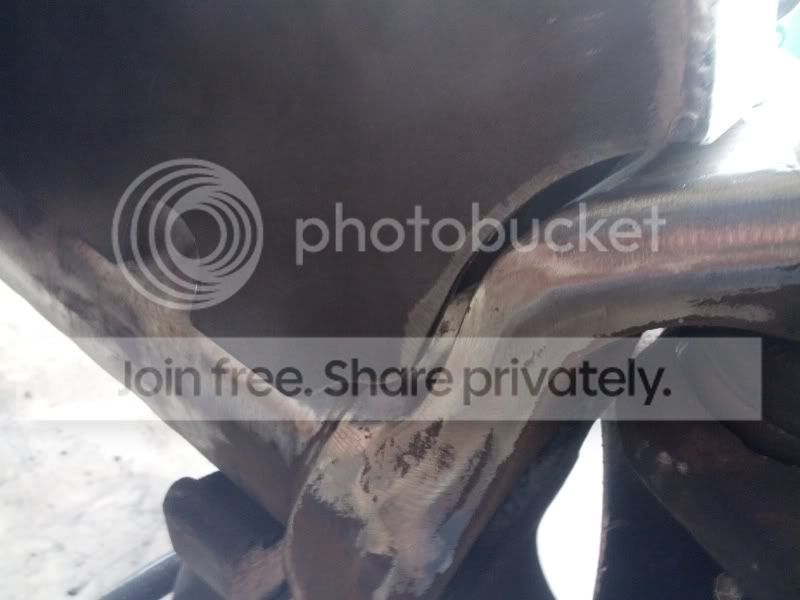

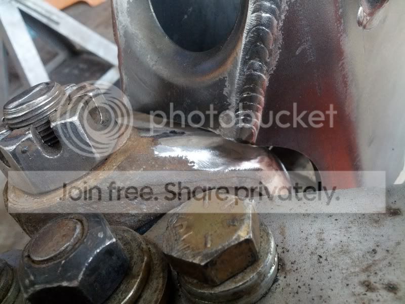

How tight should the brackets fit on the axle? On the passenger side it sits flat on the u bolt plate but sticks around a 1/4 off the C. The driver side fits a bit better but has the same issue.
I think you will just have to grind to fit. I remember someone saying that while they were very close, they needed some amount of messaging.
It looks like you only need to slide it over about an eighth inch. If it was me, I would try hogging the u bolt holes out a little bit, and clearancing the u bolt slot on the bottom of the diff. Just me.
