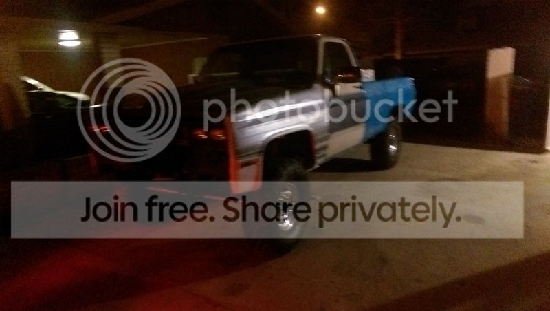

Don't think I will be running the slave solenoid. I'll keep it simple stupid for now and change it after the bash if needed.
Thanks I can't wait to drive it and give rides.
It is looking like it's maiden trail is going to be in Moab.

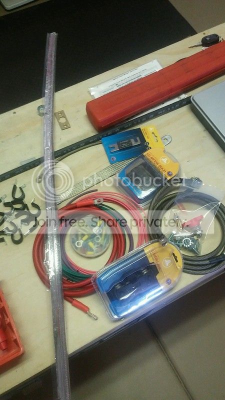

Looks like Shawn took care of the wiring. :eek1:
Scared to see how many hundreds this is.:doah: but I respect clean well down wiring and emphasize good wiring.
So...how close are you to driving this thing?
I think we need a couple of updated checklists. 1 of tasks remaining before test driving, and 1 of tasks remaining before Moab. Assuming that Moab won't be your test drive. :rolleyes: :haha:

Tomorrow is the day, epic win or a epic fail is going to happen. Everyone please say some kind words to the big man the 6.0 is a fire breather.
