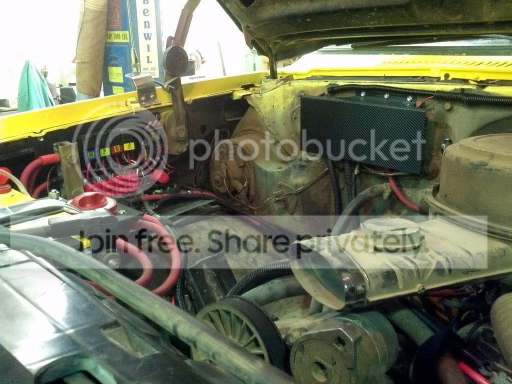

Doesn't have to be too complicated. In the picture below I made a cover for the CUCV bus bars on the firewall.
It's just a flat piece of .040" aluminum bent in an L shape with a flange for screwing to the firewall. Leaves the sides and bottom open for wires but covers the "ugly".
You could mount the solenoid on the fender or firewall and do the same kind of cover.
