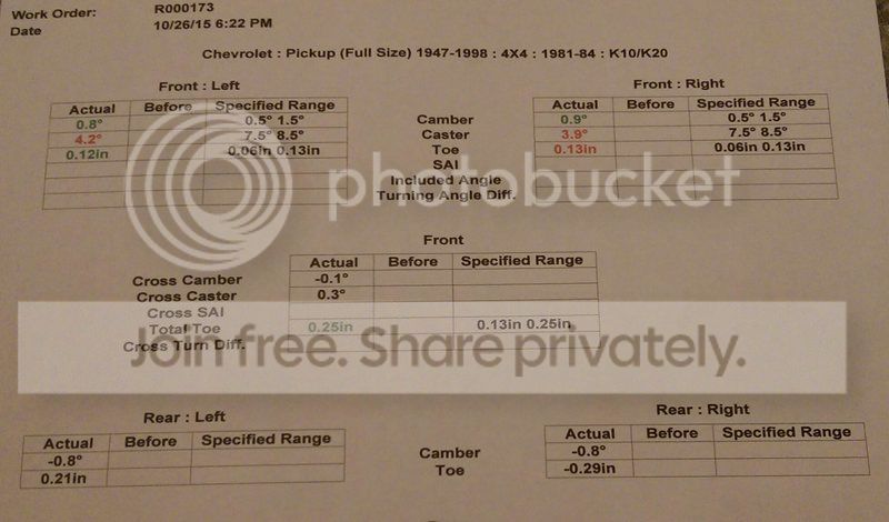

Well it looks like at ride height the caster is at zero or a degree positive.

I am confused, why is it set at 0 - 1? I would be shooting for a minimum of 5 degrees, more like 7 or 8.
Oh OK, I see know. I was worried your links didn't have enough travel to get it where you needed it. Good to hear.
