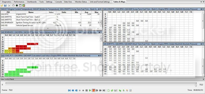

Wish I knew what this stuff meant, did some data logging yesterday.
You gotta select O2 MV to be able to see the long and short fuel trims. So that log really means nothing. Also, when logging with narrow band there is no point to be hard on it. I can see where you opened it up a bit and hit in the mid 5k rpms with decent load. By then you should be in power enrichment and the O2 readings would be pegged and not doing anything.
Hehe still had more revs to go! Is this something I need to do before I start recording or only when I import it?
I'll do some research and report back.
Hmmm, thought it would have recorded it, I turned on the PID. I'll goof around with it in a few mins.

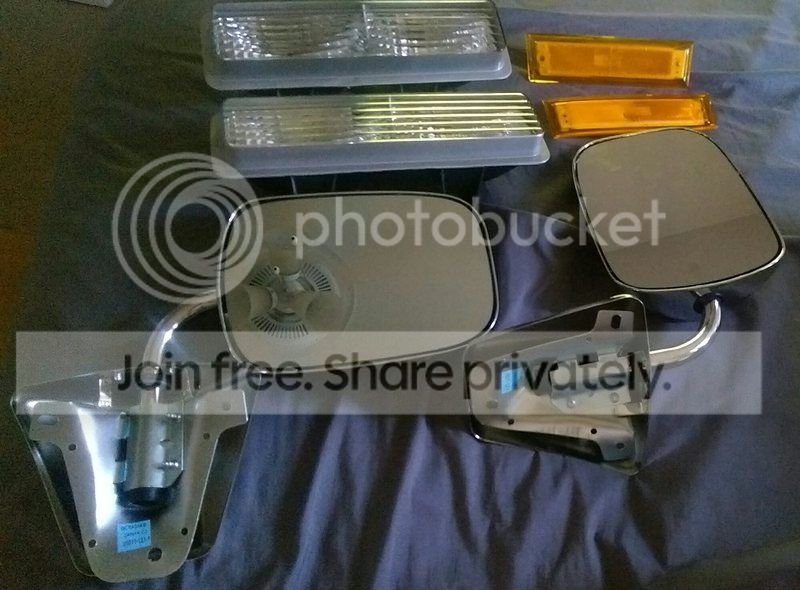

Just bought tags, marker lamps and mirrors! Getting closer to daily driving.
Looks like I will have to redo the logging. But it appears I can connect my tablet via usb to the laptop and record it that way.
The other day I was watching the o2 voltage on a tech2, it was giving the same reading vs both sides. Not sure on what a good reading is vs a bad one.
