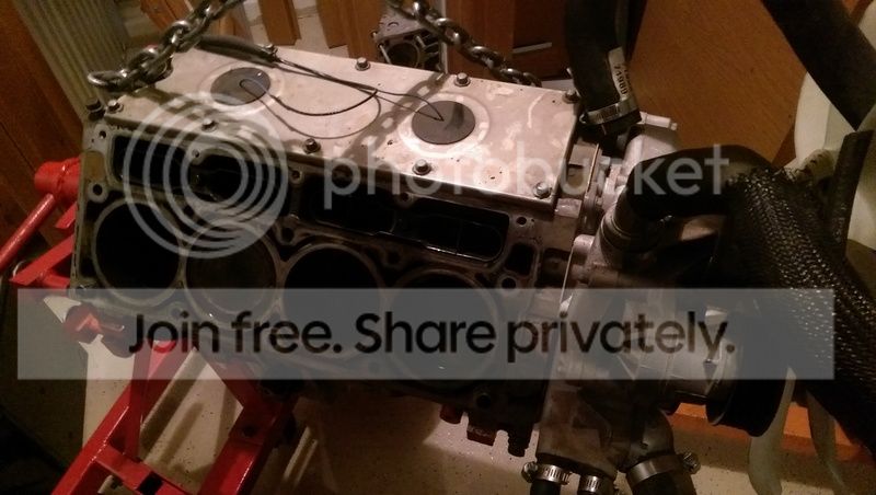

I didn't have the correct socket for the knock sensors or a air hammer for the fan clutch but it's all apart.
3 rod bearings, the crank is damaged and the cam is stuck in the block. He believes a cam bearing went out and caused the rest.
Also said bolts in the short block were not properly torqued.... So much for a good known engine that a friend went through and swore it was good.

Cam bearings are a very common thing in the LS engines. You really have to look at them when pulling a cam.
Here was supposed to be a known good engine.....
Took about an hour to get the cam out holding the bearings with a few screw drivers.
