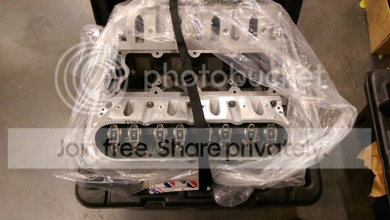

Well here it is, looks like I got a busy weekend ahead.
