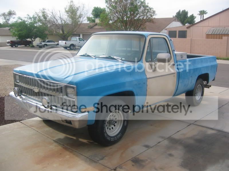

And just for giggles I found some old pics.
Yes doors seems to be a frequent replacement on this truck...

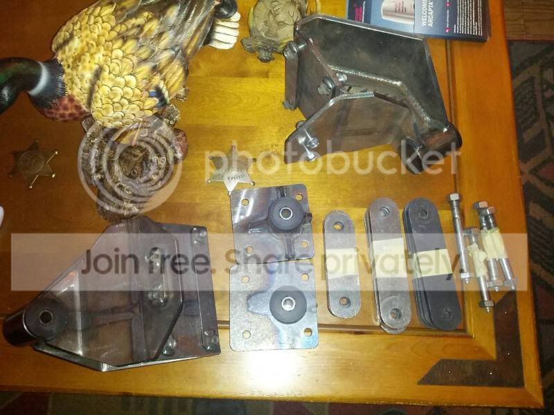

I picked up some DIY4x parts and should be putting this thing together in 3 weeks.

Got some diy4x parts today from a fellow ck5 member.

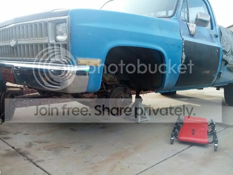

I couldn't take it anymore... The build officially started, what better day to start on Americas birthday on a old piece of American iron.:woot:

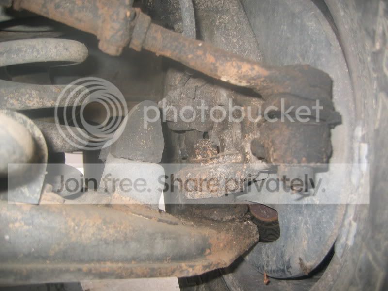

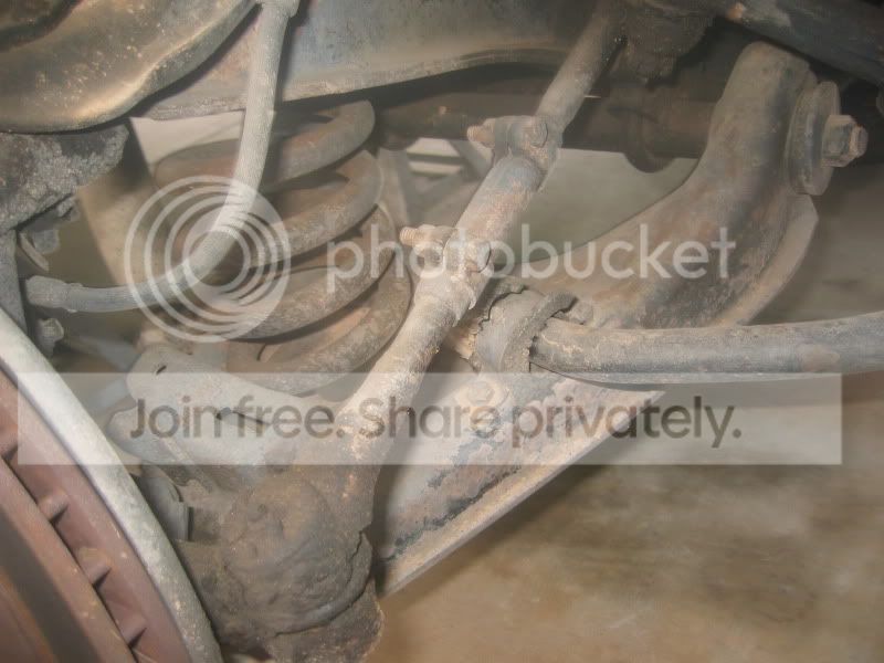

Here is the partial reason for the SAS
Yes that is a alignment shim falling out, it's so worn out it spits shims.
you don't usually see an '82 getting a SAS...... most people prefer to swap axles under trucks that never came with an axle from the factory, like every truck from 1988+!
