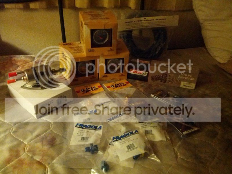

Brown Santa delivered the rest of my parts.
Hopefully it's a pretty productive weekend. I could start it this weekend. :eek1: But without VATS removed it would die withing a few seconds...

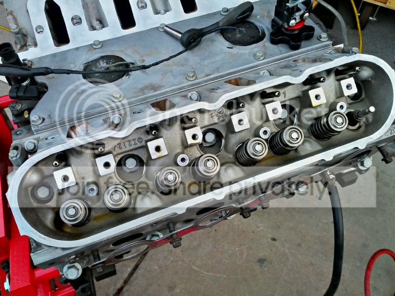

Didn't get nearly as much as I had planned to get done this weekend but such is life.
I did get all the valve springs swapped out. That is a job I don't look forward to doing ever again...

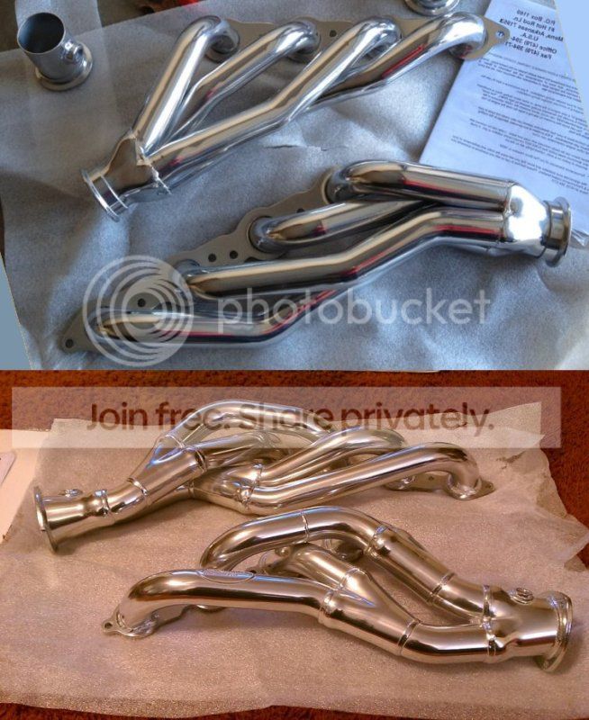

I'm at a loss for what I want to do for headers.
I took these pictures from the internet, the top one is from Teck's thread.
Top Street and performance comes with v bands. Bottom Doug Thorleys.
I'm leaning towards the Thorleys but I can't make up my mind.

I don't think I will buy another set without the v bands. They are a really nice fitting set of headers.
You have a torquey cam and you'll be making your power mid range. I think the Thorleys would suit your engine better.
Who was the guy on here that's doing a 500hp LS3? He has a prototype set of headers from some company that's supposed to be producing them now for the general public :dunno:

I can tell you they fit great with no modification to anything. Bolt up and go. I think they even made the passenger side one fit better then mine do know.
I'm going to call and see if I can get the thorleys in a v band :thinking:

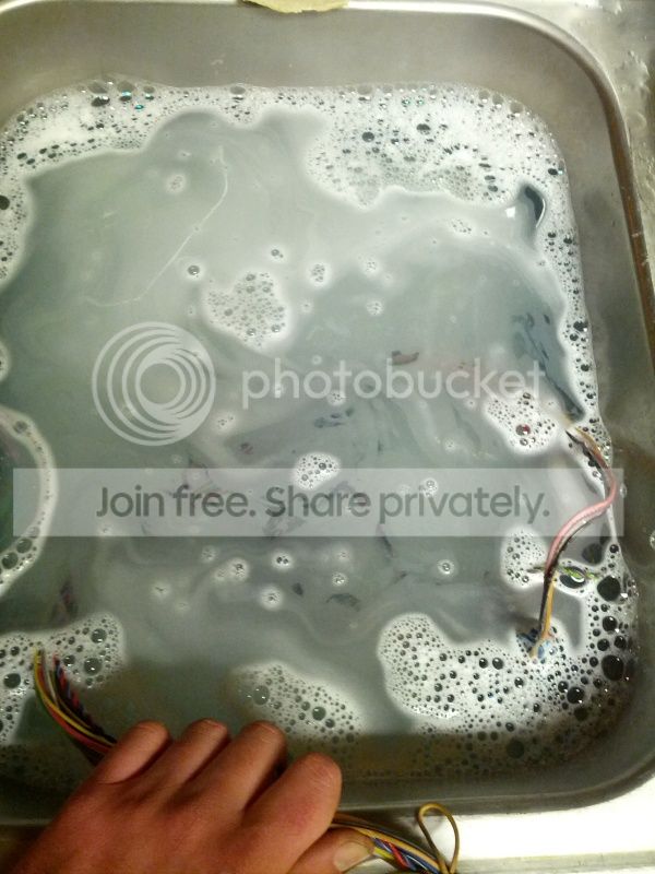

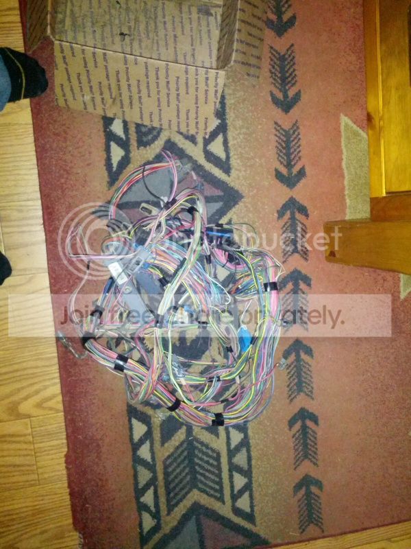

Tonight mission, delooming and taking apart the ls engine harness.
One fresh deloomed and taped harness with a clean wash....
:haha: I got the rest of the residue and dirt out...

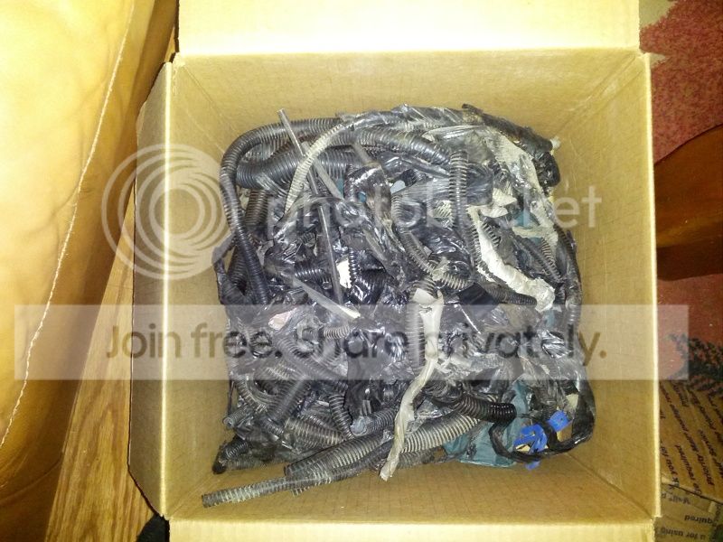

Box of loom and tape.
What a nightmare it is, it's not hard just time consuming for sure. I got to the last piece of wire I needed to take the tape off and I managed to nick the wire and cut it open.
