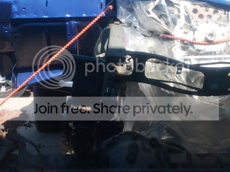

Well looks like I bent my frame trying to max the spring out.:doah:
Not sure what to do at this point but I feel like crying... :frown1:
How the eff is that even possible? Anyway, the right thing to do is either get a new frame, or take yours to a frame straightener and then box it.
I really can't see what happened, but if it were me, I would weld an 8 ft section of metal tubing on the frame, and start yanking.
Because the frames on these are flimsy as all can be and I had cross members out... I started pulling on it with a ratchet strap and it's coming around.
I think it will come back together once I start putting everything together. Once everything is done I'll put it on a frame rack.
For some reason I'm not to worried about it anymore. Should I:dunno:
Yep, these frames were bent the day after GM stamped them. Chain it down somehow, like to a tree or something, and use a come along and chain it back to where ever you want it. I mean realistically, 95% of these old square body frames are bent and drive down the road every day just fine. My Suburbans is bent in a twist. Driver side front is up an inch and a half over the pass side, and the rear the driver side is lower by 2 inches or so, last I checked anyways. Probably changed by now, its been awhile.
It looks a lot worse in the picture then what it is, eyeballing it looks just the front horn is tweaked a little. I already got it to come back some with a ratchet strap tied off to my Volkswagen.
I wouldn't worry, but that is me.
