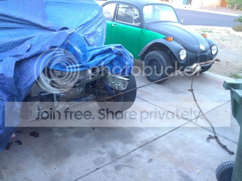

Didn't take much effort at all really, a couple pulls and it was square again. Once it's all together and driving I want to put it on a frame machine and dial it in if needed.
