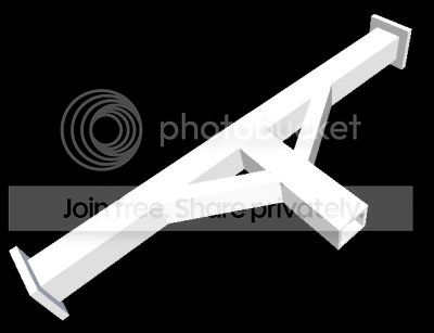

Just tossed this together, haven't done anything like this in years.
This is how I plan on building the receiver.

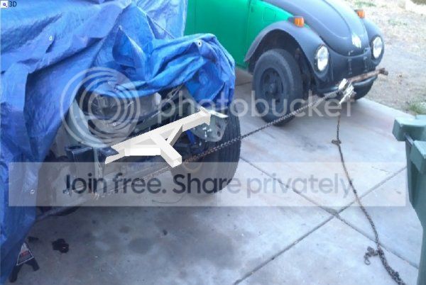

This is roughly how it will look installed.
The braces are too far forward. I only have about 4 inches from the front of the cross brace to the bumper. Just plating it top and bottom, an inch over each tube dimension would be enough.
I used the 2 in front also. Figure the winch will always pull on the hitch and never push on it. I did run into a tree with it once. Bent the base and recover tube. Did not touch the mount.
I see what you mean.
