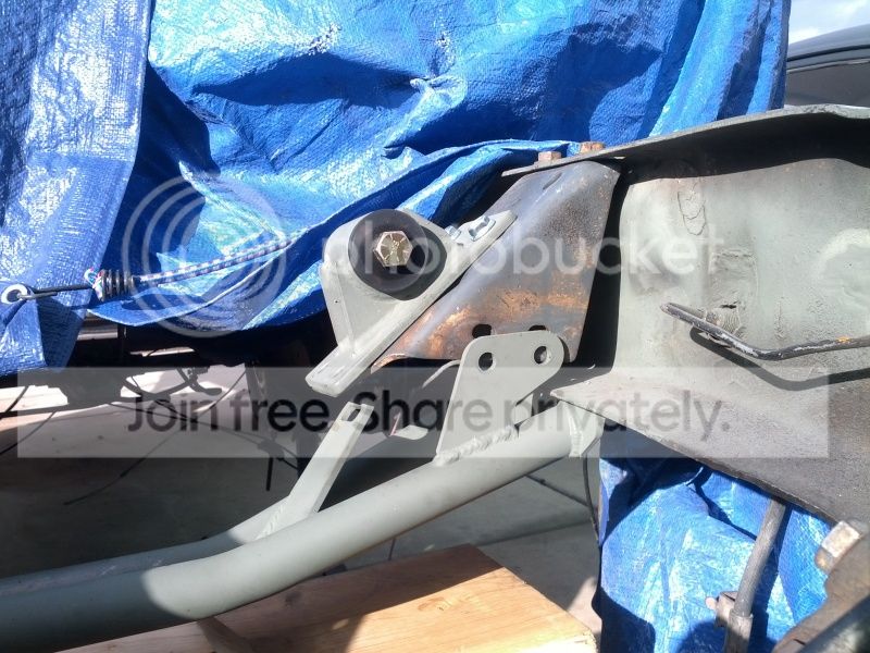

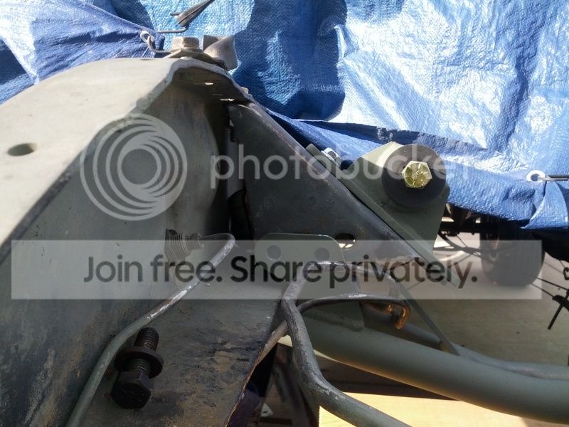

Does anyone know if the 2wd frames are taller where the engine sits? The ORD cross member doesn't sit flush against the frame and motor mount brackets.
I do have a big block cross member and small block 4wd frame mounts.
Do I need the big block frame mounts also? Or should I shim the frame mount down and run with it?
Doesn't look like you're off by much. are your frame rails squared away after tweeking them? If not maybe this will square them up with a little pressure:dunno:
Yes they are straight now, I just drilled the top bolts wrong:doah: I centered them in the frame. I'm thinking for that I will just hog out the hole.
That was one of those times when you think to yourself, "if only I had another truck of the same year to look at and compare." Been there. :D
