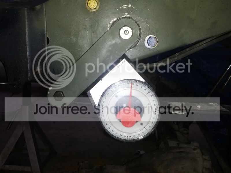

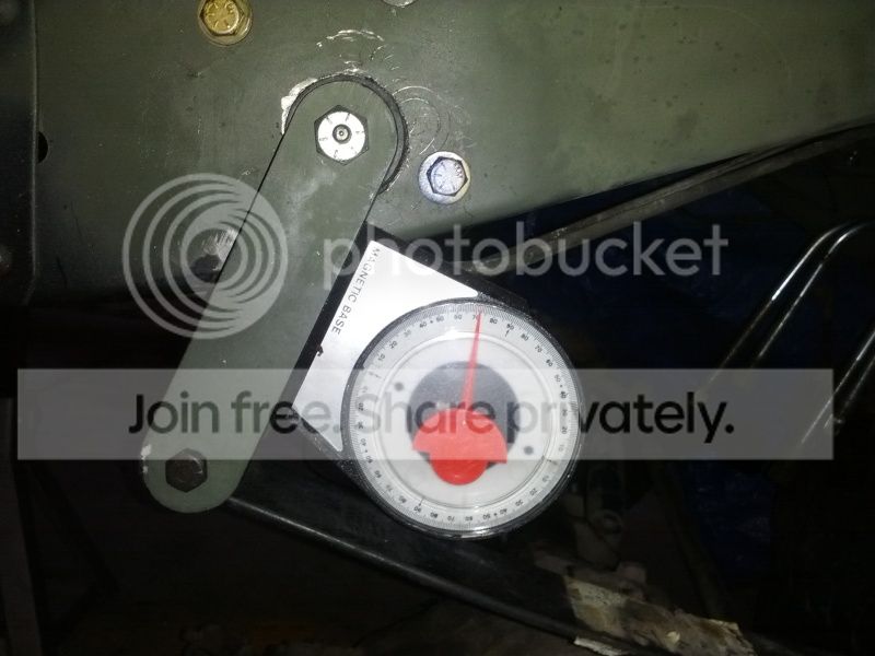

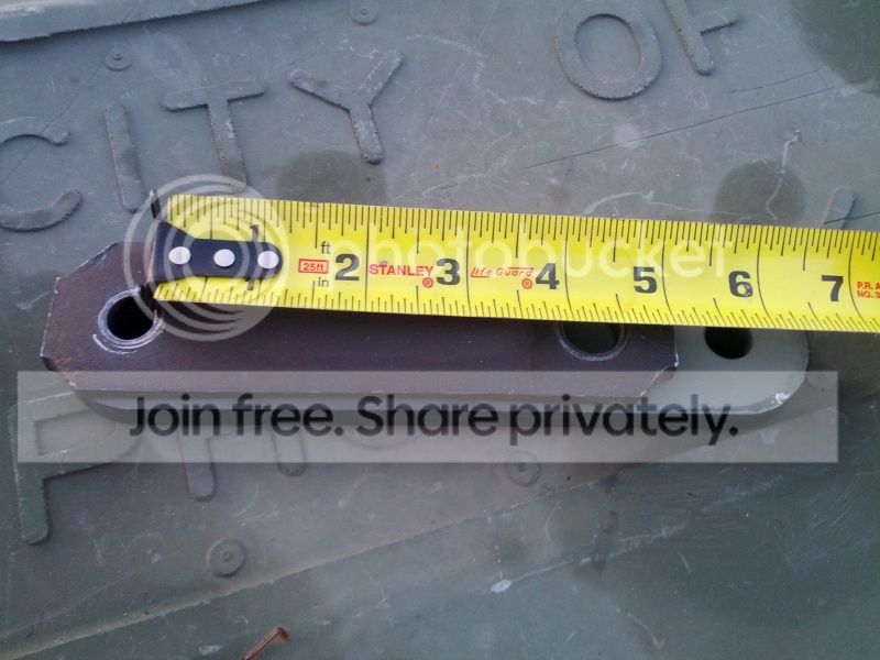

Well, I'm a fool... I found out why the shackle was hitting the frame, I was using a 4 inch shackle vs the 6 I had calculated. :haha:
The factory shackle is 4 inch and my Diy4x's are 5.5 inches. Not nearly the 6 I had calculated but will confirm.
no weight added angle 73 degrees.
Max up 47 degrees
:woot: Total up travel is 4 inches before the spring is flat and hits the frame. Do you guys think I should purchase "6" inch shackles to dial it in even more?

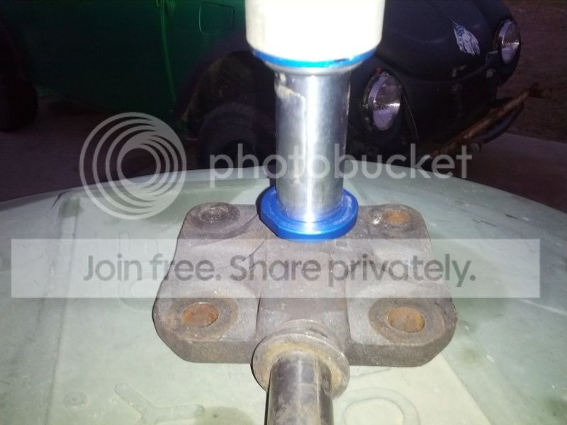

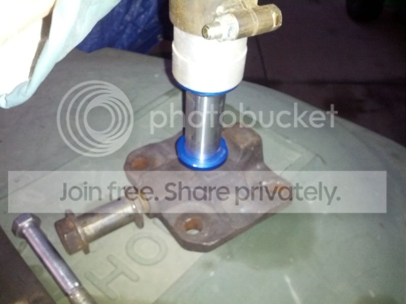

Here is what I'm thinking about the bumps having them hit the factory spring plates.
They are not completely flat but they have hardly any bevel. Do you guys think this would work? I could grind the tops flat. I'm also thinking about installing a "anti rock" off road sway bay and connecting the heims to the factory bar location.
If the springs are hitting the frame still, might be good to try a 6". I thinkt the bumps will work fine on the stock top plates.
It's just a smudge barely touching but I think I will go ahead and get them anyway, wouldn't hurt.
