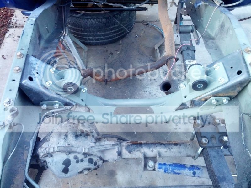

You guys think if I drop the frame plates down and weld in steel to make up the difference that will be good?
It looks like there are holes on the sides of the crossmember that bolt to the motor mount plates AND maybe one other hole at the very bottom of the motor mount plates that also bolts to a tab on the crossmember??
If so, I'd get some long bolts and loosely fit all of those lower bolts between the motor mounts and the crossmember, then see where you end up with the top of the framerail and the top of that motormount plate. Presumably, these parts were designed to work together, so MOST of the holes "should" line up.... if you are suspicious that the frame may be tweaked, deal with all the other ones first and see what it tells you once everything else is aligned and finger-tight.
-G
If I make everything singer tight it all aligns up, meaning the cross member sits flush. The problem lies with the frame plates for the motor mounts. I will have about a qtr inch gap between the mount and top frame rail.
This is the best picture I have as of right now.

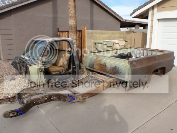

Listening to Wade is a bad idea on my part... I'm now thinking about fish plating my frame with another frame to mount shock hoops and the bump stops off of. I would cut it along the blue lines, and cut the bottom rail off.
In theory I believe this would take care of frame flex and steering box cracks and create a solid mount. I would also add a few bolts into this but I'm not sure where and if it is necessary.
Wait, you mean just doubling up the outer layer? I thought you meant to cut out that portion and weld this portion in its place....
