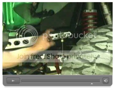

Ok, that makes sense, maybe the 17 inch arms is the way to go then. but with the link is the farthest hole it will be tilted to the rear of the truck. I thought I saw on currie's website that it was supposed to be vertical in the last hole. :dunno:
If all goes well, I should be ordering the 36 inch bar tomorrow from poly perfomance. The 10% off coupon isn't working
That picture is straight from the Currie anti rock sway bar page. You were correct Wade, it doesn't need to be on the final hole vertical.
Would it make a big difference if I put the bar behind the front tires and the arms facing the front? Seems to be more frame to grab going the other way.
I figured so, I couldn't think of any reason it would affect the final outcome.
