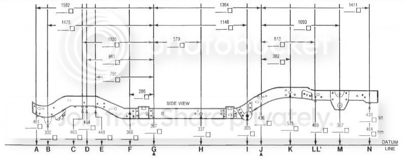

I wanted to measure the frame with this guide today, but I didn't make it out.
(see attachment also for key)

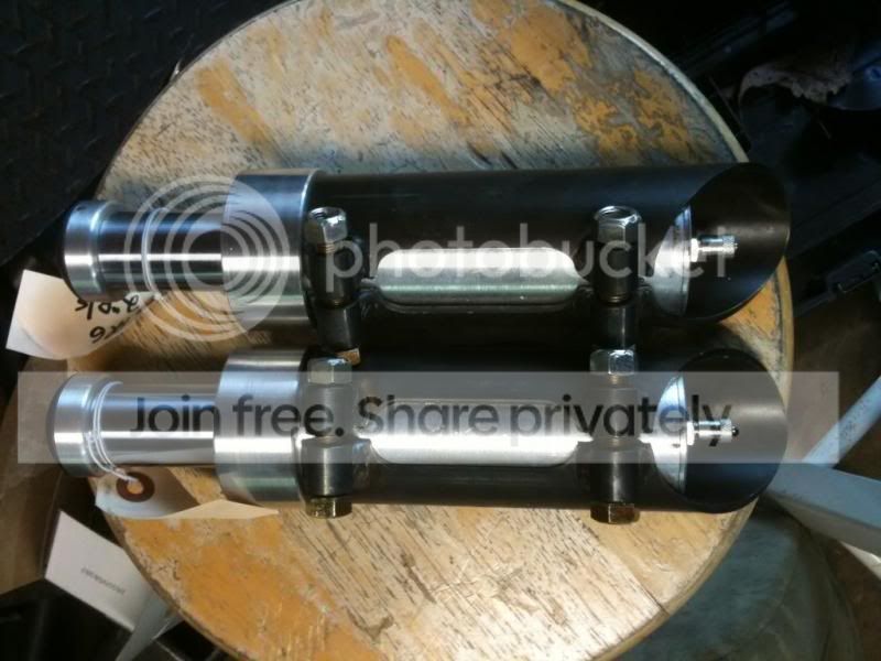

The reason I can't do the bumps later is they need to sit in the cans like this.
I might leave a half inch extra of the bump body for fine tuning if that is ok. What do you think Wade?
LOTS of this fabrication stuff involves assemble, disassemble, re-assemble, disassemble, and over and over until it works... do your bumps LAST!
The bumps have to sit all of the way into the can. No adjusting later, unless you can find a shim ring of some kind.
You need to know the full stuff limit for setting up the shocks, then once those are done, you should mount the bumps to limit the up travel so nothing hits or binds. And shocks don't bottom out.

Why can't you wait to install the bump cans later?
FOA bumps have 3 different adjustable heights in the can.
In order to properly set the cans up correctly I need to set them with cycling the suspension.
