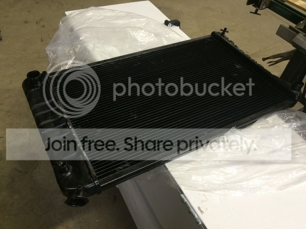

Back on track.
It's all better now. I'll have her work on getting the shroud in tomorrow. Gonna be tricky with the body lift I'm thinking...
I sure hope its a 2 piece. Then at least I could make a spacer of some sort if need be...
Its at her house, it never had one on it before.
If she wasn't broke id have her buy an electric fan and wouldn't even bother.
Most gm ones are two piece. ( that I have seen) some run a staple or metal clip to hold them together. Pull the clips, and space it out. I found some 1/2" aluminum tube at ace hardware I used to cut spacers. Then I added some aluminum sheetmetal to fill the gap. Wasn't the best, or the worst. But it worked.
Yup, that's what I had in mind, then maybe a way to enclose the fan more on the back, close up the now "obround" opening.
Without making it too ghettolicious....
I wouldn't go crazy, you will have improved it 1000% from what she had. I think it's time to move to the next project:popcorn:
