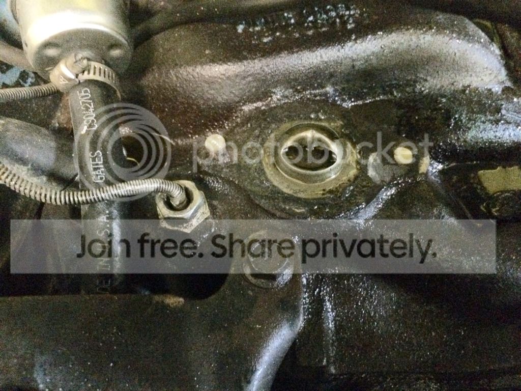

Dumb truck was dumb today.
Went to take the thermostat housing off, and as expected on any old aluminum housing on top of a cast intake.... The bolts broke.
So I spent 2 hours drilling and tapping the intake back out.

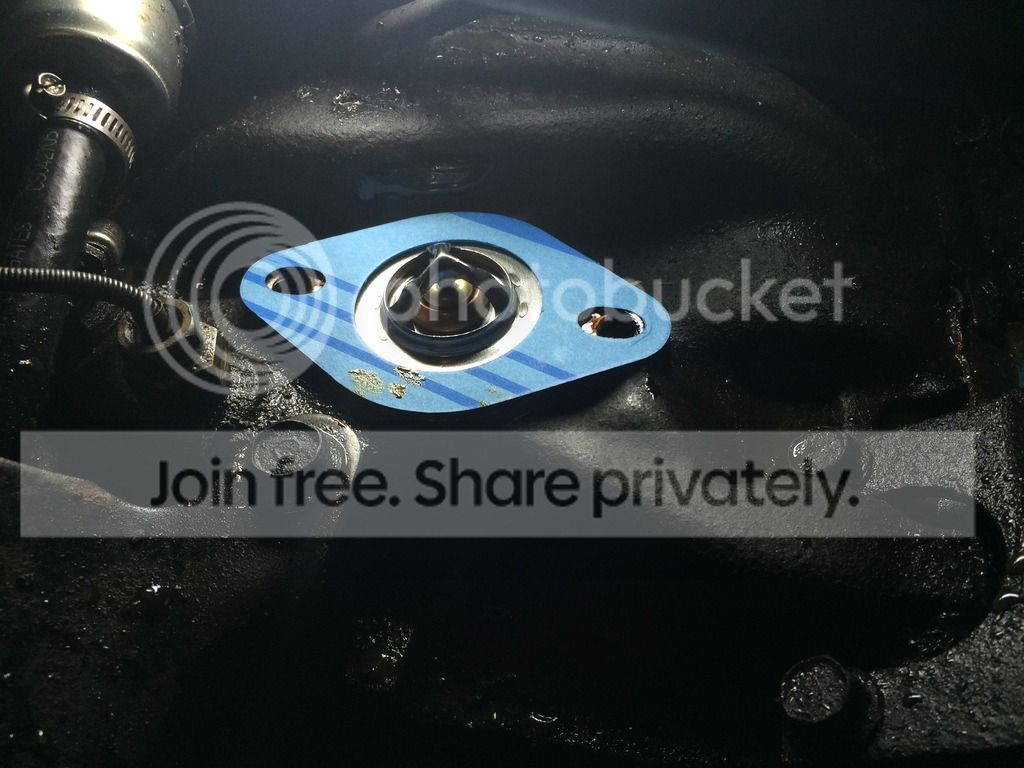

How did it turn out with the new T-stat installed?
Next time, with those bolts sticking out like that, set a flat washer down, then thread a nut onto the expose broken bolt. Weld the nut to the broken bolt, and turn it out with a socket.
Martin
They would have just snapped again. The one broke flush to the casting, the other was only a few threads tall. Drilling worked great really.

Adam a lot of times that fix gets enough heat to the threads that they will come right out.
Great tip Martin
Possibly. Ive done it that way before, didn't really feel like welding next to the carb and gas lines though. Also im pretty sure they were a terrible grade bolt. I snapped them both with a short 3/8 ratchet.
Not a big deal. Its all out and tightened back down now.

Sooooooooooooooooo...how did it turn out? :popcorn:
