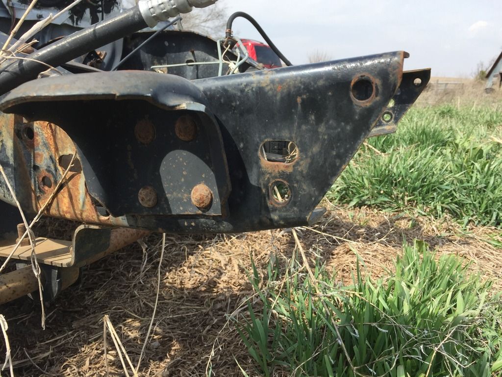

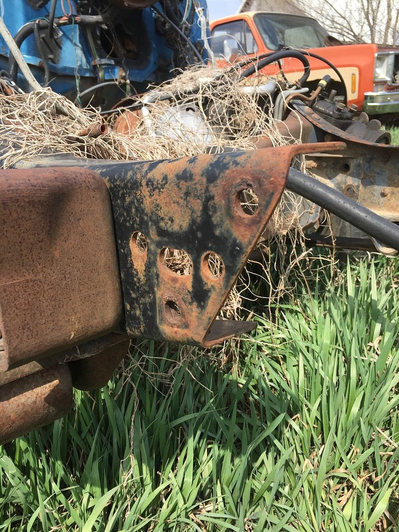

If you can't find some next time I'm around my other frame I will get em fir ya.
Might be a couple weeks though
Ok, I posted up in a few places. Id like to get that fixed sooner than later. She's been driving it a lot lately, and Id like her to at least have a bumper that functions....
