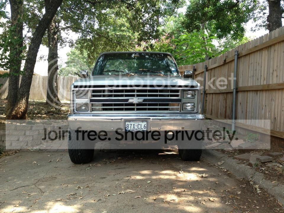

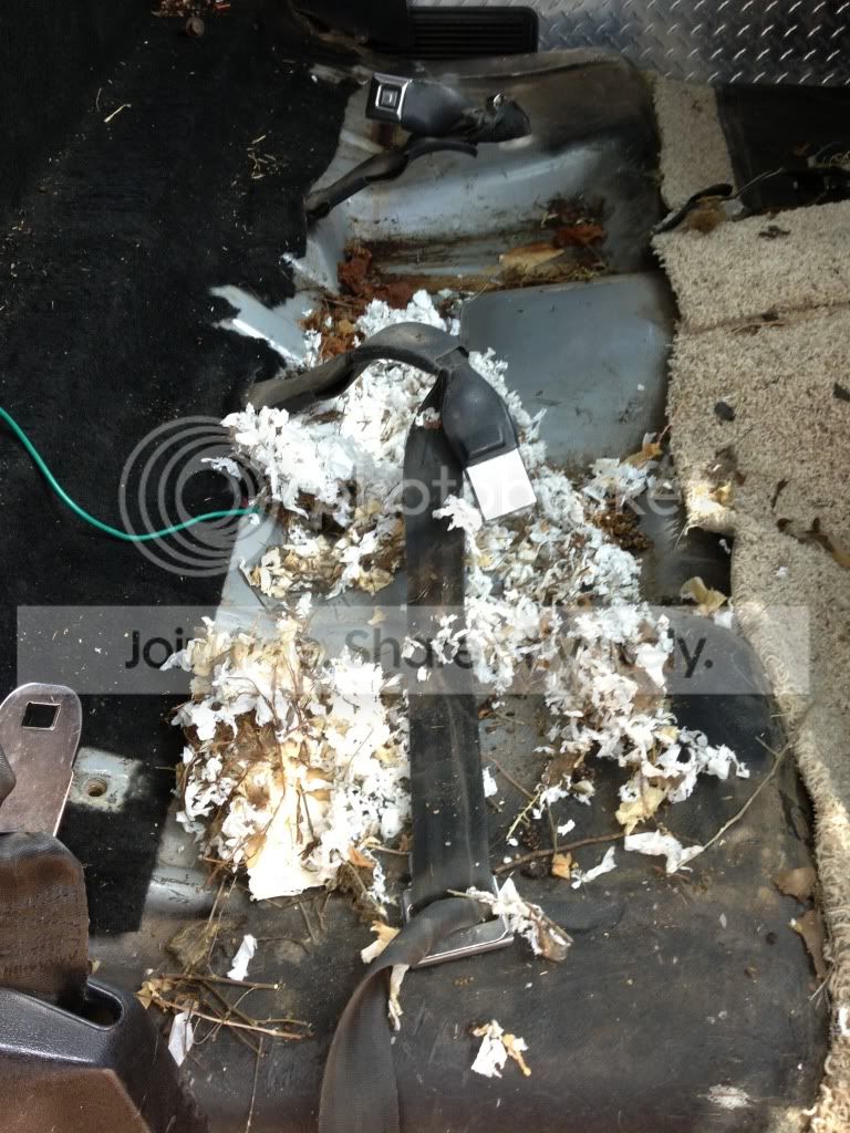

Had some time to start cleaning up the truck since it has sat in a field for the last couple of years... To include a rat's nest that was under the seat... Yeah... Lots of poo. Good news is that NO electrical were chewed up.
Pass tank/switch problem, but seems to have gotten past that.
Didn't start right away, but after a new battery and plumbing in an electric fuel pump, I drove it from Van, Texas back to Arlington. Brakes are in Bad shape. I think I have a caliper sticking.

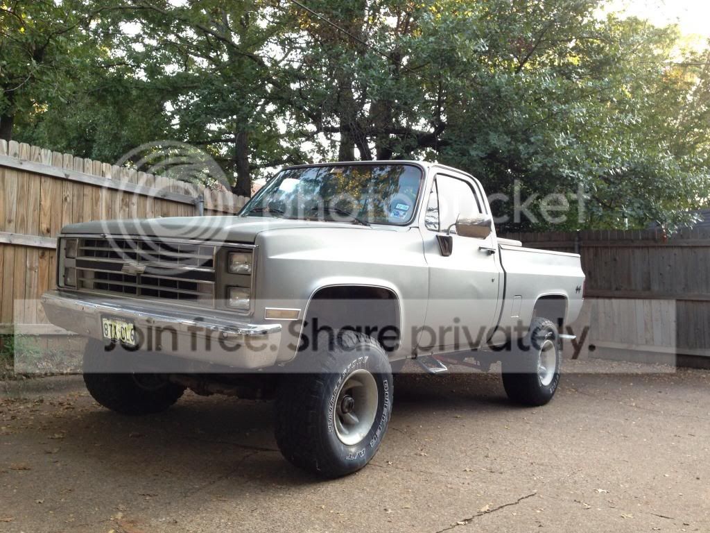

The little bit of rust that it does have came from living in MN for two years. The salted roads did a number on my rear fenders. The under carriage has quite a bit of surface rust too.
This was a California truck, so it had no rust until I drove it in MN.
East Texas has quite a bit of rain, but no seriously harsh weather. So, I'm lucky that it even started at all... I'll take that luck!!!

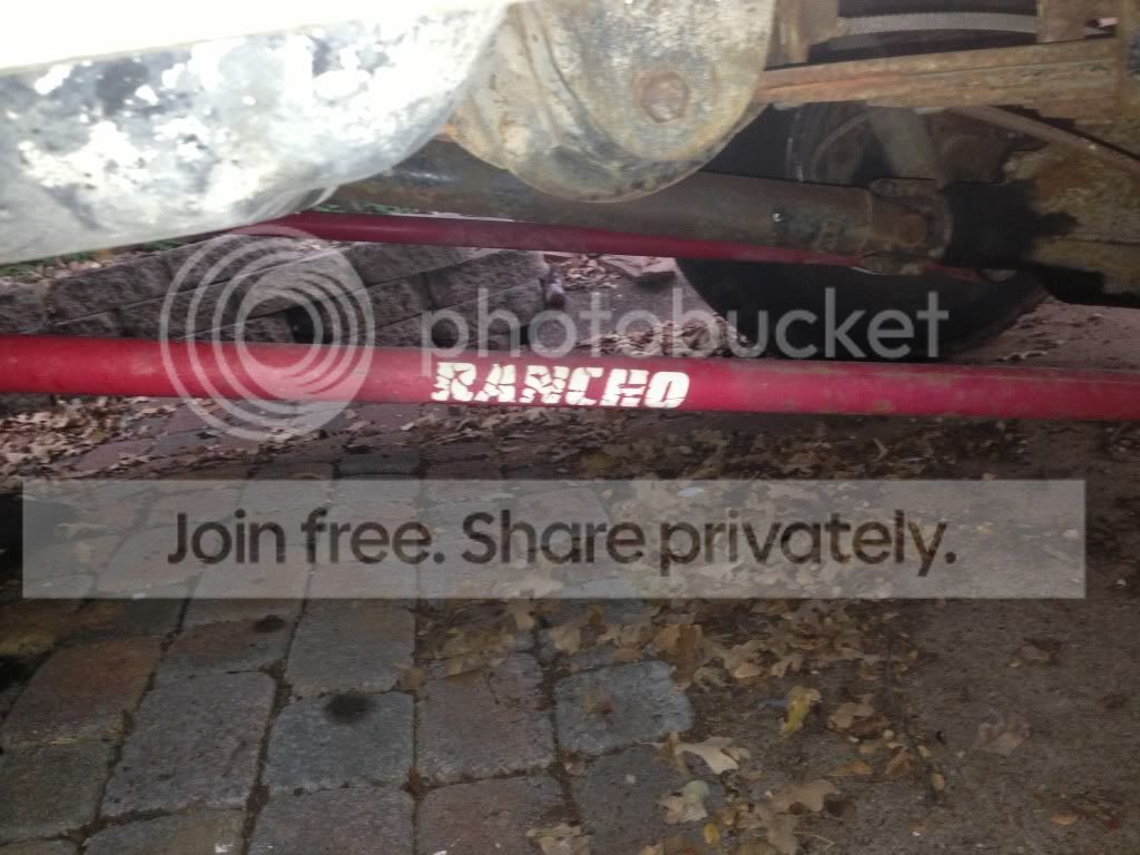

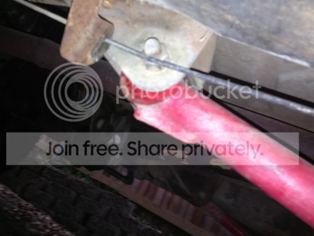

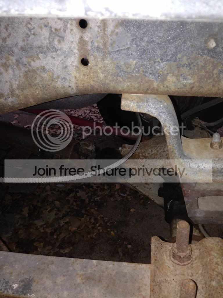

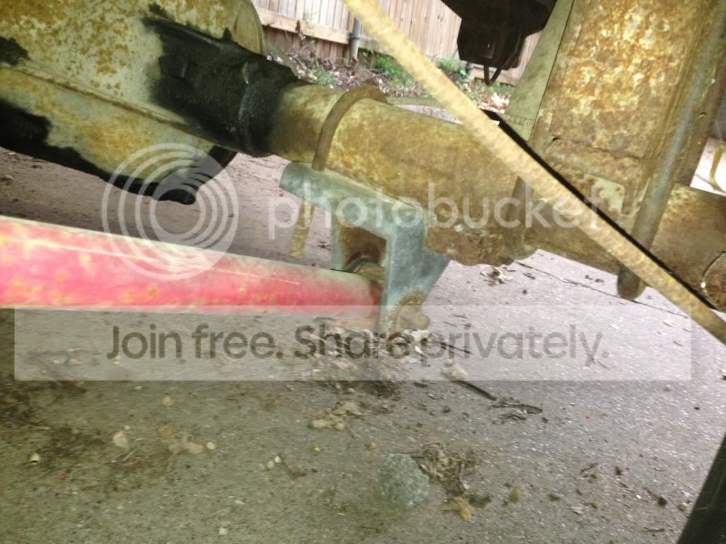

About ten years ago, I added these Rancho traction bars. I had really bad leaf wrap... Now the Bushings have all wasted away. I think that I can still get them. I did find them one time... but I desperately need to replace them.
