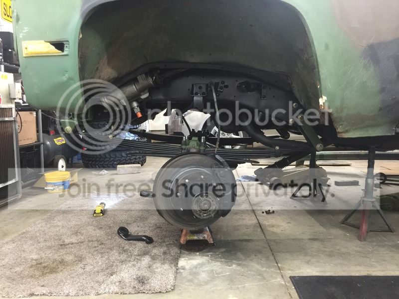

That's about how much arch a stock 1/2 ton rear spring has. It's going to have a bunch of travel either way. You can definitely tell that it's going to sit a lot higher just by that picture.

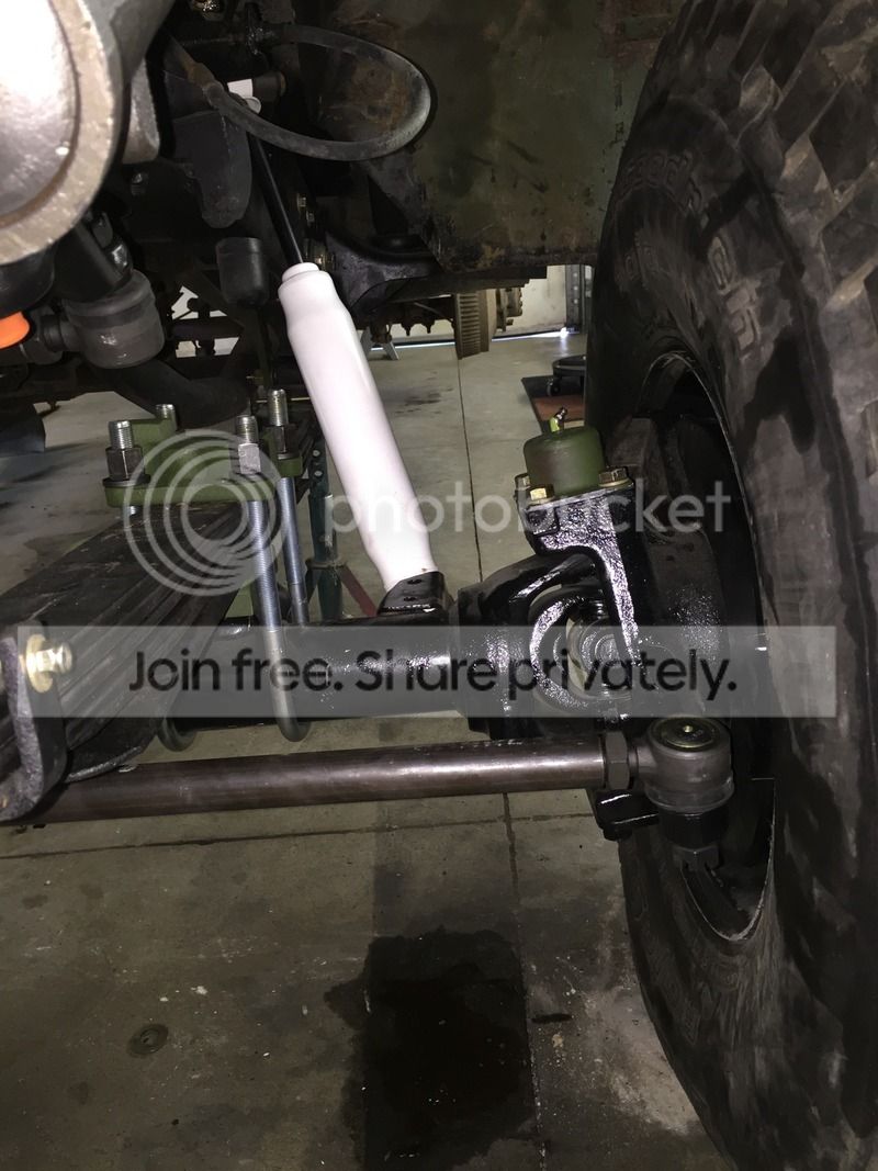

shock bodies hitting the axle? Just wondering why they're upside down.

I had just thrown that one shock on. No the body is not hitting the frame. Honestly wasn't sure which way would work better, I'll probably flip them
Those shocks supposedly won't dampen correctly upside down. Some other designs (monotube) work either way such as Bilsteins, Fox etc.

They are stock rear springs from a 80s Chevy K10. Supposedly they should give me about 4 inches of lift. With the zero rate I am expecting about five
I've never seen a truck in person with the 52" springs. My question is are these springs shot? It seems as if they have zero arch left in them. The weight of the truck is on the axle through the jack stands.
Your springs look right for a 52 front swap. Don't worry about that. It looks sick dude. Nice and clean work. Keep it up

52 spring swap in the front will give you right around 4" of lift. If you throw zero rates on the front, or start messing with shackle length it can start effecting your overall lift hight, but if you do it like he has done here (minus the zero rates), you will get 4" of lift
You are correct sir, flip them the other way or else they will not dampen correctly
I'll flip the shocks they're not mounted, literally threw that one on just to take a picture LOL
Ok perfect how many leaves do yours have? I know there's several options.
I ran all 5+the overload. It's a heavy truck I we will see how it does. I can always take one out
Where did you position the zero rate?
They are centered, just using them for the extra inch. The axle already seems plenty far forwards. If any thing I may use it to move the axle back

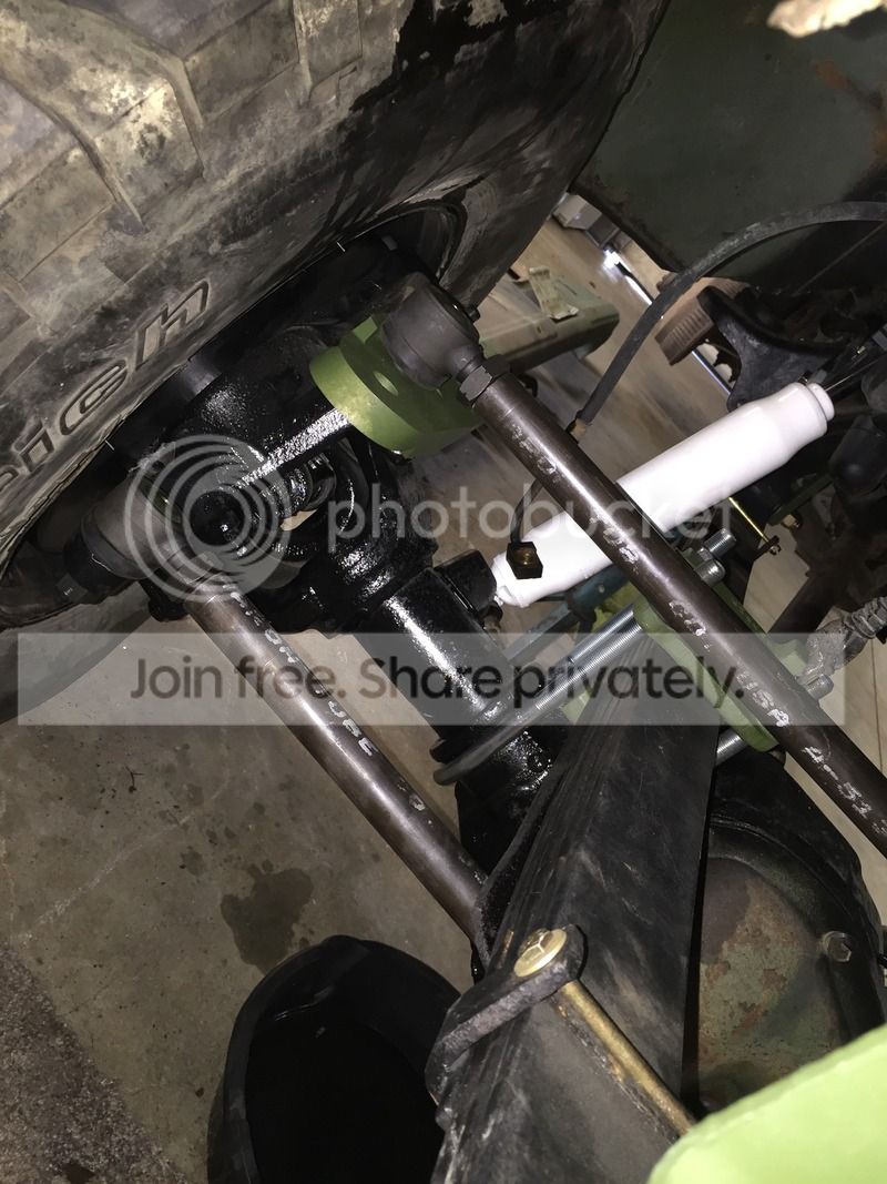

No pics tonight but I got the kingpins rebuilt and the steering arm installed.
Also flipped the shocks over and put both front shocks on

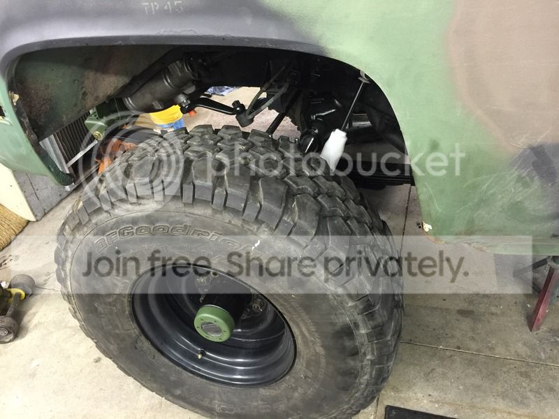

I have tomorrow off work. The front will be on its wheels and I'll get plenty of pics
