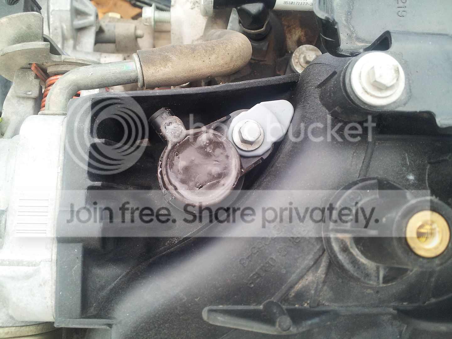

And this is how I capped off my purge valve, JB Weld on the bottom half.
