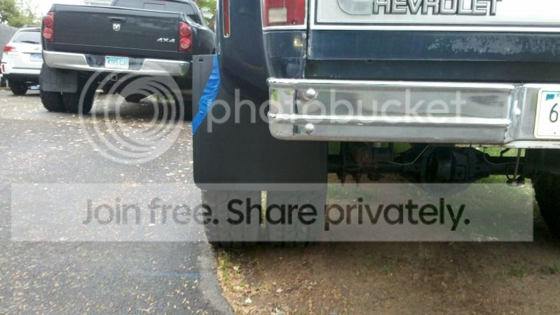

How big are the spacers in the rears again?
Can you post up pics of the rear tires from behind to show the gap?

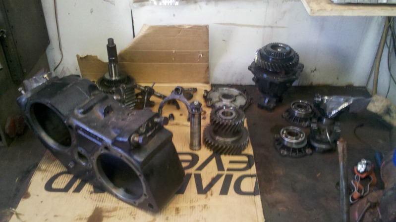

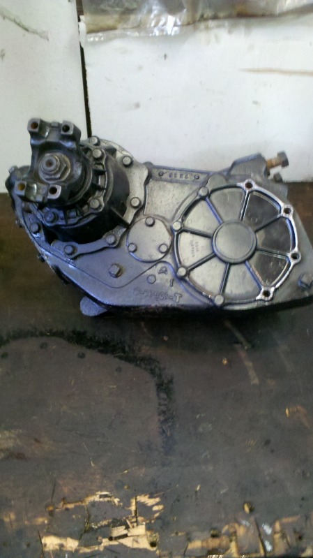

The transfer case got rebuilt, this was the biggest thing I have done, it has made a HUGE difference, no longer is the drivetrain louder than the exhaust. I have also added mudflaps.

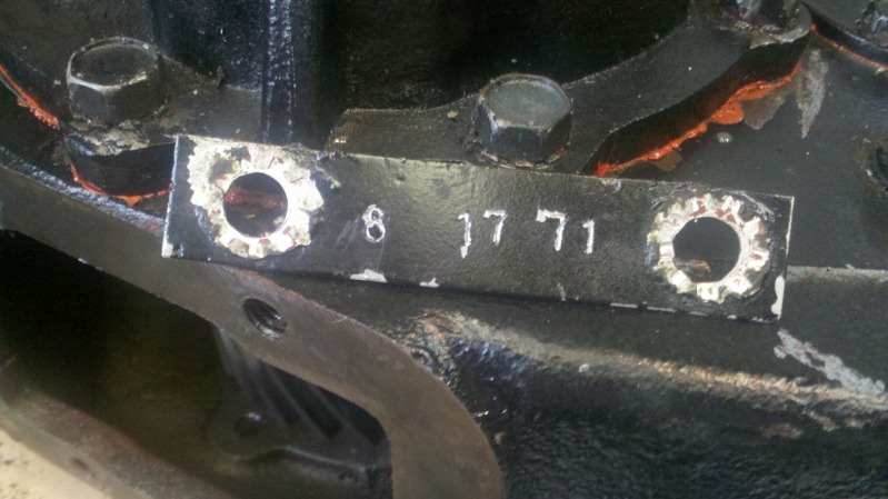

Rebuilt the tcase.. this was a fun time.

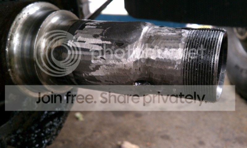

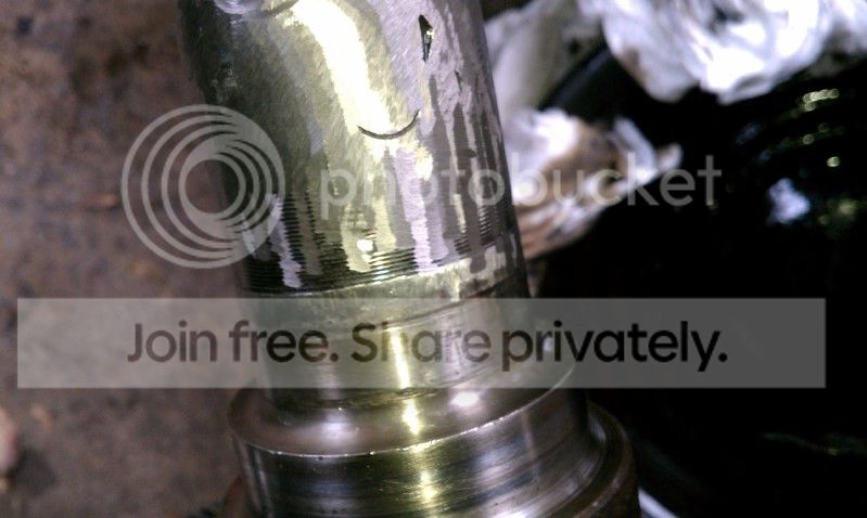

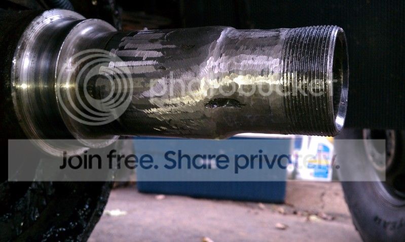

well i seem to have come across an issue... my rear seal was leaking in the driver side. I pop off the hub and this is what i find....
:eek1::eek1::eek1::eek1::eek1::eek1::eek1:
So.. in my discussions with friends.. i have determined I would like to replace this axle.. what you say ck5? i dont think i can trust this on my truck.. i have not towed with it yet.. just makes me nervous!
yes! and my bearings were fine just a bad hub seal. When I re did the truck last year i never touched the rear brakes.. they were working great so no biggie.. but damn!

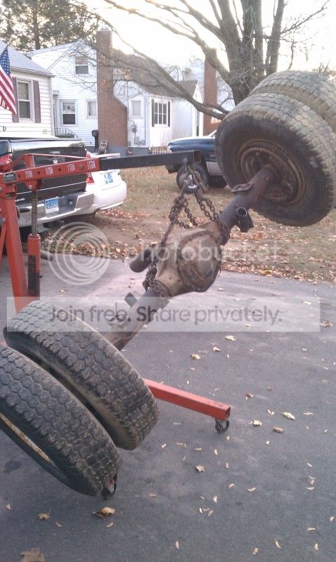

well it took 1hour to cut out of the junk truck and 3.5hours to load it into my truck... just normal floor jack and some spare tires/blocks.. man that sucked! Anyways.. here is my replacement axle, time to get the wire wheel out again and clean it up, toss the brakes on it and in my truck. Biggest challenge is the lug nuts are so rusted i cant get half off.. hence the tires still on there! My impact doesnt wanna take a half of them off.. oh the joys of winter builds.
