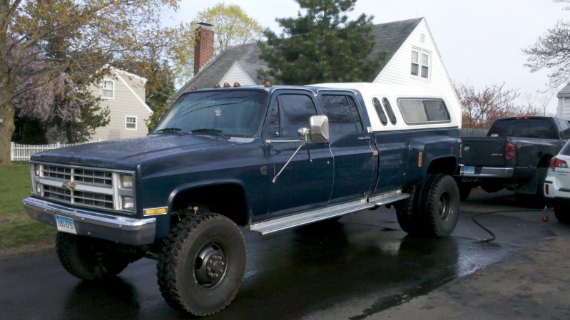

Well,, i've been driving it a ton, i still need to rebuild the tcase though... noisy as hell. anyways i need a good area to stay dry in rain for camping and my mt. bike races. So i picked up this cap from my friend,, not exactly super excited how it looks but the functionality of it will be great and i can always take it off quickly.
