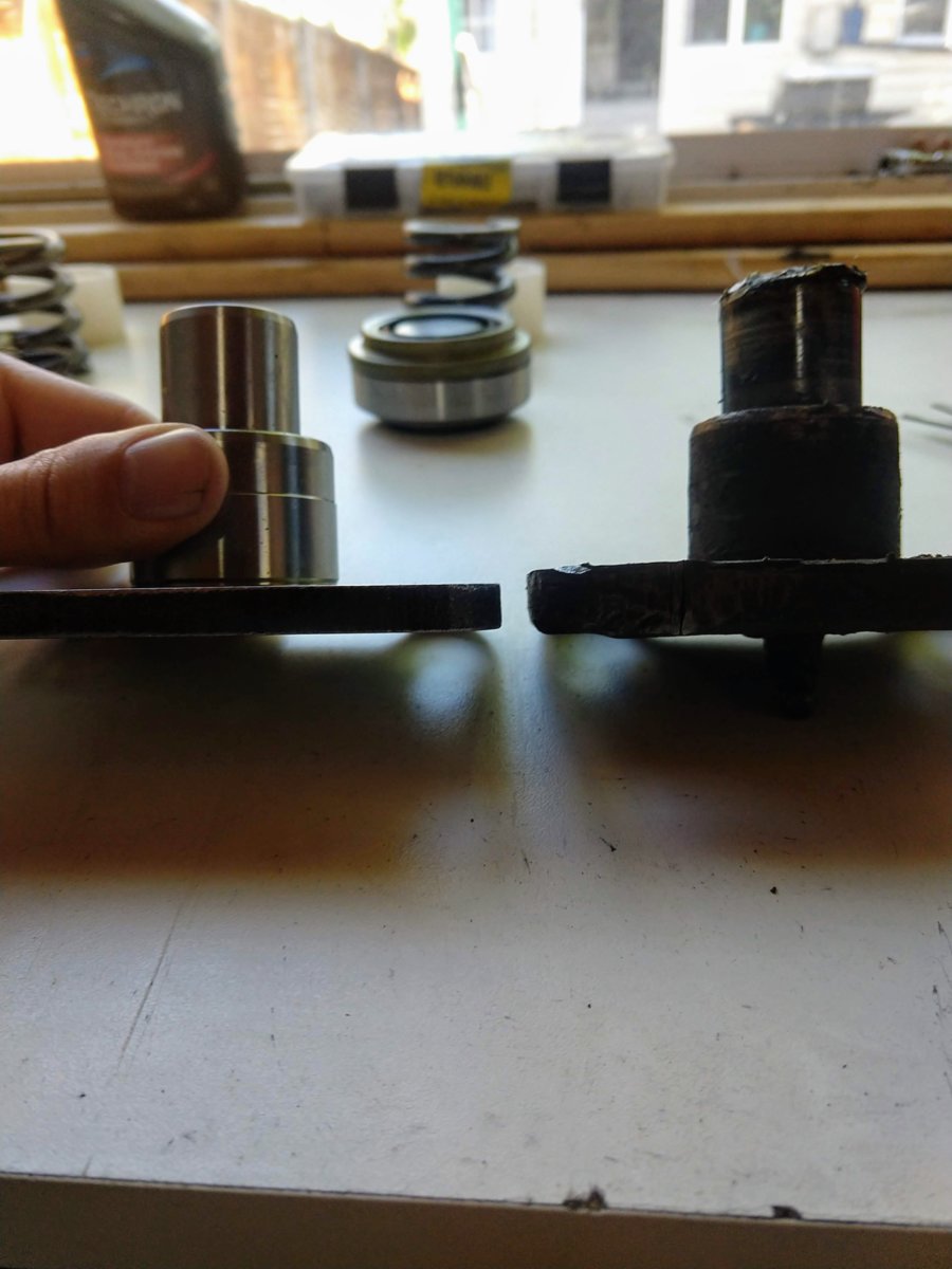

I was comparing parts earlier today and noticed that my new lower kingpin that I bought off eBay is a lot slimmer than the one that came off:
I think I remember reading about this on the Dana 60 Bible, just wondering now whether I need to return this or get an adapter or something. Perhaps I can just get some extra washers so the factory bolts bottom out at the right spot.
EDIT: Nevermind, it doesn't seem to matter if a little bit of lower kingpin bolt pokes out of the knuckle. I should be good to go.
